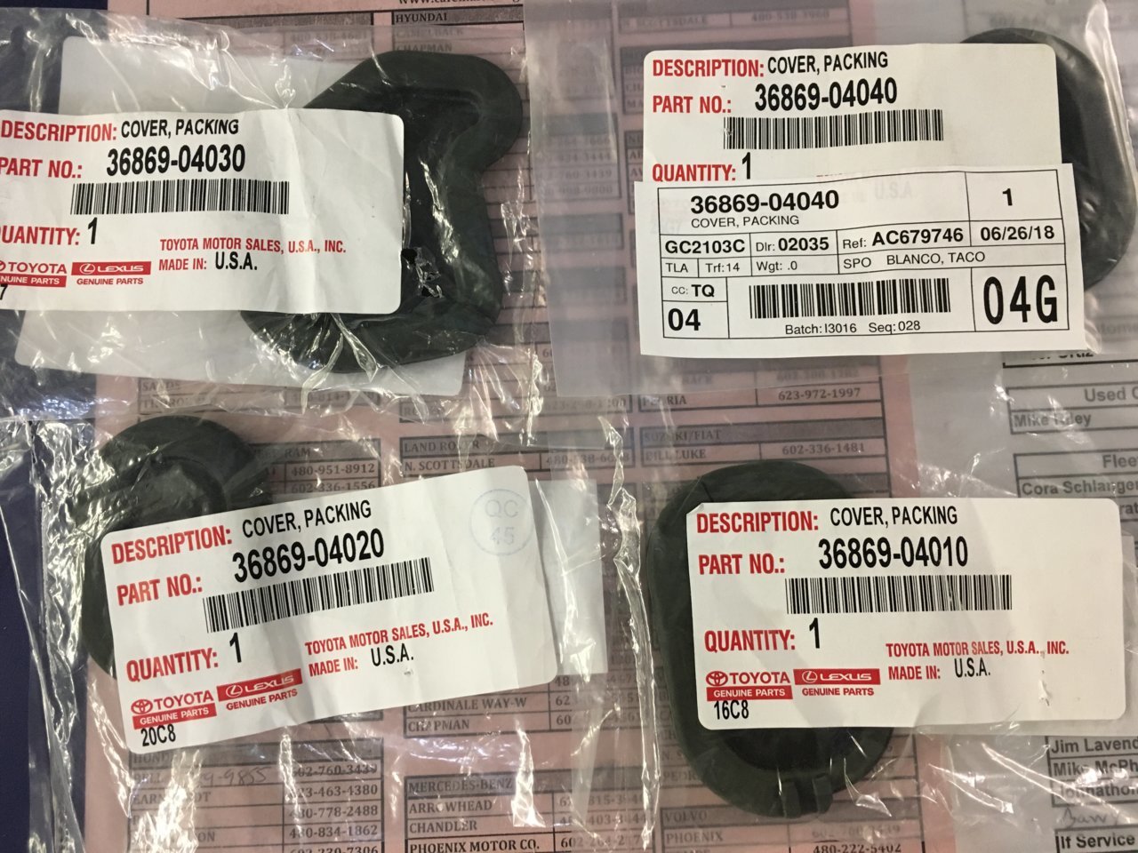

    Here's an interesting TSB.
    Looks like they're adding the condenser fan for Mexico spec trucks and then operating it based on refrigerant pressures.
    They also add quite a bit of sealing to the core support as well to help prevent hot air from sneaking around.
    Seals:
    #2 36869-04010 COVER, P $8.25
    #3 36869-04030 COVER, P $8.25
    #4 36869-04040 COVER, P $7.61
    #1 36869-04020 COVER, P $6.87
    #6 53285-04010 SEAL, RA $6.03
    #5 53286-04010 SEAL, RA $7.64
    #7 53398-04010 SEAL, RA $47.87
    #8 36867-04040 SEAL, PA $10.89
    Pressure switch stuff:
    88645-04070 Pressure switch
    90301-A0010 Pressure switch O-ring
    90980-10943 Connector Housing
    82998-12440 Wires (You'll need two)

    parts ordered and received.
    These are 1 thru 4 in the diagram. They were pretty cheap. So, I'm starting with these first.
    When CSF get's their shizzle together on their radiator upgrade; I'll do the other seals 5,6, and 7 along with.
    I'll be adding a condenser fan as well. But, I need to look into something that'll work along with the supercharger heat exchanger.
