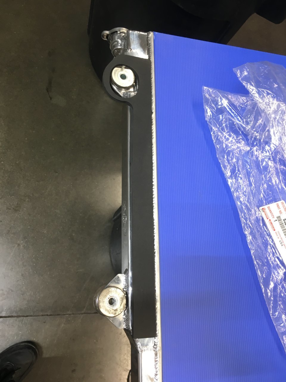

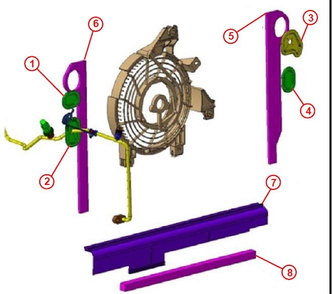

    Yeah they only released the side pieces and the 04020. Sent the email to PRA and got a response saying that nothing will be released due to the fact the parts are for Mexico spec trucks performing the entire TSB only.

    My order got hung up for a bit until I called in, next day they called me back canceling the order :( I wonder if we can find similar aftermarket parts

    Aren't you just able to order these parts online? Example, the Dallas Texas Toyota Part Online store sells them. I checked some of the part numbers and they come up and are for sale. I didn't place any order, but worth a shot for someone to try.
    I think it would be more worthwhile to add a fan for the condenser to improve the performance parked, traffic, or off-road.

    I did find a website that I'm going to give a try, however the two driver side "plug" seals are discontinued

    I have been able to track down all of the TSB "covers" to plug the holes, with the exception of "#4, 36869-04040, COVER, P".
    I have spoken with multiple dealerships/ parts suppliers and they say Toyota is not selling these to anyone who has not officially had the TSB done.
    Anyone have a connection/hook up/ suggestion to track down this cover? I imagine any dealership in Mexico would be able to supply it.

    Find a VIN for a truck produced for sale and originally sold in Mexico. Give that to your dealer and they should be able to get your part released.
