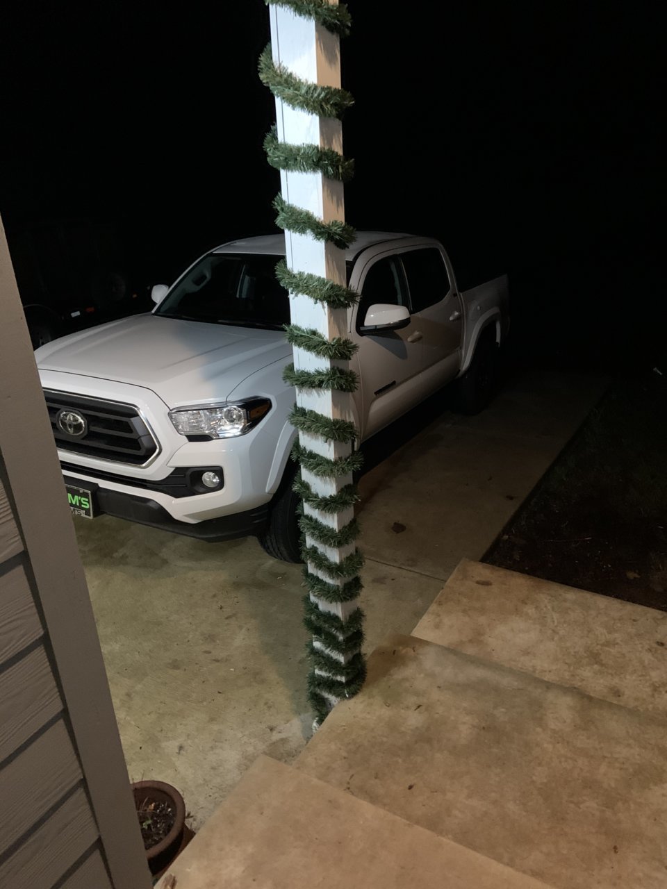

    Sorry if I don’t respond to your guys response. I’m new to the forum world and not very good with technology. But i will try my best. Here is a picture of the ol girl not the best picture but it’ll do for now.

    There is a post blocking your newborn photo.
    I understand it’s late so tomorrow we expect a more decent photo.
    I can’t get enough of seeing folks Tacomas.
