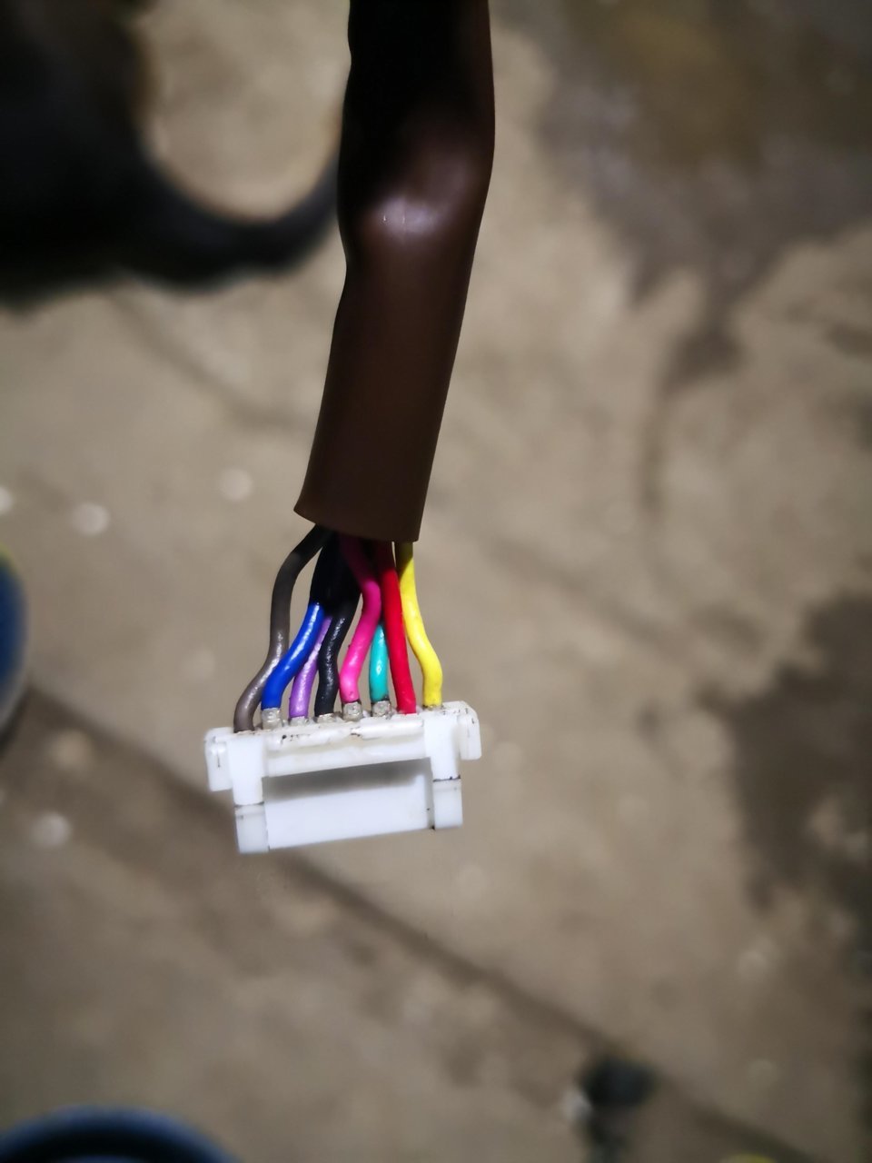

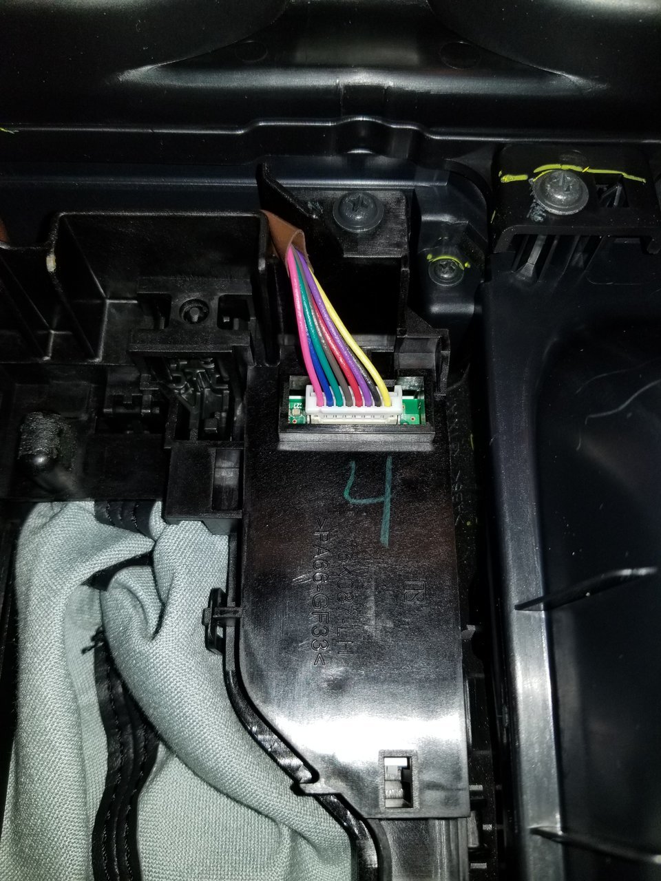

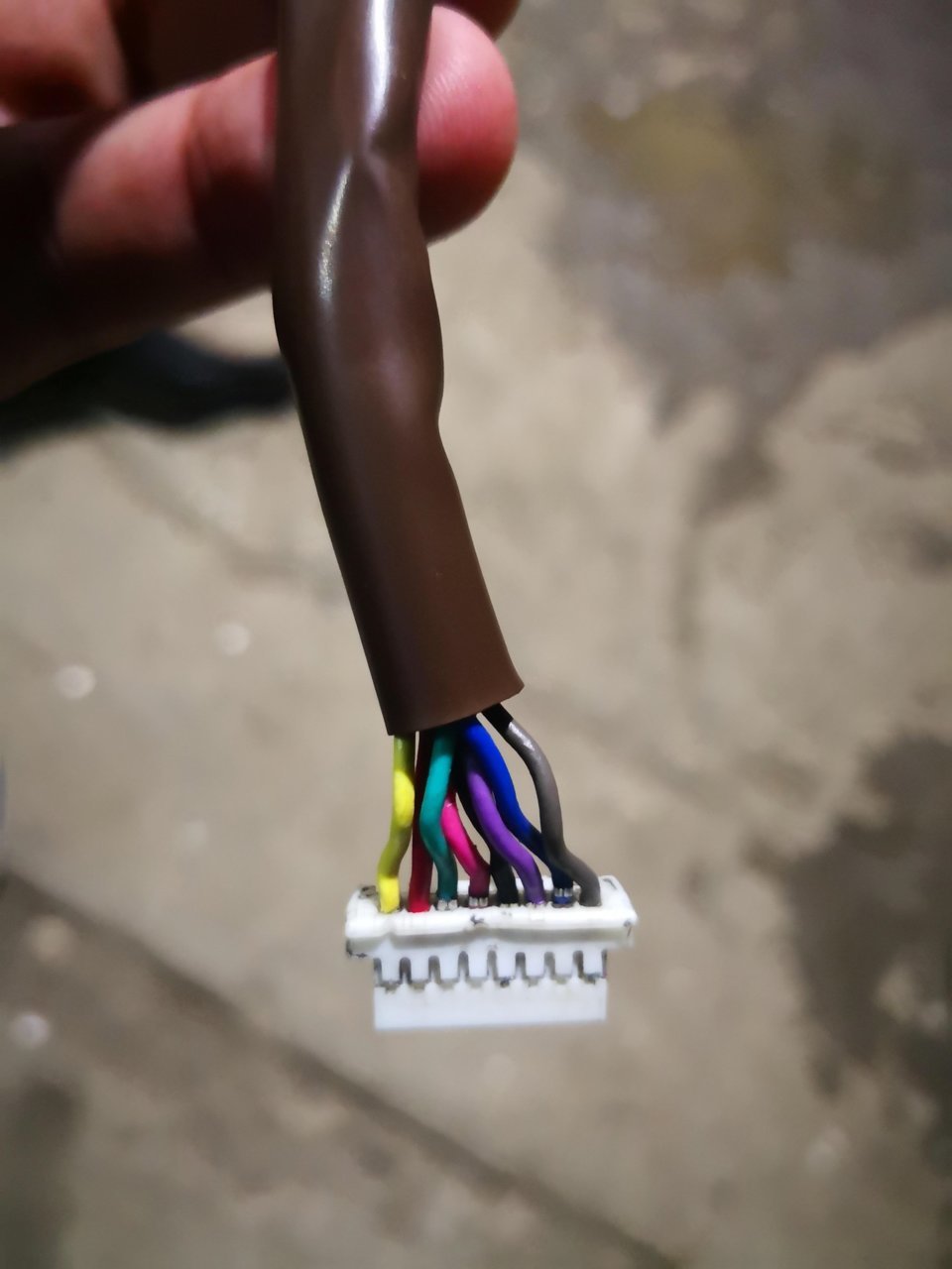

    Mechanic doing some repair work disconnected the shift indicator light wires by mistake (from the connector), and now the park /neutral/drive Indicators are not working properly. He tried to place them in different positions with no luck. By any chance does anyone has the correct order of the wires position (color coding)
    I tried to look around the site with no luck.
    Thanks in Advance.

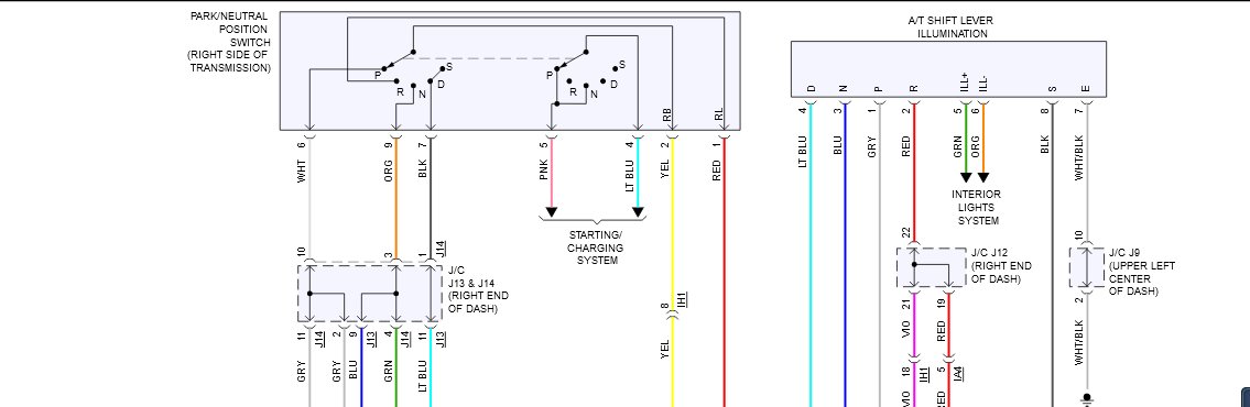

    This was all I could find. It doesn't completely match but might be a good starting point?
    Pin 1 = Grey
    Pin 2 = Red
    Pin 3 = Blue
    Pin 4 = Light Blue
    Pin 5 = Green
    Pin 6 = Orange
    Pin 7 = White/Black
    Pin 8 = Black

    Just FYI. Don't know if the order is correct BUT some of the pins aren't seated correctly. This makes a big difference.

    Quick question, I couldn´t find this diagram on the Wiring Diagram PDF´s, What is the PDF Name where it is listed? Thanks in Advance

    In my experience the PRNDL wires are in order on harness. At least that's what the instrument panel has

    I got this from my work place. Not the most accurate of wiring diagrams but it helps. I believe you can buy a 2 day pass from Toyota TIS for like $20 and get all the info you can for your specific model.

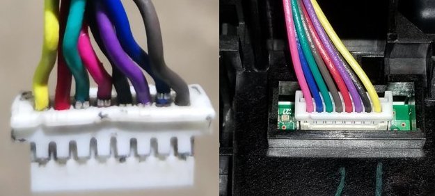

    This one looks like it.
    https://www.tacomaworld.com/threads/led-cup-holder-mod.526218/

    Hey, 2 out of 6 were in the correct spot.

    I see only one correct...GREEN :burp:

    green and purple!
