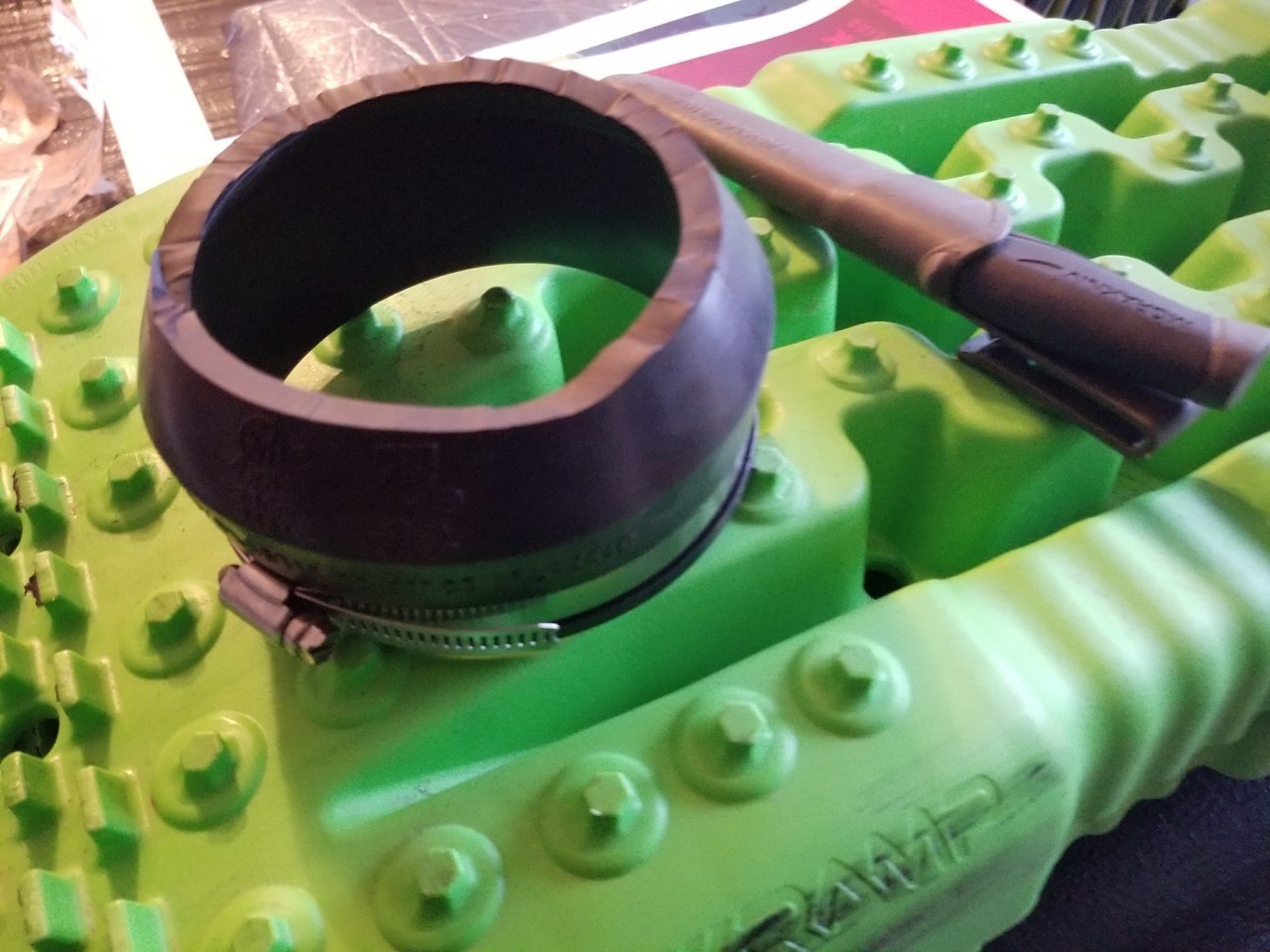

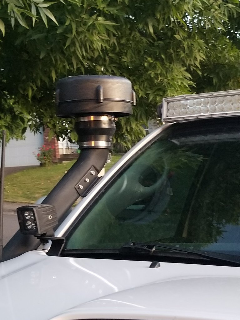

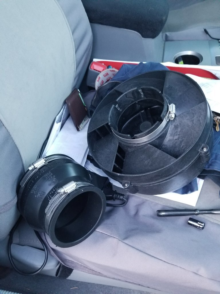

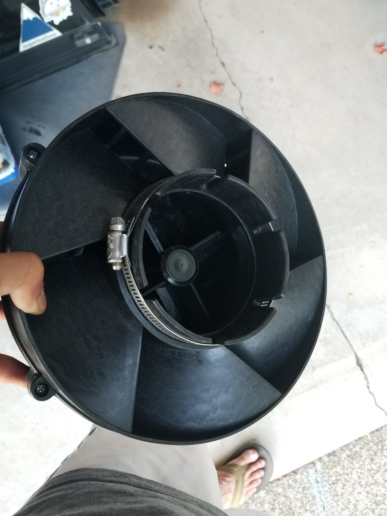

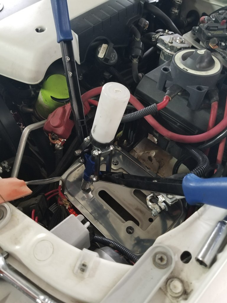

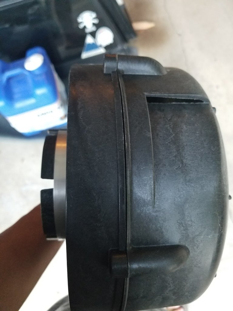

    ENGINAIRE Install
    this is a mock install, i will post final install pics in the am....
    materials:
    enginaire
    rubber 4 to 3 reducer
    Tools:
    sharp knife
    8mm socket

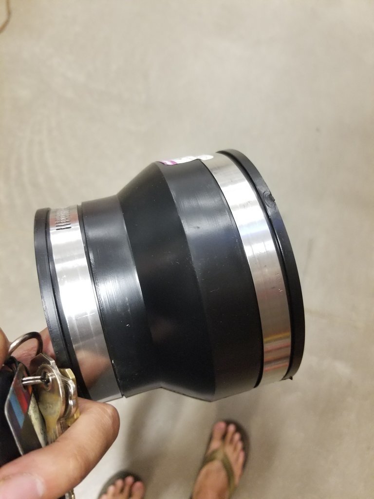

    this thing is massive, i can see why it cost so much, the fan inside is a nice design and when installing you must face the exhaust port out towards the back as that is where debris is thrown.
    i bought the reducer from home depot but i ended up trimming it to look nice, more pics to come in the am. I ran out of daylight when i was finishing everything.

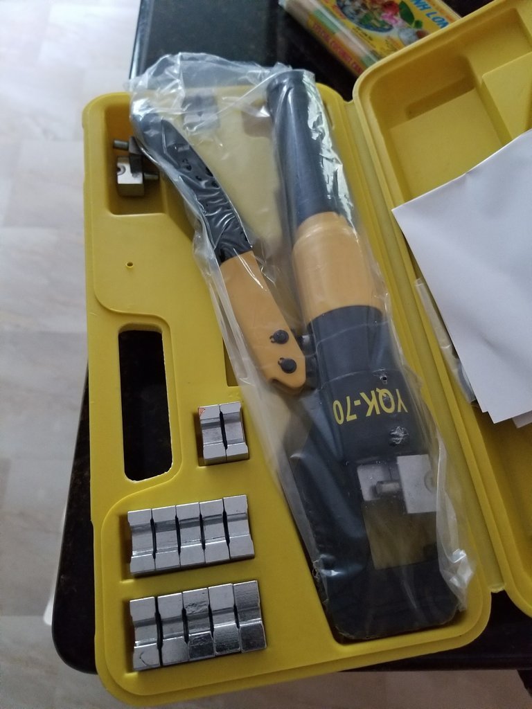

    got to test out my new hydraulic crimp
    made new terminal wires and post attachments -- old ones were pretty nasty looking

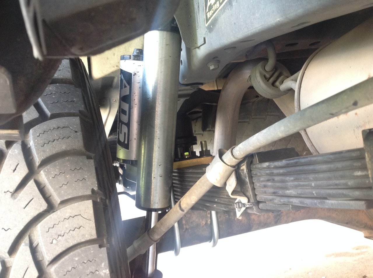

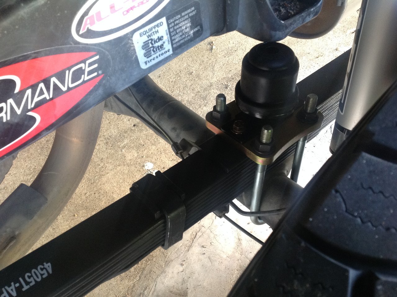

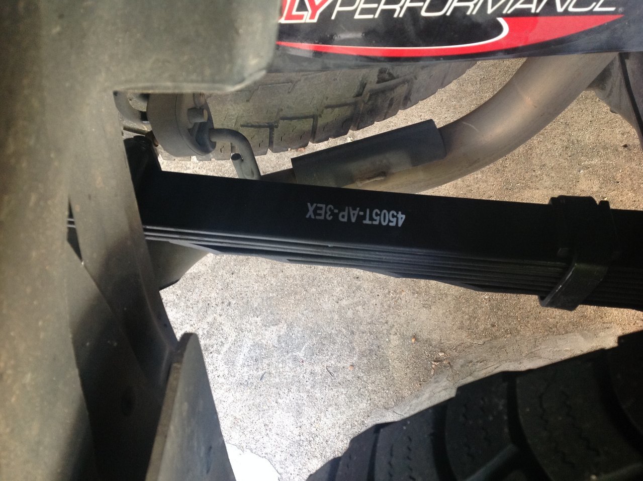

    image.jpg image.jpg image.jpg image.jpg Got my Expos and super bumps installed today. You were right, not bad at all. I deleted my 3 degree shims ( don't think it will be an issue, since I have a Tom Woods one piece DS ), and deleted my air bags. I'll keep them just in case I want to re install later. Love the stance and ride so far. Very smooth with all the weight I have. I'm pleased

    yeah im happy with them over my old setup, they flex a lot better on the trails. How do you like the Tom Wood, it has been on my list of to do's

    I love the Tom Woods, installed it and never looked back. Ordered it directly from the man himself over the phone. Their CS is top notch. Quality of the DS is top notch too. Fairly priced, and 15 min to install.

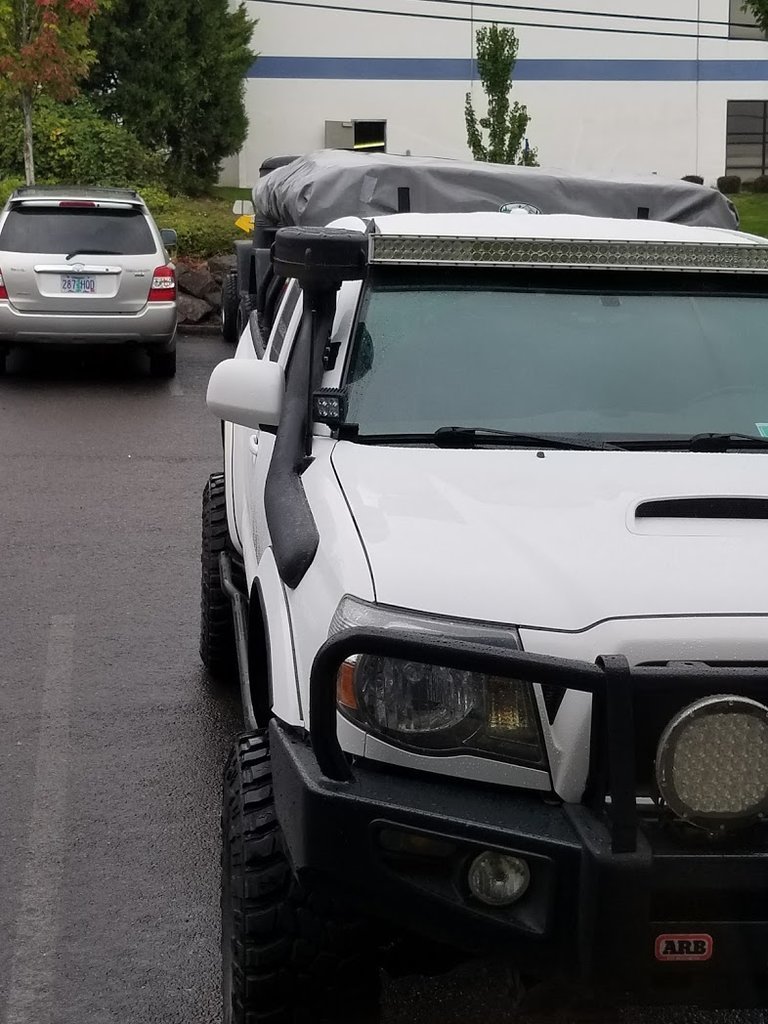

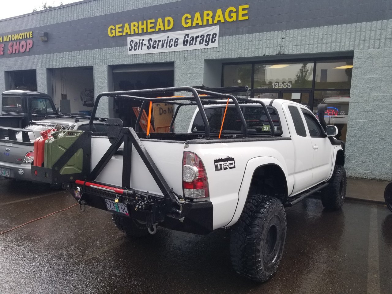

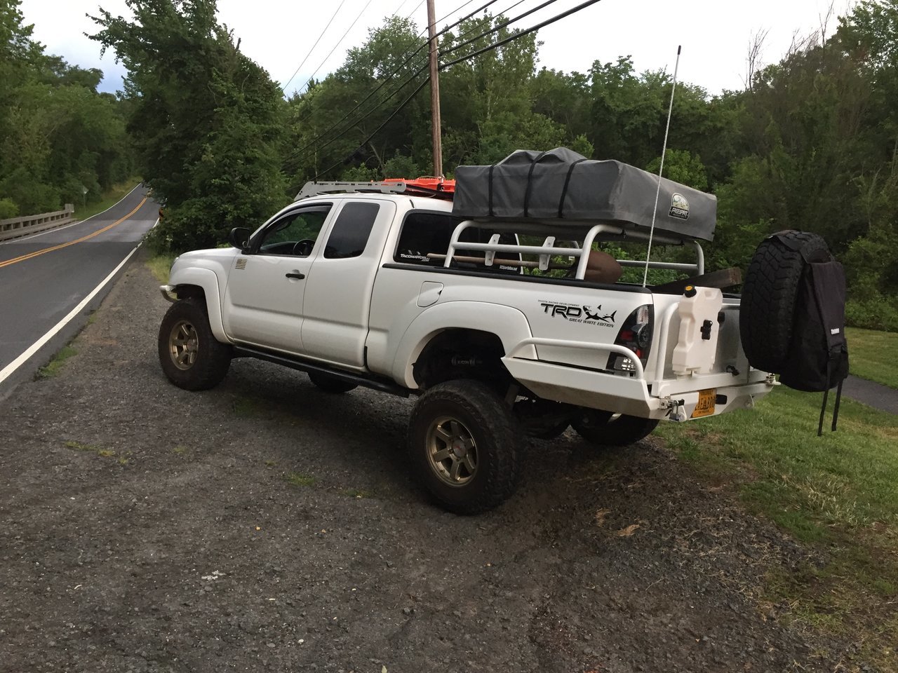

    Looks awesome! Do you know if the bed rack is from a short bed or long bed? Always wondered how a short bed rack would look!!
    Kemosabe likes this.

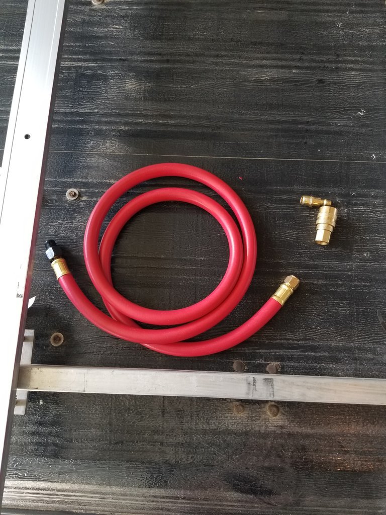

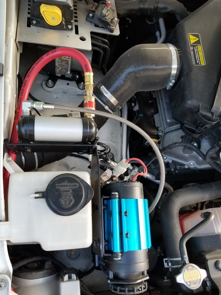

    Bought parts for an air chuck for the front bumper. Got tired of opening and closing the hood

    This is a rack for the short bed but installed on a longbed

    2010 TRD OR Access Cab
    This was my shortbed rack on a long bed

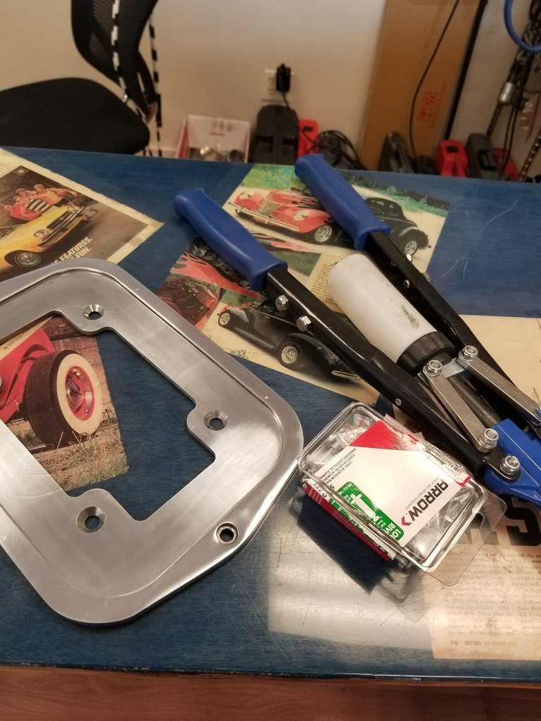

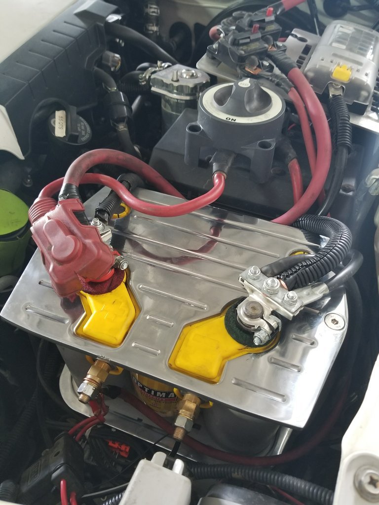

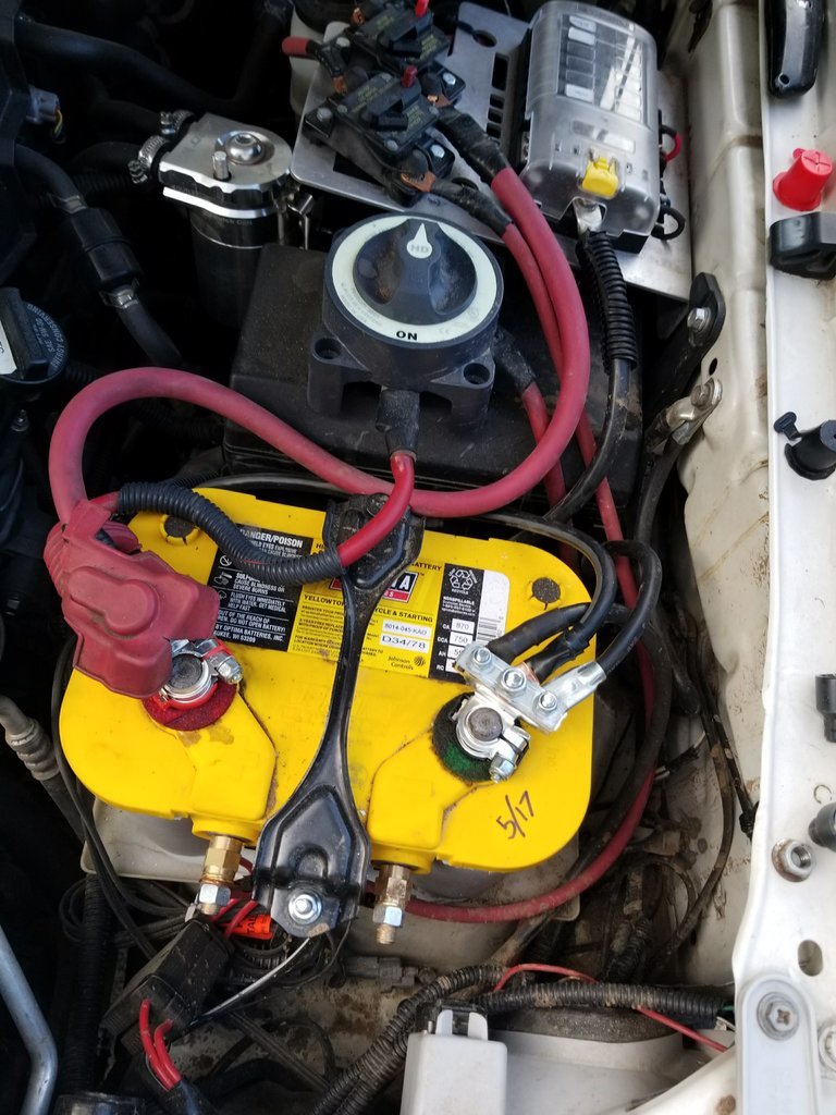

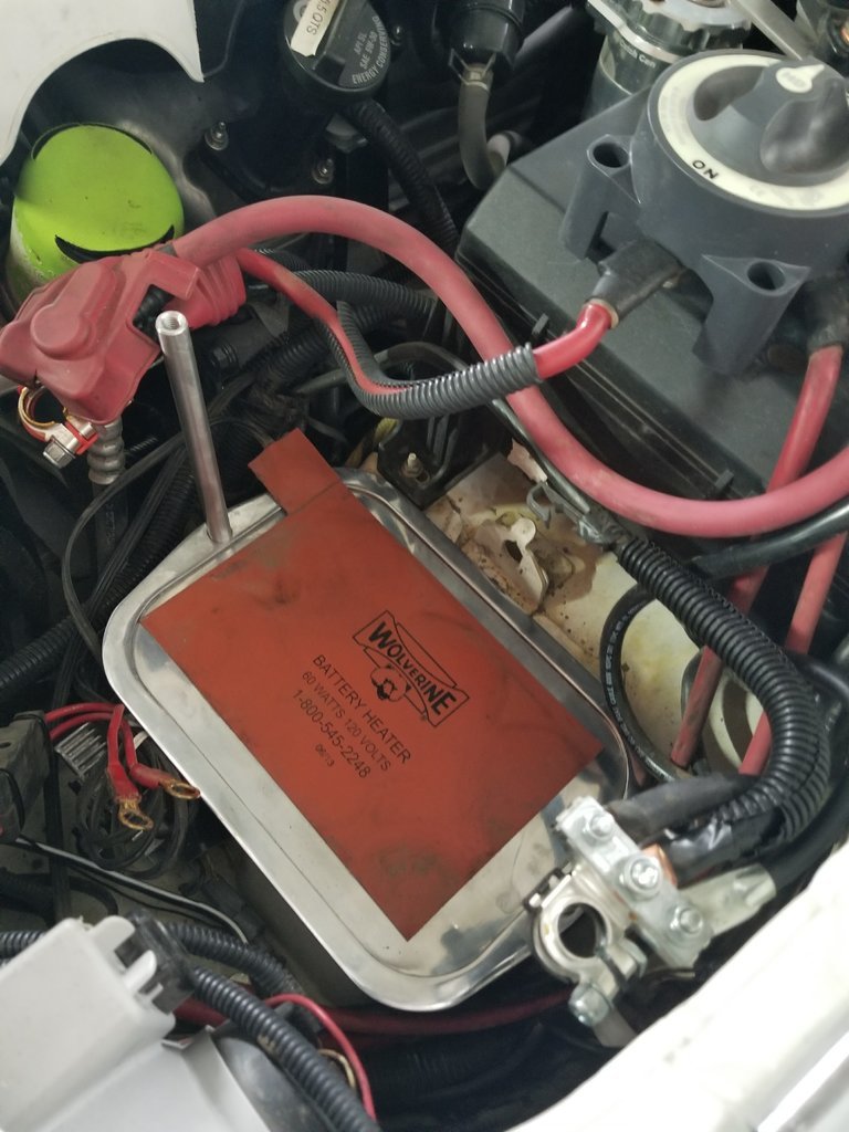

    installed my battery cage that has been collecting dust for some time...
    mark, drill, used rivets to mount down the plate, and bolt up

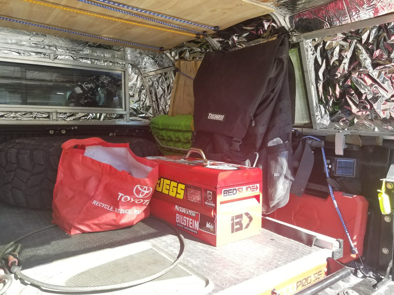

    put the cap back on for fall and re purposed the broken trasharoo
