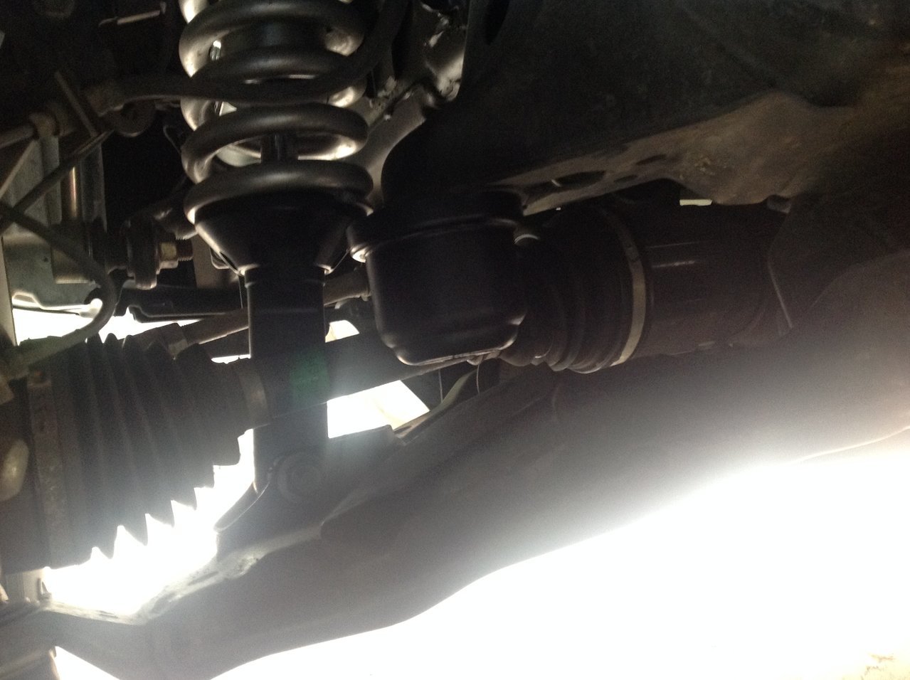

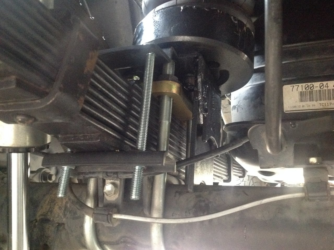

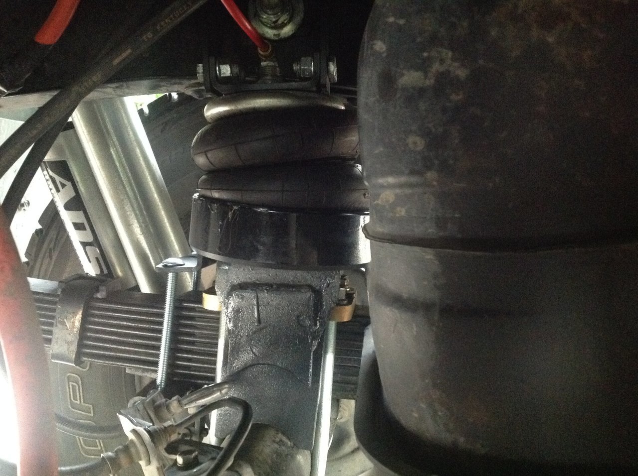

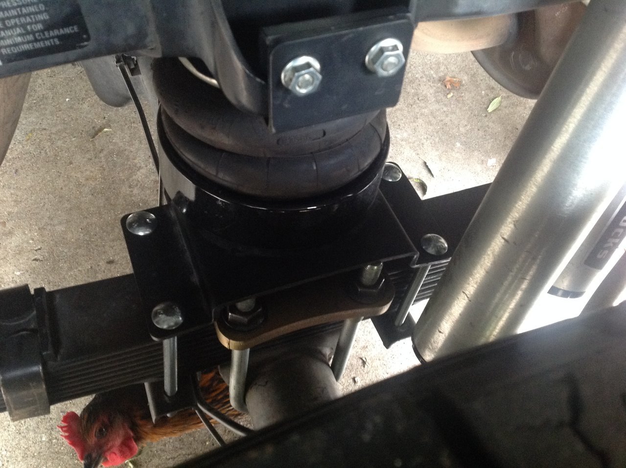

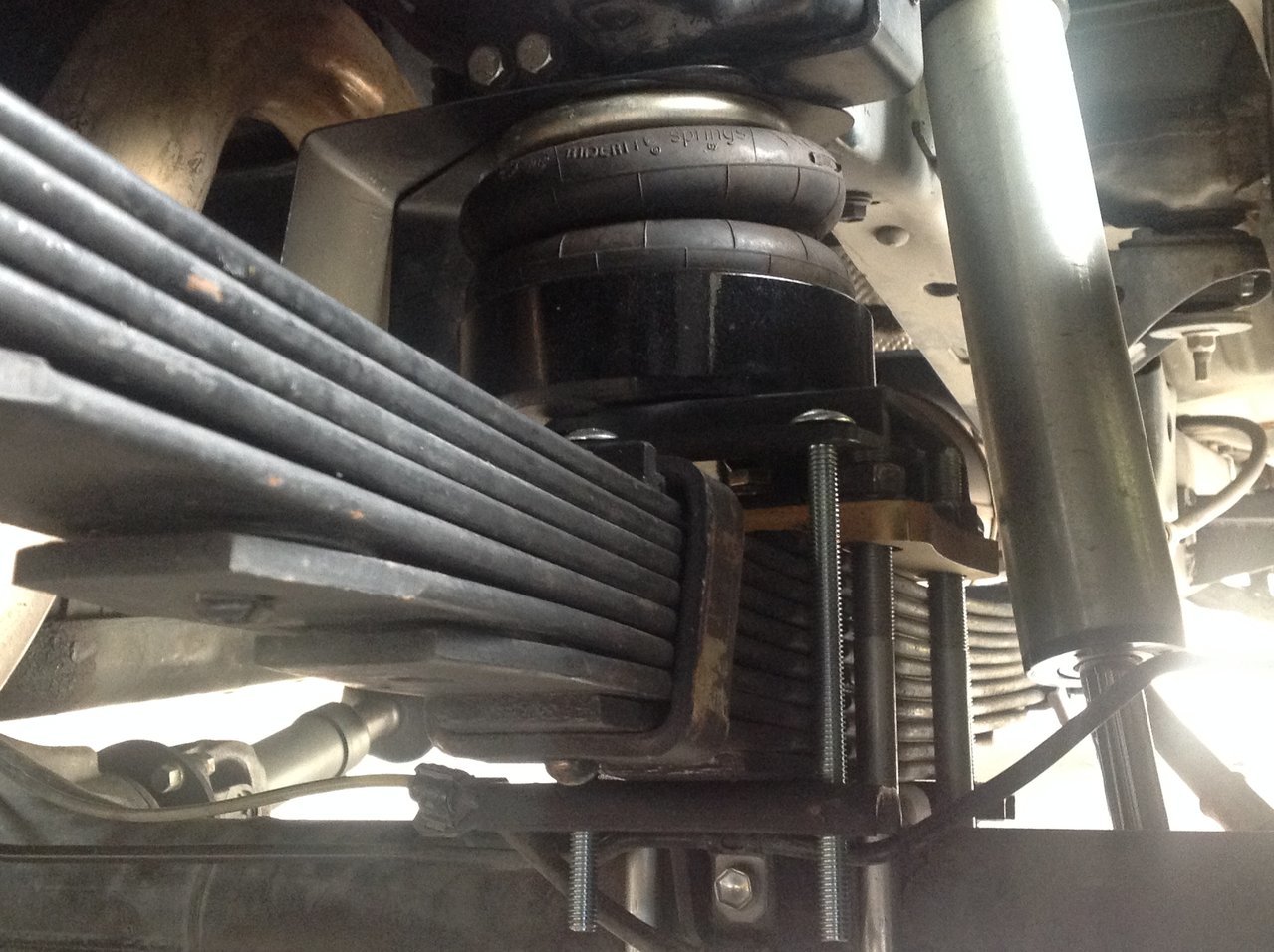

    image.jpg image.jpg image.jpg image.jpg image.jpg image.jpg image.jpg Following your example, I got my ride rite bags installed with my EXPOS. Fab'd a new support bracket for my cradles. Works perfectly, keeps the exact stance I want. Can run a low psi when loaded up now. I'm thinking all I'll need to run loaded up with about 600#, will prob only be around 20-25 psi. I'm running 5 psi passenger and 15 psi driver with about 200# daily weight. Moved my super bumps up front but kept their mounting place to act as a spacer/support base for my cradles in the rear. Worked perfectly. Thanks for your pictures and replies to my questions

    looks good, im assuming with those numbers you lose the taco lean. I run a few psi more on driver as well. If you find you need more travel, just shave your u bolts down to the nut.

    Yep, no lean. I think I'll be ok on travel length, but I'll keep that in mind, thanks again brother.

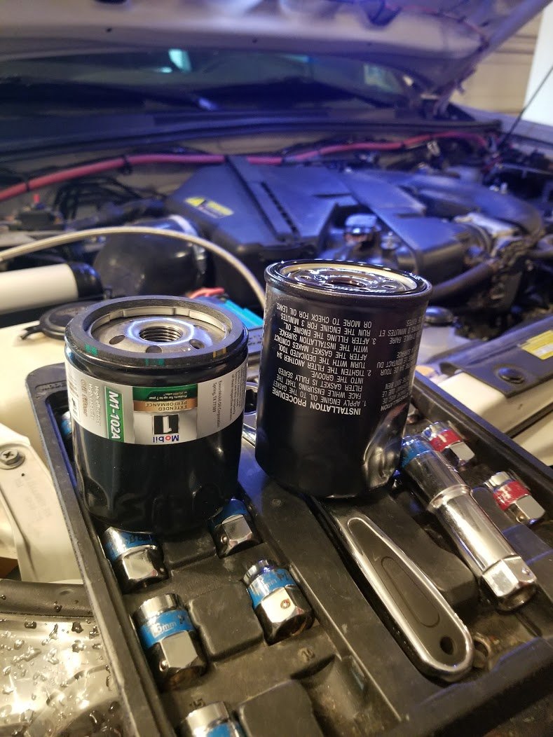

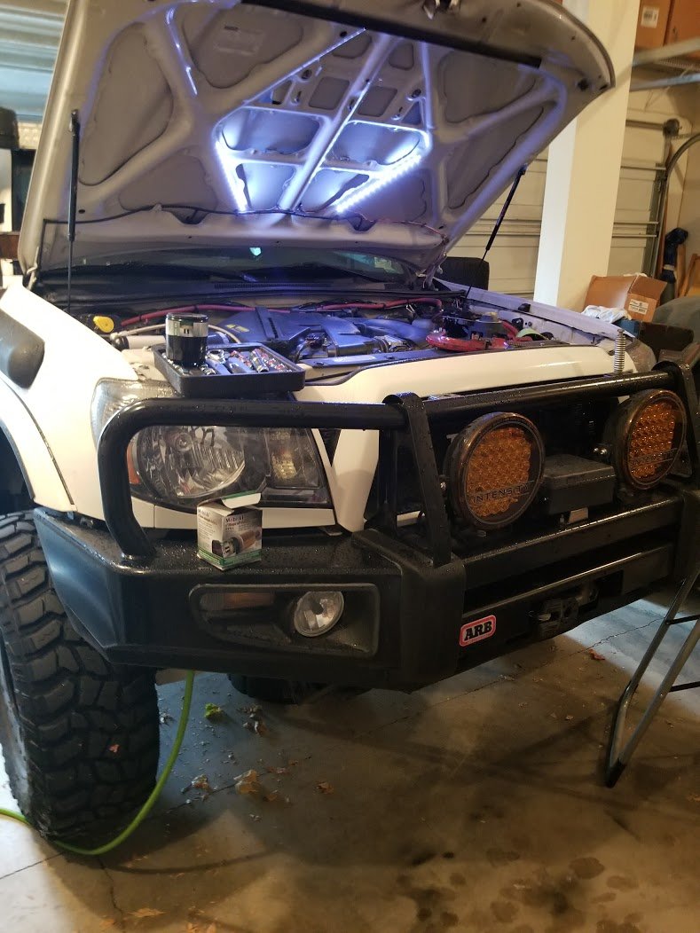

    changed the oil today, giving the mobil1 filter a chance over the oems i have been running. Emptied the catch can too....and mail call

    did you need that C clamp for the filter?

    All stock Superwhite 10' AC
    yeah i crank that shit down everytime so its needed to come off

    2010 TRD OR Access Cab
    i put some oil on the O ring, and then hand tighten the filter. Not much more is needed

    I have to shove a screwdriver through it. I really should get an oil filter wrench.

    i hand crank that sucker down, i shouldnt tho....

    I have an adjustable wrench for oil filters. Best $10 spent at Advance Auto

    i bought one from toyo, it sucks ass and slips so i just use the clamp -- 1/8 of a turn and i do the rest
