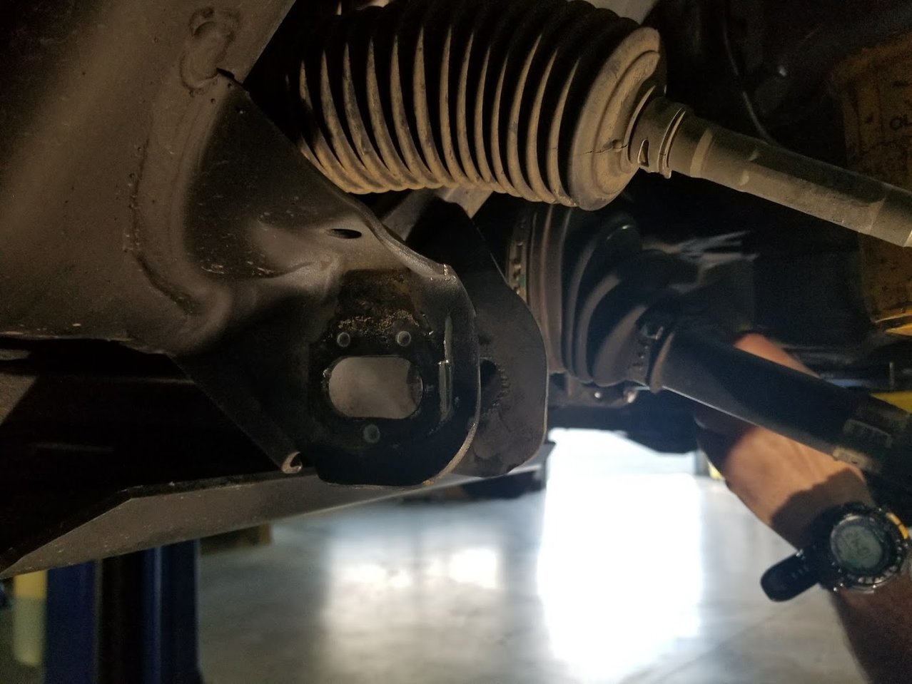

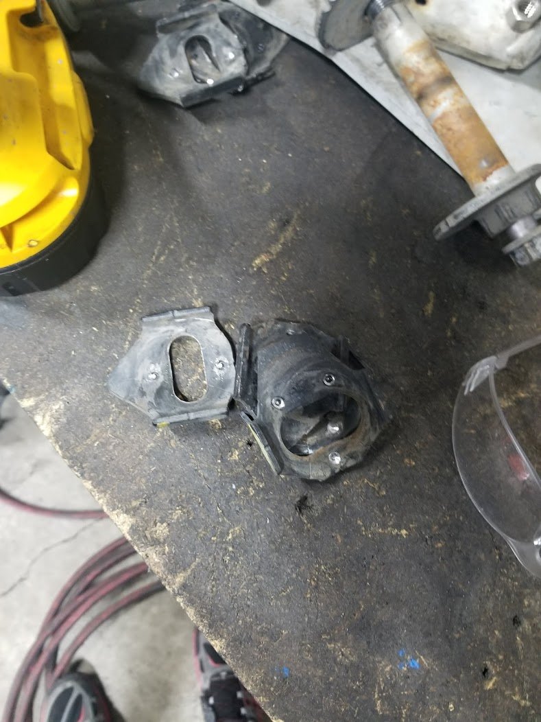

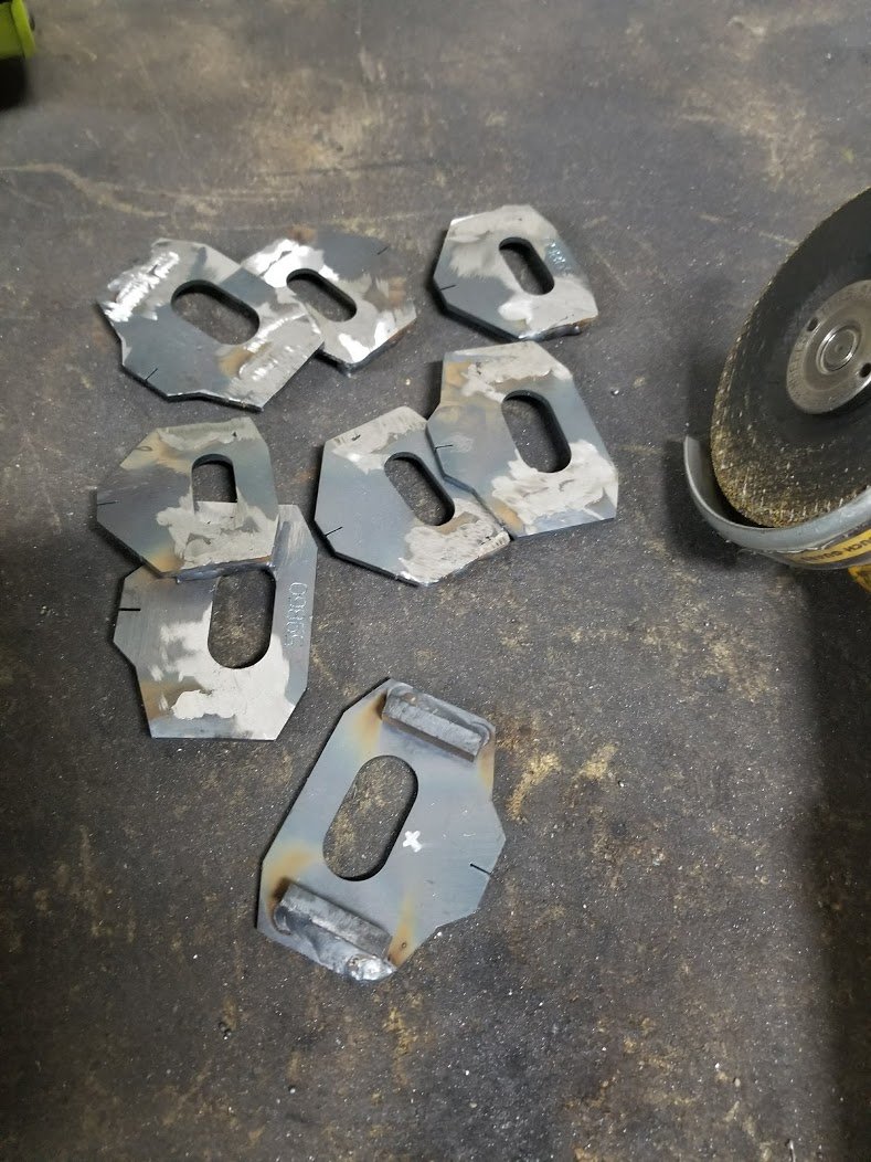

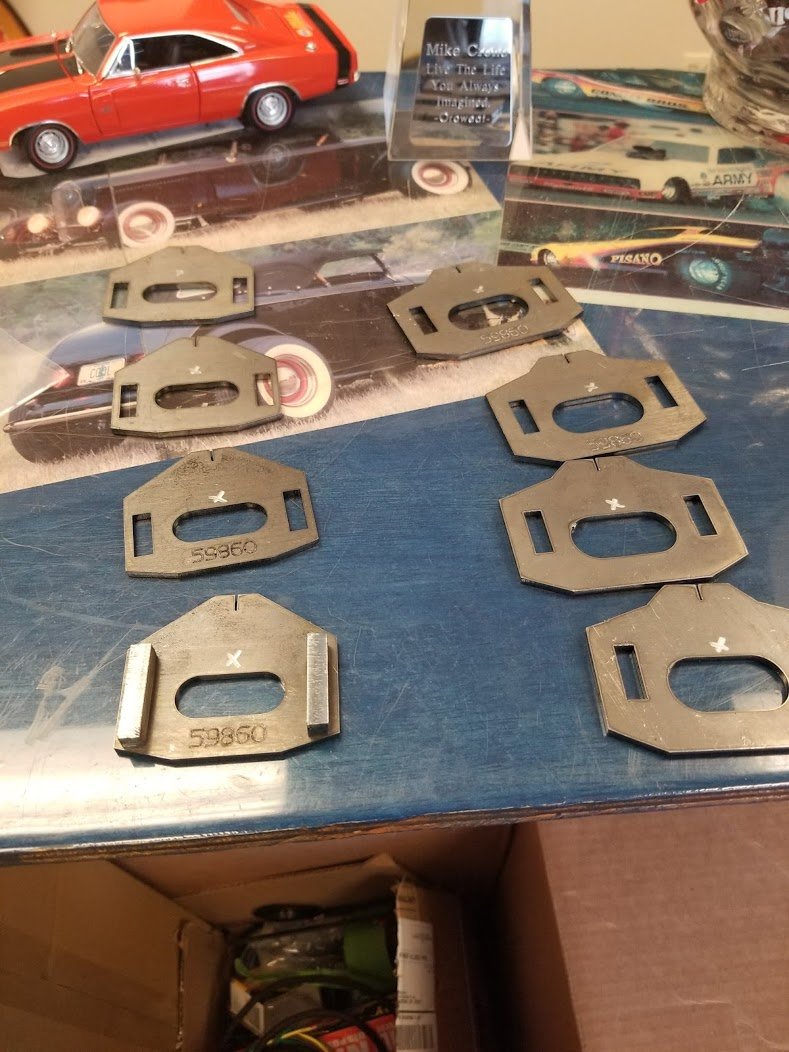

    tc tabs went in, truck drives tight like its in highschool, worth the money since i bent the crap out of the old ones and they wouldnt hold anymore
    they take some time to prep....
    tip: make sure you mark your alignment cams so when yout put them back in, your truck is not all funky. I usually mark the top center and the side contacts so when they fall out of alignment on trail i can readjust them to get home.
    QjCKtQFUm0UVnzmvOkFJQtA_Cmg0hTCEsP_YBdqr_3a5bd7ed0b80415d1fd6359949da7448c1fc41c1.jpgyBjP9LjngkRnqyQJfuXSsTq-Dd7URgb8bHAxmi0L_f6c294f05880e26b2558436dfe03f7befe86eb8c.jpg
    drill out the old spot welds and go at it with an air hammer

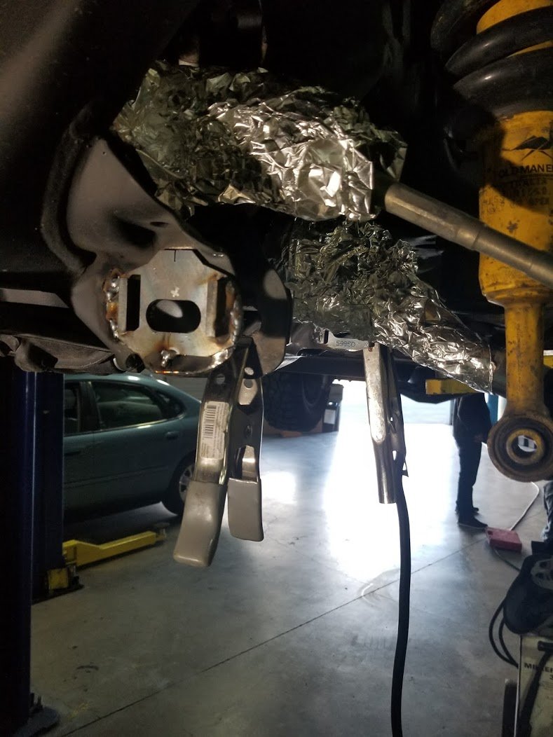

    prep for welding
