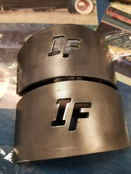

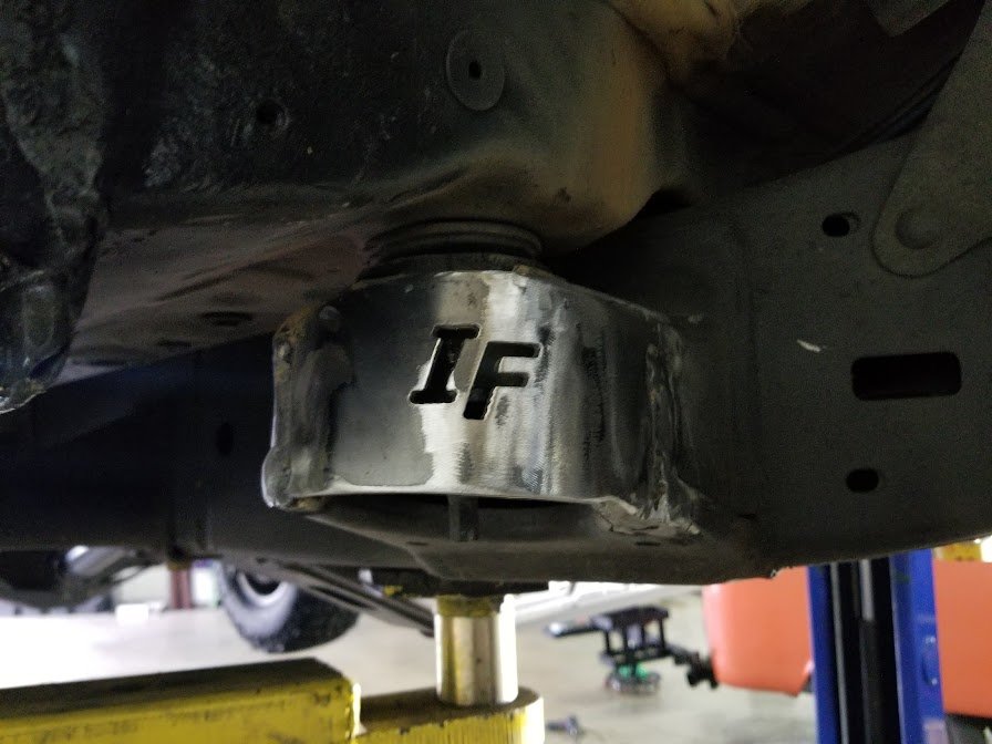

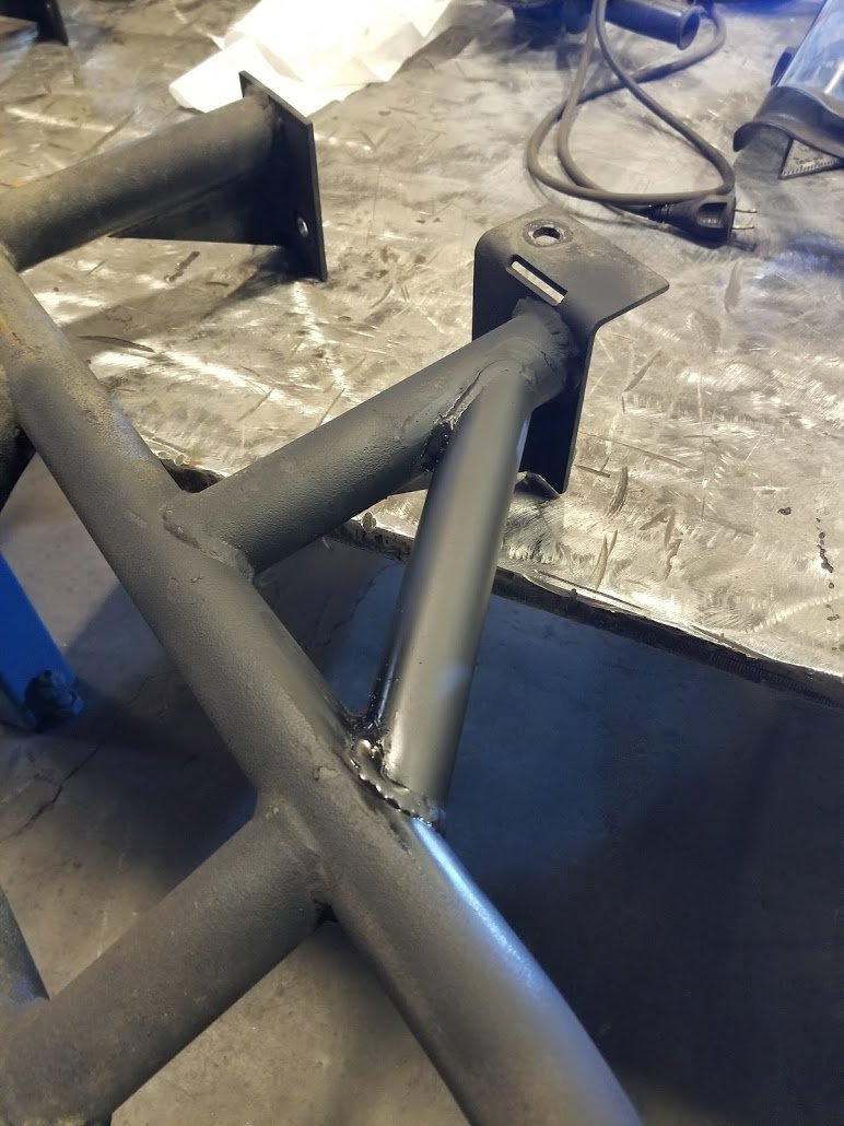

    redid my cmc with the insain fab plates, appreciate Corey for getting them to me quickly
    dScj0TH3ekl0G_36h3d9OqnkBp05Lq6iYttu2c1P_fe1b88369035efbe3095c34cff08205a72cfb646.jpgscVPzMCIXKZWVk8z-6nkfaS7C_lXGALY4In9fFaH_1fe7c864187a856ed5759db9ef1271bb9cec123c.jpg
    out with the old
    in with the new

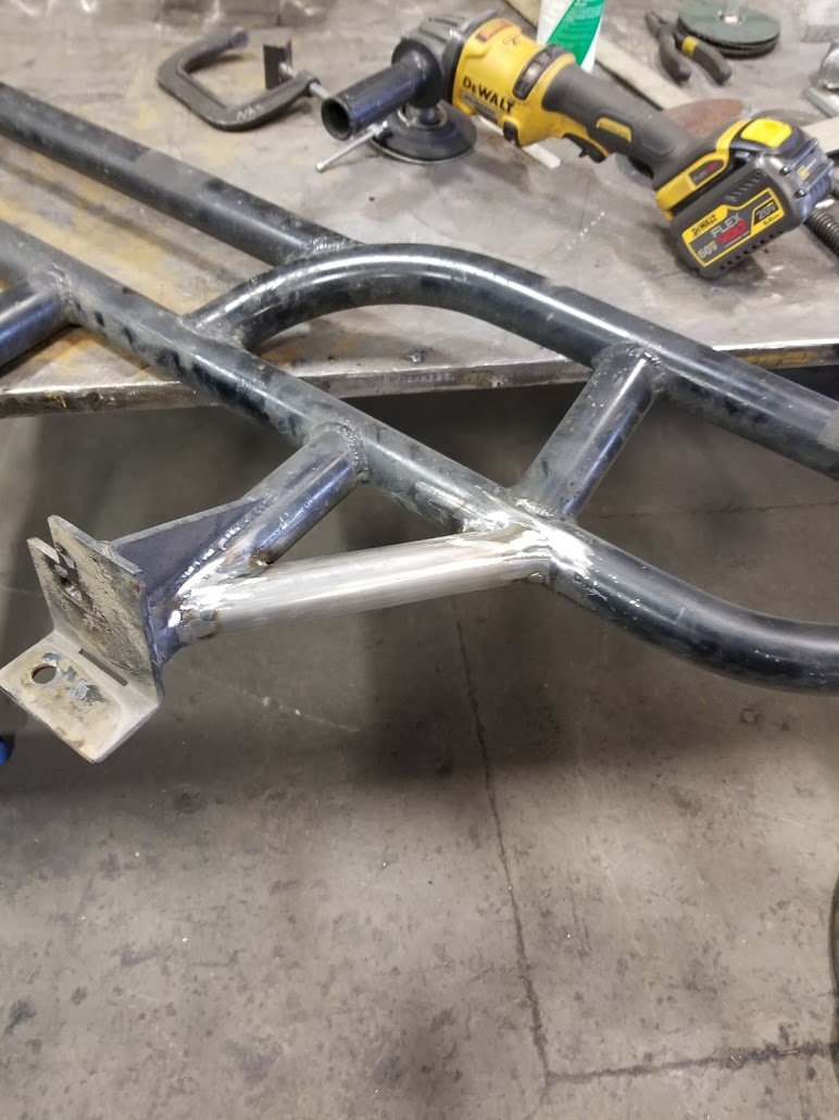

    welded some gussets on the sliders today, hopefully they dont bend anymore lol

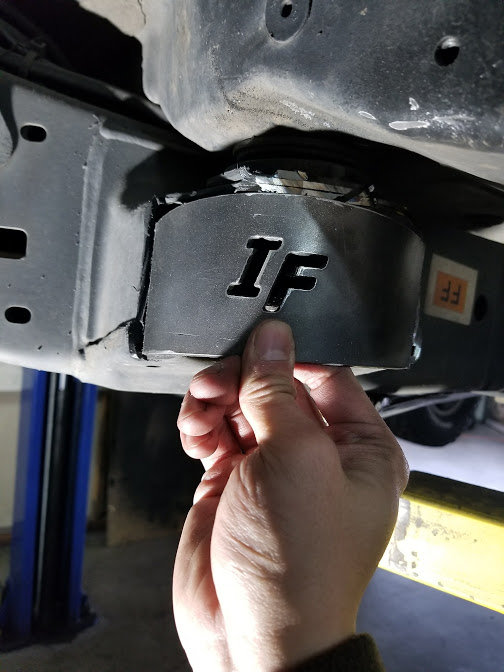

    got a snowmaster 60L

    How is it clearance wise now?
    ChadsPride and Kemosabe like this.
  11. Feb 4, 2018 at 7:08 AM
    #731
    inesshell
    inesshell [OP] blah blah blah
    Aug 2, 2011
    #60986
    7,166
    All stock Superwhite 10' AC
    no rubbing on flex/lock ;) you should pick up a set
  12. Feb 4, 2018 at 7:09 AM
    #732
    EatSleepTacos
    Mar 24, 2015
    #151688
    59,835
    Randy
    West Valley, AZ
    2017 4Runner
    That's great! I'll likely go this route then instead of relocating if/when I go 35s

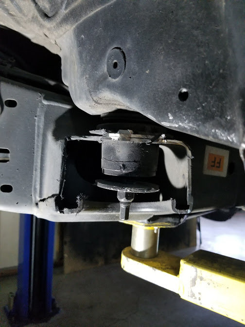

    So does that give you the ability to cut back deeper and around the body mount instead of just a flat cut?
  14. Feb 4, 2018 at 7:18 AM
    #734
    inesshell
    Aug 2, 2011
    #60986
    7,166

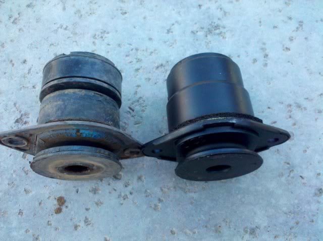

    you have to cut deeper than normal mounts to get them fitted, i actually cut even more than the supplied templates, nearly flush with the rubber mount, had to remove one of the bolts and tac weld the back in plate since the mount has two screws that hold it in place.
    ive found a pic from google for reference
