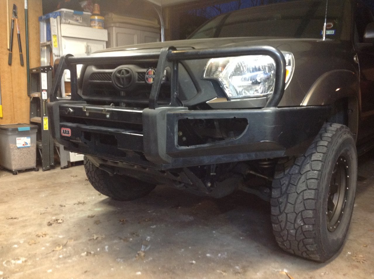

    What's up John?! Hey brother, I just picked up "New" to me ARB front bumper. I got it for a steal. The passenger side fog light housing took a hit and is not salvageable. I was wondering if you might know of a good place to source a new one? It doesn't even have to be ARB brand. The only ones I can find are outrageously priced. Thanksimage.jpgimage.jpgimage.jpg

    the fog inserts? dont know but if you send them a email explaining the situation they might cut you a good deal or give you a surplus set for free.
    One of the big reasons why i buy arb is their great service and they have taken care of me for all of my issues. Hope you get what you need from them.
    whats the mod list on the runner? I am a fellow runner owner as well.

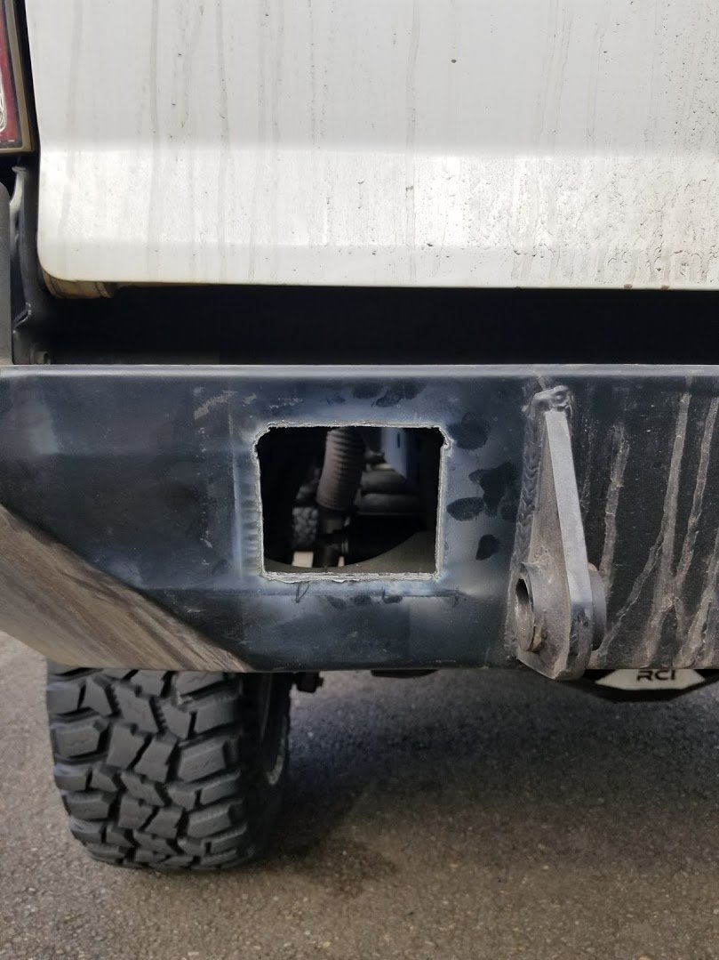

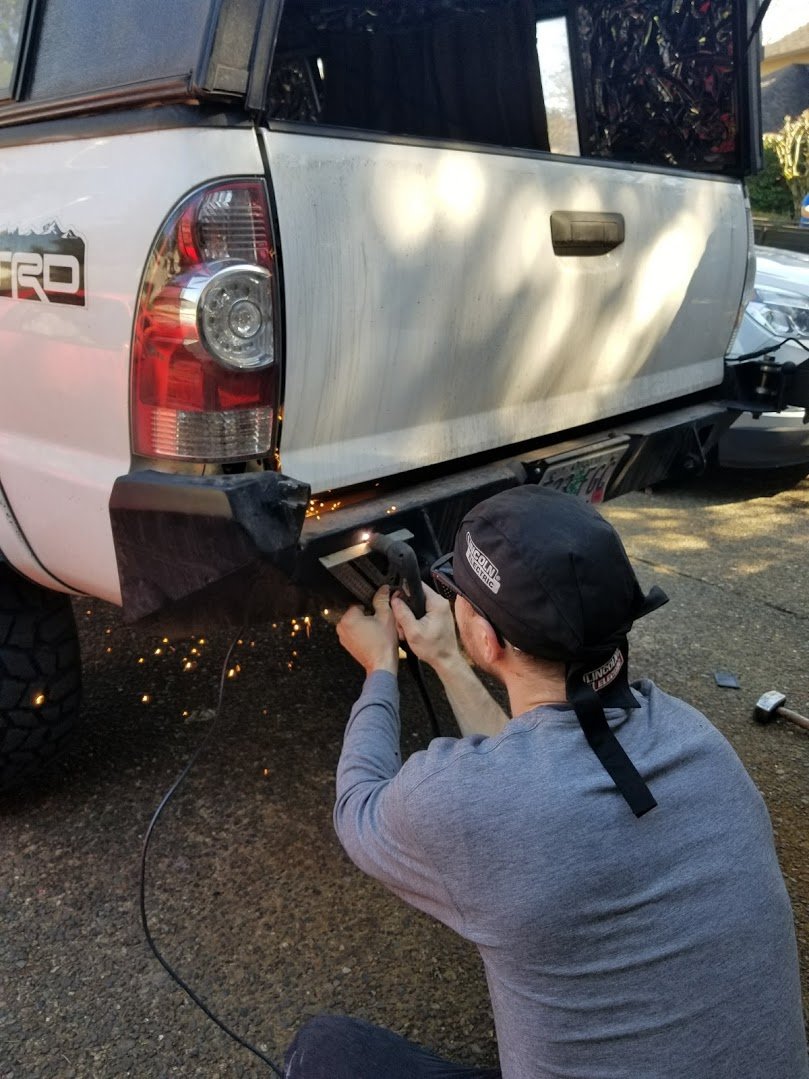

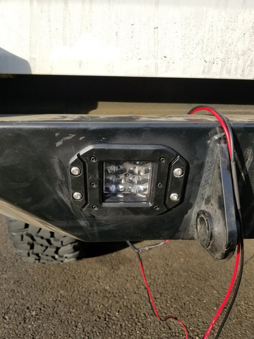

    flush mounts in
    1WrIAfDJT84i_C_rbGuhQksrjc2okSpje6Tcfmz-_559a626ac116d06d93e6c4d45ead32fe9b2c9148.jpgwd2rE63U-BUGdZ4i9NaAbE4NXdwjJLG6IoAOknNo_dc333e373b2aacc01b5aeed7c250b7d8815ee790.jpg
    vYAVgTRpNnBlpjvB-O15zRbfh4t_f3eQBf4q2u0D_1040b1cb11cb670d631c12c3297511dedb19357e.jpg
    gtCRXIum21-cIuIEf4S8ZUijIOIJqBlRR5KBCr6H_ed02da9fa01181b731951d2bbc8a066e05e68229.jpg
    and some car caught on fire on the hwy
    IIt0xaSJvva8GKu298S8UeaSNvxjjrzm75Z88Ew0_ba86ad31ea3b9cbf5cd7ddce9e3d13dfeb80f21b.jpg

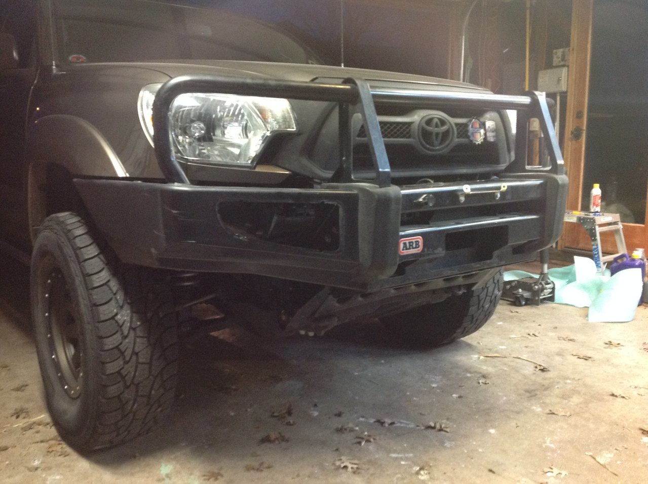

    Big John, what's up? Hey man, I did some repurposing and was able to fix the broken housing for the ARB fogs. I'm using my OEM fogs. Hey I was wondering, just whenever you have a chance, would you mind posting up a write up I can follow on how to wire the turn/indicator lights into my daytime running lights so that they are on whenever my DTRLs are. No rush. Muchly appreciated!

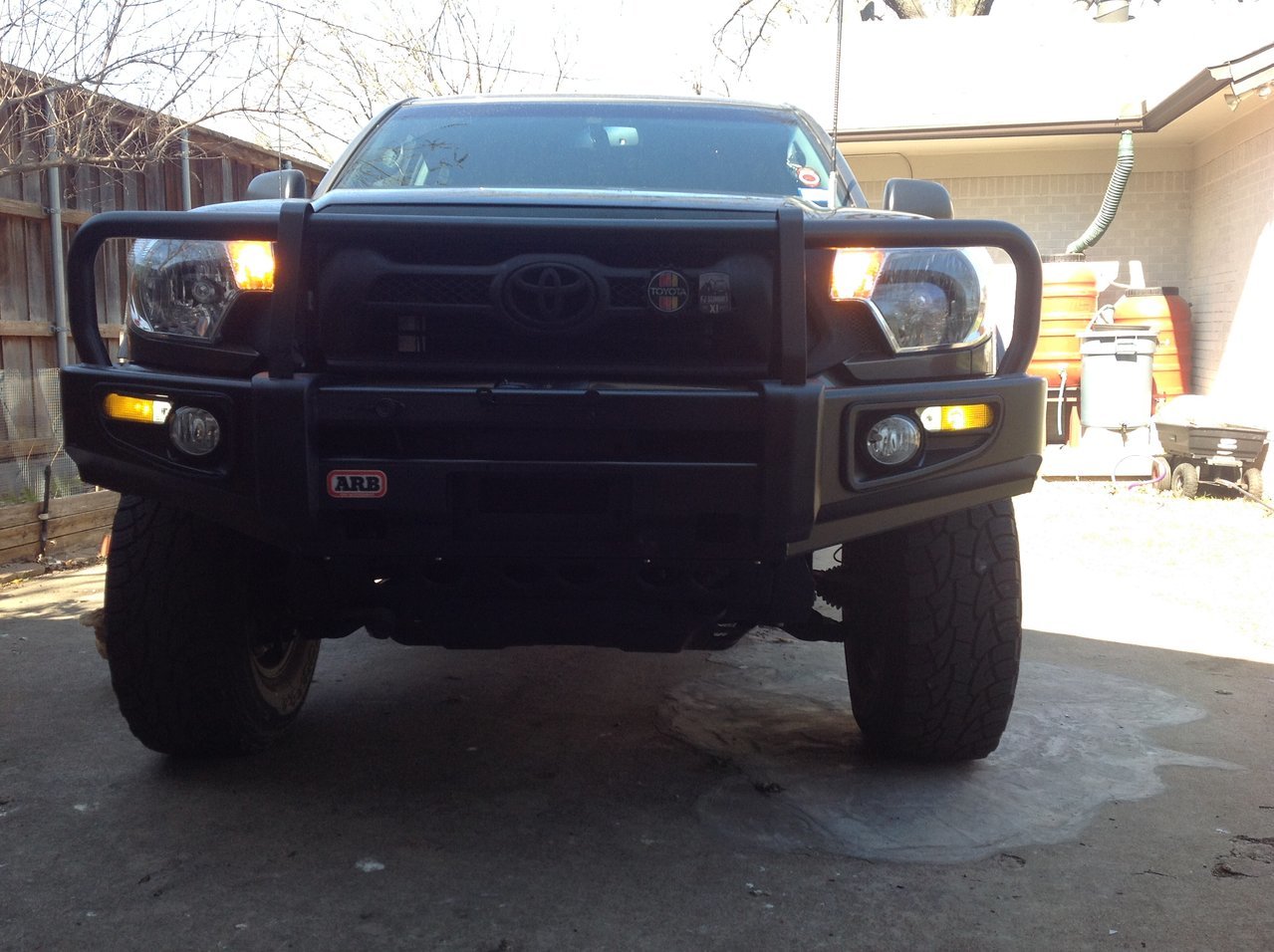

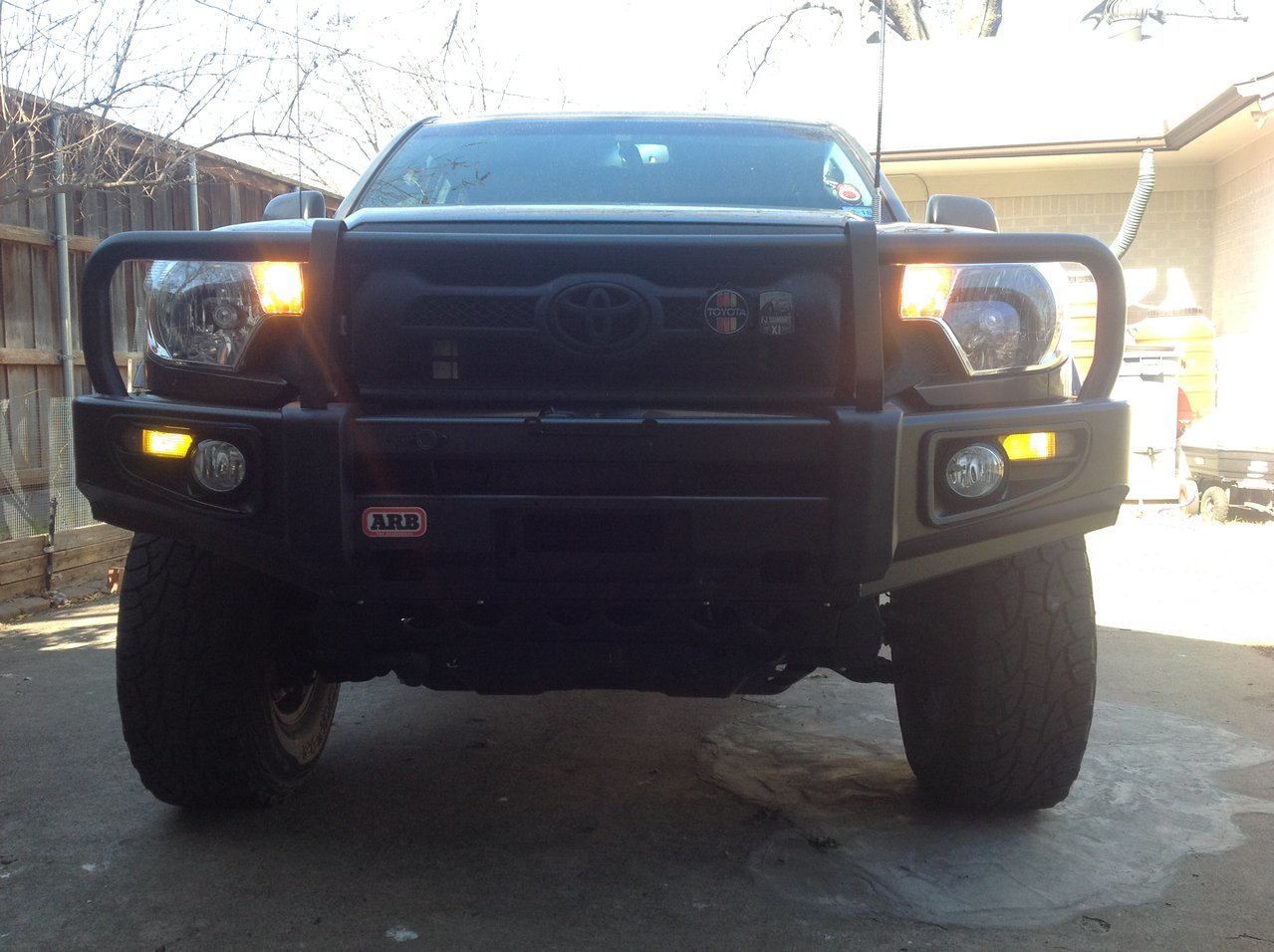

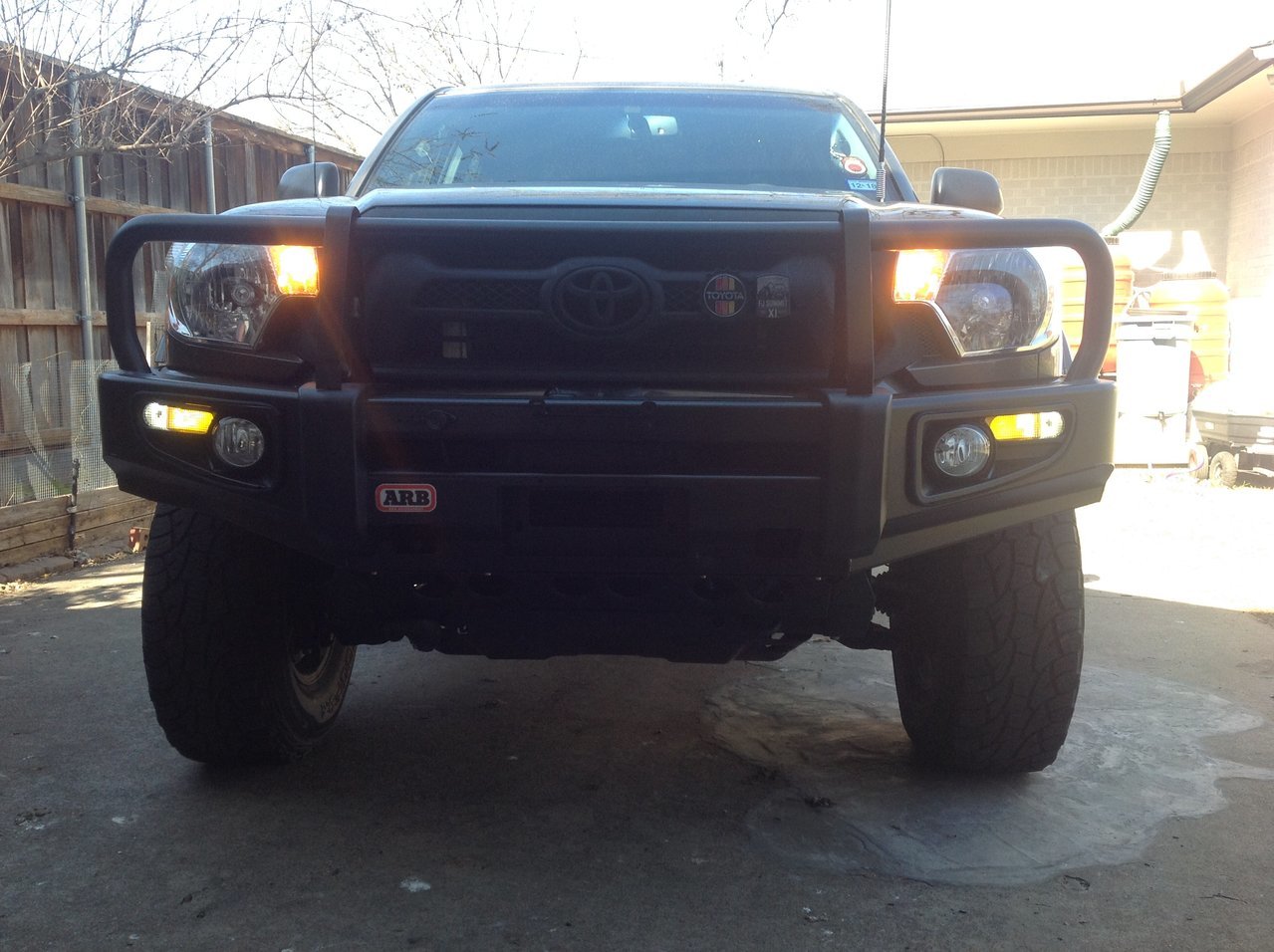

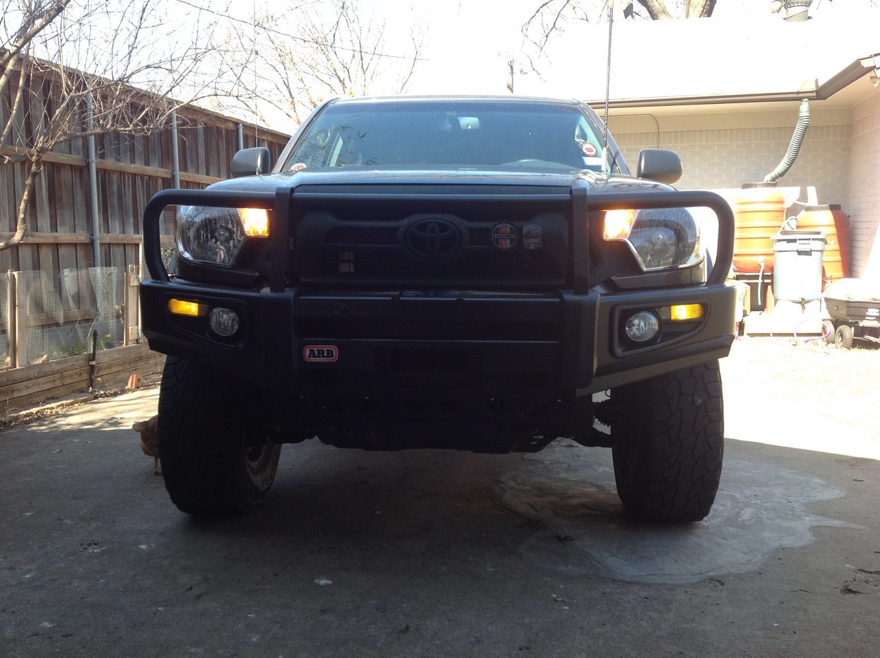

    Finished em up Big John!! Thanks to you! Man the led's make the difference. First pic is DTRL, second is parking lights with indicators lit, then of course everything is on when I have my lights on. I'm very happy with how it turned out. Also ordered a new pair of housings. Thanks again....againimage.jpgimage.jpg
