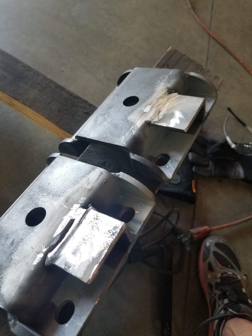

    rSTswqylPKIzS4bLE05FC_d9XpSodJmZ1SJHIXzL_b0863494fcba6a6d2c9ab80d601f9a13859a7b0b.jpg
    took some measurements today, tomorrow ill sand blast and weld the mounts on

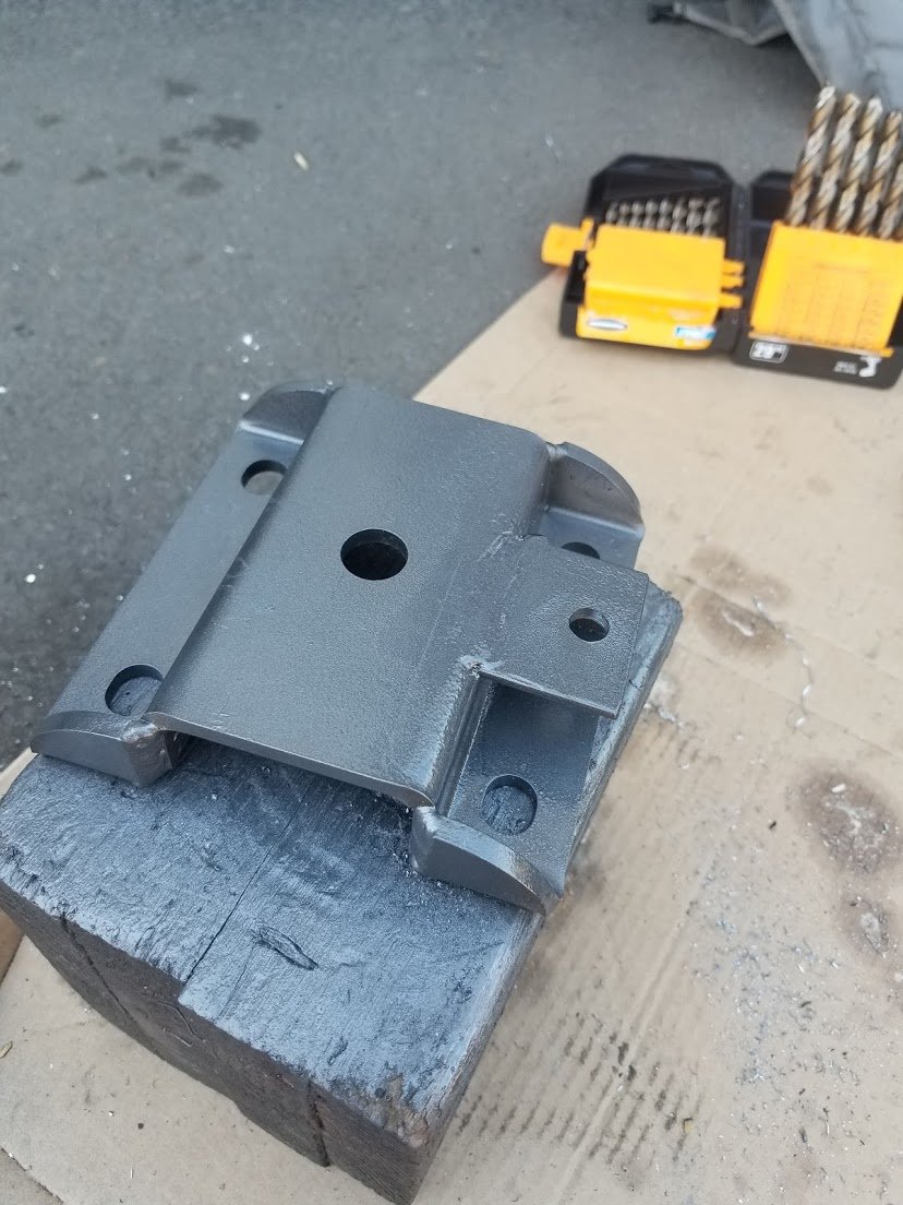

    What exactly are those for?

    lowers u bolt mounts so i can lower the airbag cradle to gain more up travel

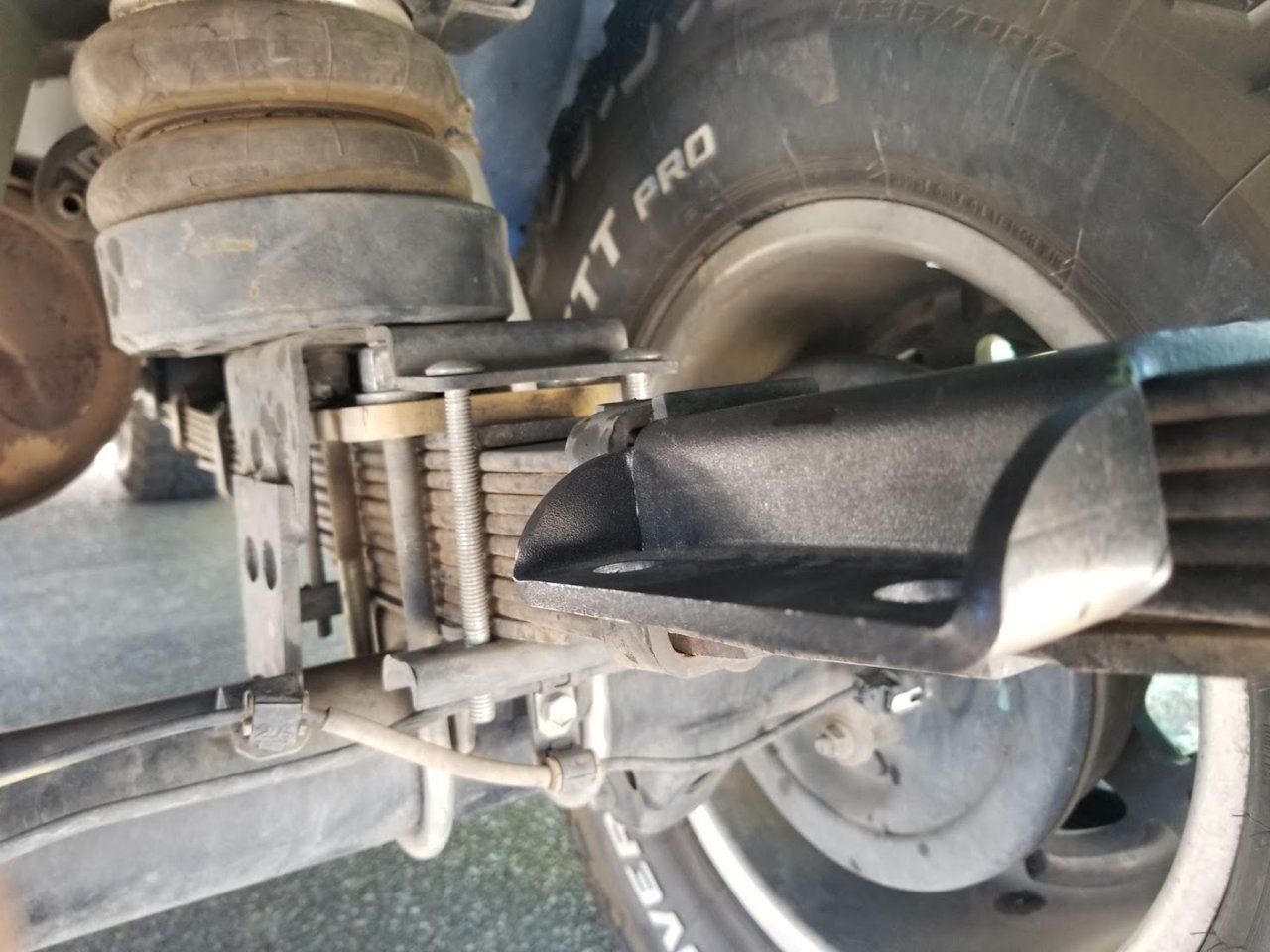

    rZZNgiHmkZ3vScIjFNnfBf1KmLMrlnf7olraCaZ-_ce2ce366b823e7f1b400390ee7ac1080e821f259.jpgvS5o2Icjm4-hgZ5pXjEFp-M6DxJ8pNeOeGID1Ngv_1be1eb949b967045a1a8a6c1617e69f8b749dae2.jpg
    built those brackets and swapped them in today when i replaced my shackles. There were several observations:
    pros:
    - they gave me back about 2 inches of up travel
    - lowered the cradle as they were expected to
    Cons:
    - the design of the bracket and thickness of the bends to the lower mounts offset the u bolts further away from the leaf pack creating a gap between the leaf and ubolts
    - the metal on this bracket was much thinner so it bowed a little at the ends when torqued down to the 75 spec.
    my decision to use these? im not sure anymore solely because of the gap created in the design of the bracket and having space between the leaf and the ubolts. Might go back to drawing board and mock up a plate to weld to the cradle plate that bolts to the original all pro ubolt flip plate like you originally posted. More solid, stout, and it allows tight clearance of ubolts to the leafs for security

    Dang man, sorry. I saw it in my head just like that. Didn't think of the "gap" issue until you said it. Makes sense. Well, what I did with my setup is working great, and it's easily removed if I need to, if you can go that route I think you will be happy with the structural integrity of it. However, your back at square one as far as your up travel. Keep me posted

    yeah the gap would have been tolerable if it wasnt so large, i believe the ubolts last i measured it sat 1/2" from their original spots. Hasn't given me driveability issues but i can imagine with that much moving room for the leafs, it wouldnt be surprising if it created a weak point while wheeling.
