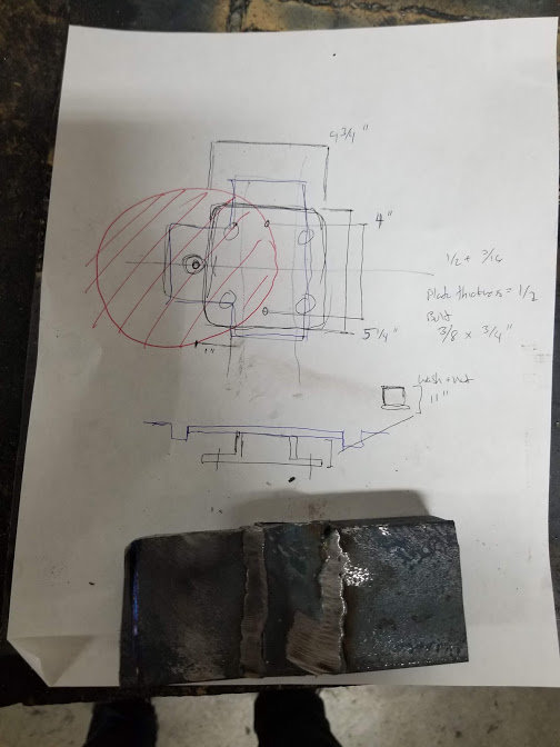

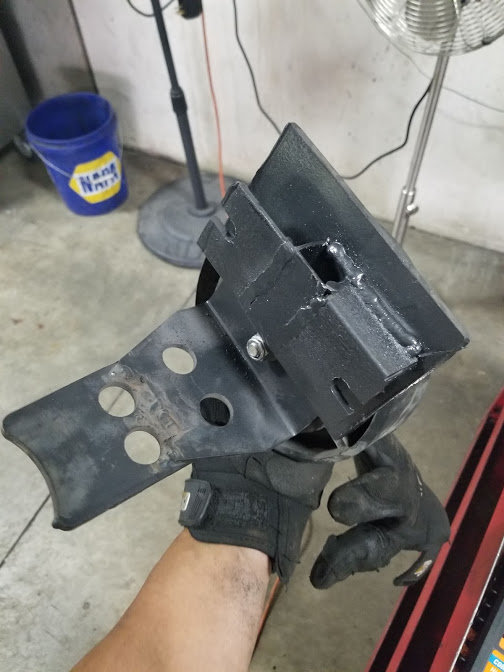

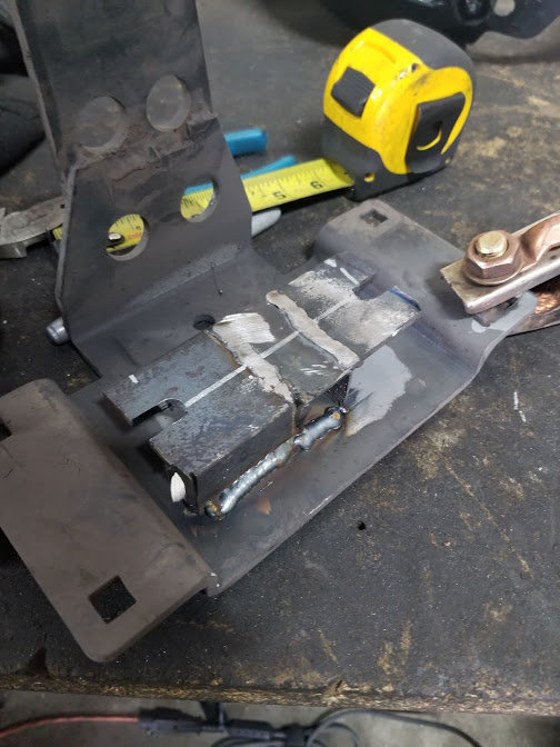

    @Fox2011PM
    bRwTn-adO-UNtw9LRQp-bSq4lqaprIcCEJ0L4h1w_ed13496d06e3d6494e9d7f9d5407cac6e264535e.jpg
    notice the bowing, i might weld some 3/16 between the gap to act as support guides like we originally had on the air bag plate

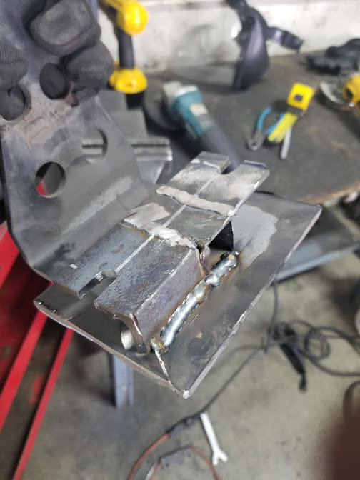

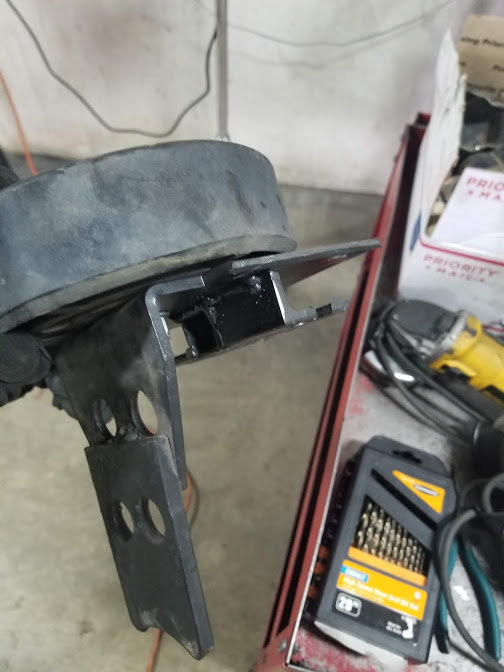

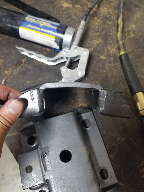

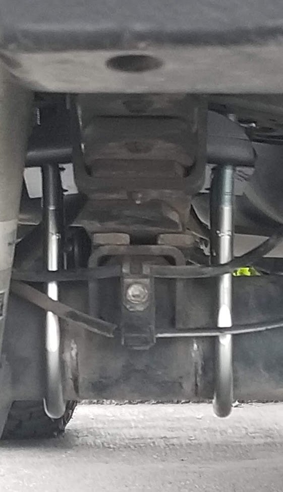

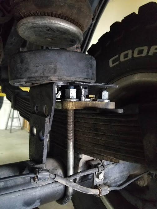

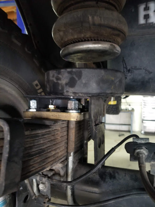

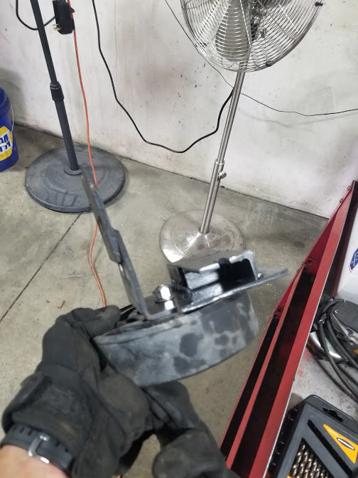

    @Fox2011PM thanks again for all your help and ideas, would have never thought of getting rid of the airbag's extra hardware.
    i think this is the last iteration lol
    here were the brackets made for the bottom of the cradle
    cgka4z6b5uXhcJTOmN51Hsp_nbHSDYFCivUvhtgK_ec314f64a5e5865b08ed5dcc75bd2e987cd0b27f.jpg31ixPum1l0cJIEhj1lDNvs5WViw4q3rPlc2BqHQ7_3d0517f0ee3aae8dbc882399355b154f934a80ef.jpg
    QtWn_hsvwtHRLQlAw3oHA5Fu8H7KzONQDzG-2Aqg_dacbe75df3f112888ca0fac3c088ea5c6eee02bb.jpgk4EJsNNMqKIYmt5hBMgzzQfO1tGytnssLhw_FiTf_8d383d0f647818b06d4226d2beedf8ddc9bdbf16.jpg
    L7fPz991_N2zLIWxO6dzromnJlXMQ9bR7mZOLfKw_ee06afb0536b0ad876ac0fadc613bc5d30e98dd7.jpgJWVUYZLZDZTEvnVy7UHs68u_ZvD2x2lAUlpXYCx7_fafbf9abfa2c626dacd0ac9c11e1d9e8865ac439.jpg
    -fQu9YjQ6EBObVnaAmRroKTSUTyq0bhlfKgQO_F2_088174bb8a525d2640ca2f2c6db492302575f7f8.jpg
    on the truck
    MQfPOLnjgM9J9sXpUfS3mDMEOs22PMQZXt5lo6Nt_2dca8b7556059e36bf5477182ca741874db9ace0.jpgx1qlNu3WXjYHB-gVsEb5Bcm_uuvIdC3wTJMfx75i_a6c83dfb4f78099800e16e18c9ffc4e3542cd983.jpg
    here are the old ones bowing
    ccubbkXszL1-G6Ws-rnA0IR3nd5MQrAxs_N6us3Q_cbd76166795c05458db94b56a214f0b6378a1738.jpg

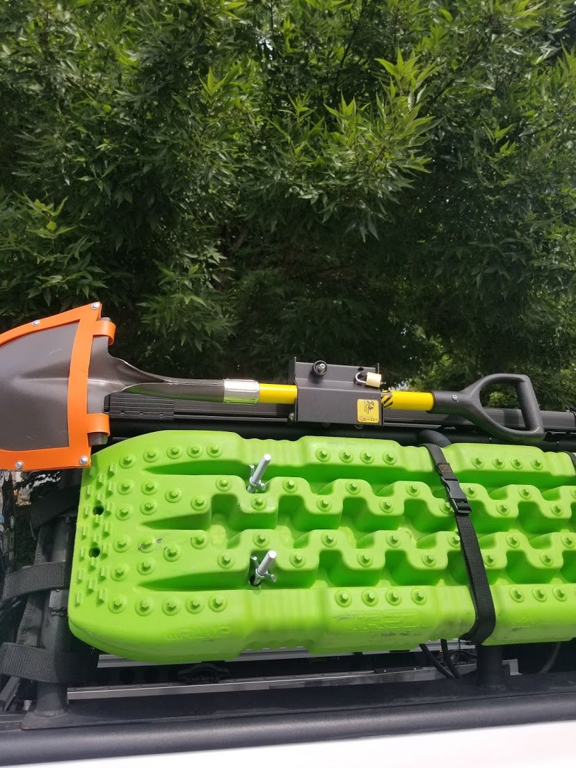

    6pcJdz433c1qzdYkcA9sJUCpgTuFucJO5CVmR_cZ_deae1ad7009cedcbd70c56608e863af43df3c760.jpg
    @Fleabag dont think the double can hold your maddock unless you point it the other way, it clamps down pretty snug tho
