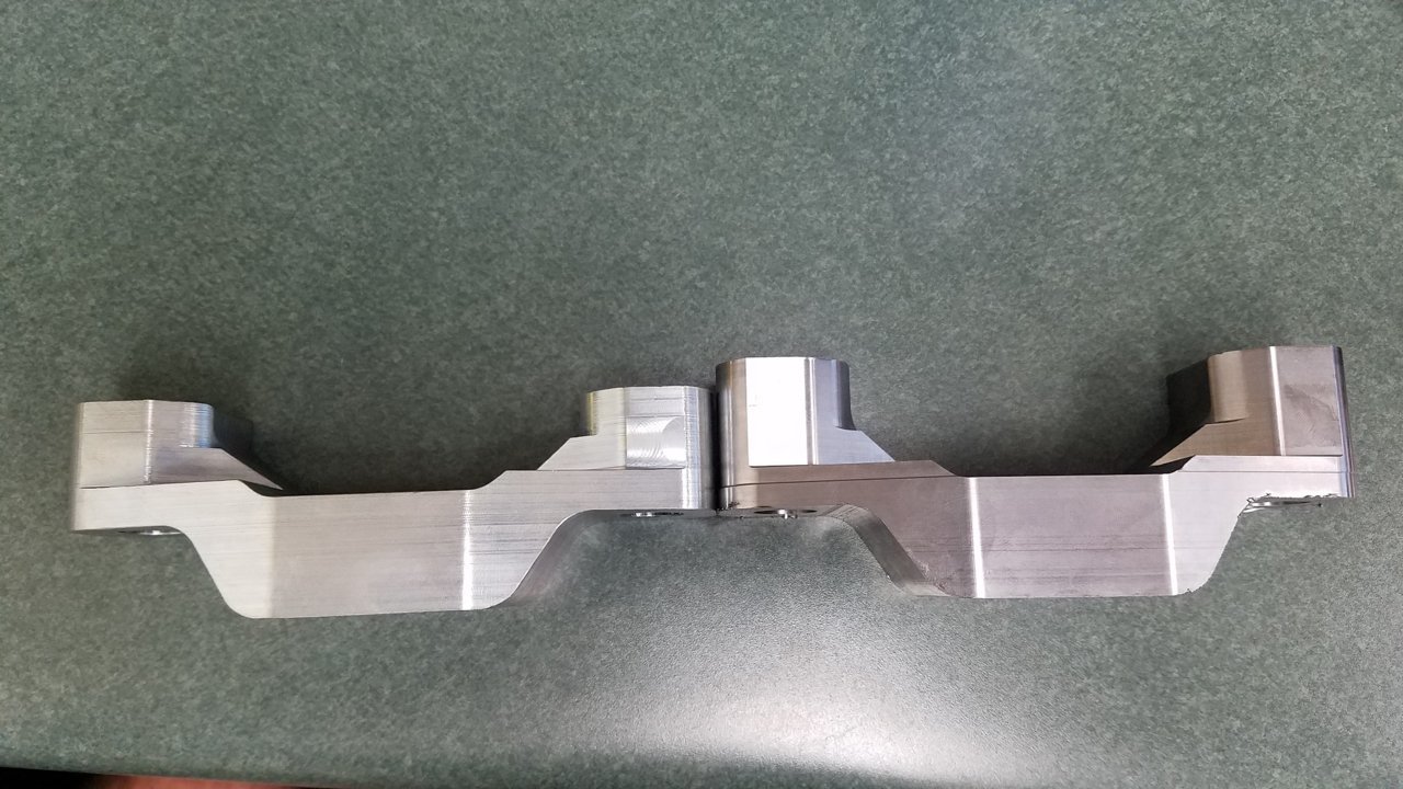

    mmmmm, billet aluminum parts?
  3. Jul 20, 2018 at 8:16 AM
    #1143
    inesshell
    inesshell [OP] blah blah blah
    Aug 2, 2011
    #60986
    7,166
    All stock Superwhite 10' AC
    yep :)

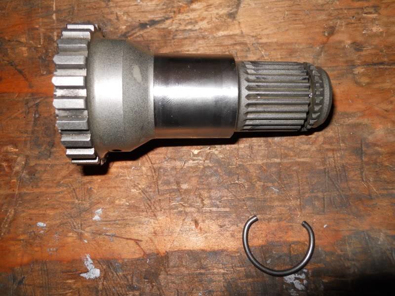

    @Fleabag
    make sure when you get your fronts from ecgs if they included the add engagement gear on the passenger side. When you pull off your oem one you will see it. Sometimes the donors dont come with it and you have to extract yours and transfer over.
    Fleabag likes this.

    Suspension: SPC Light Racing UCAs Old Man Emu 886 Coils Old Man Emu 90000 Nitrocharger Struts Old Man Emu 60091 Nitrocharger Struts Deaver U402 Stage 3 Leaf Spring Packs Dobinsons Greasable Shackle Bolts Old Man Emu 95PF5 Trim Packer Energy Suspension Bushings Timbren U Bolt Flip Kit And Bumpstops Timbren Front SES Bumpstops Total Chaos Cam Tabs Tires: Pro Comp 87 Series 16's Steel Wheels Goodyear Duratrac 315/75r16 Engine: aFe Cold Air Intake aFe Throttle Body Spacer HyperTech Speedo Calibrator HP Tuner with a JustDSM and nd4spdbh tune file 3° Exhaust Cam Gear from Mightytacoman Peddle Commander Throttle Calibrator Drivetrain: ECGS Front Differential 4.88 gears with Harrop E-locker ECGS Rear Differential 4.88 gears with stock E-locker Tom Wood's One-piece driveshaft Derale Transmission Cooler Derale Thermostatic Switch for fan Mishimoto Fan for transmission cooler Improved Racing Thermostatic Cooler Bypass and filter relocator for transmission cooler Electrical: Eaton RFRM Custom PDM 10 fused relay circuits, 10 fused circuits Feniex 4200 Mini Controller with MeSo Customs mount. LED Bulb Upgrade Front - Rigid D Series Pro - Flood Diffused Rigid D Series Pro - Spot Rough Country Midnight Series 20" single row ARB 9" knockoffs Rear - Rigid D Series Pro - Flood Diffused Communication: Midland MXT275 GMRS Radio Assorted GMRS Handhelds Suburban Assault Armor: MobTown Rock Sliders - Plated MobTown Tail Gate Reinforcement Brute Force Fabrication Plate Front Bumper Brute Force Fabrication HC Dual Swing-out Plate Bumper BAMF Full Skid Set Chaos Fabrication Bed Side Reinforcements Recovery: Superwinch Tigershark 11,500 SR Hi-Lift Extreme 60" Shovel Mattock ActionTrax Recovery Boards Straps & Shackles Exterior: Homertaco Ghost Raptor Grill Alpine Designs Offroad Cab Mount Relocation Brackets Fender Trim Firewall Massage Stubby TRD Antenna Weathertech Window Deflectors Toyota Hood Deflector Soft Tonnaue Cover Color Matched Canopy Custom Aluminium Box on Swingout Modified Bedslide Interior: MeSo Customs Maps Lights and Dome Light ImMrYo Rear View Mirror Relocate Bracket LostSheep's Ram Mount - Mount DynoMat Ram Mount X-Grips and Various Connectors UltraGuage Weathertech Floor Mats Chinesium A/C Knobs Horse Blanket Seat Covers.
    I was wondering about that, did you have to pull it apart to get the gear released or were you able to pry enough to get the clip to release?
    inesshell[QUOTED][OP] likes this.

    mine came with it in the donor, sam however, we had to open up the clam shell to use a punch to tap it out through the backside.
    Fleabag[QUOTED] likes this.
    Absolutely, Ro had the same thing happen to one of his axles...
  18. Jul 20, 2018 at 5:49 PM
    #1158
    Subway4X4
    Subway4X4 Shameless Copy Cat
    Nov 10, 2015
    #169260
    11,668
    Lloyd
    NY/NJ
    05 Speedway Blue DCSB OR TRD
    Everything TW members recommend
    Also called the stub shaft.
    After front was installed, diff oil filled and on the road for a week. I was wondering what the hell was wrong with my 4WD and thinking my front tcase actuator was screwed. Took that apart and rebuilt it.
    Further long drawn out investigation found out that the stub shaft was never inside the front diff when shipped from ECGS.
    ECGS sent me a stub shaft and I had to remove and reinstall x2.
    PITA.

    this little guy
    you can use two pry bars or use a punch from the other side to get it out
