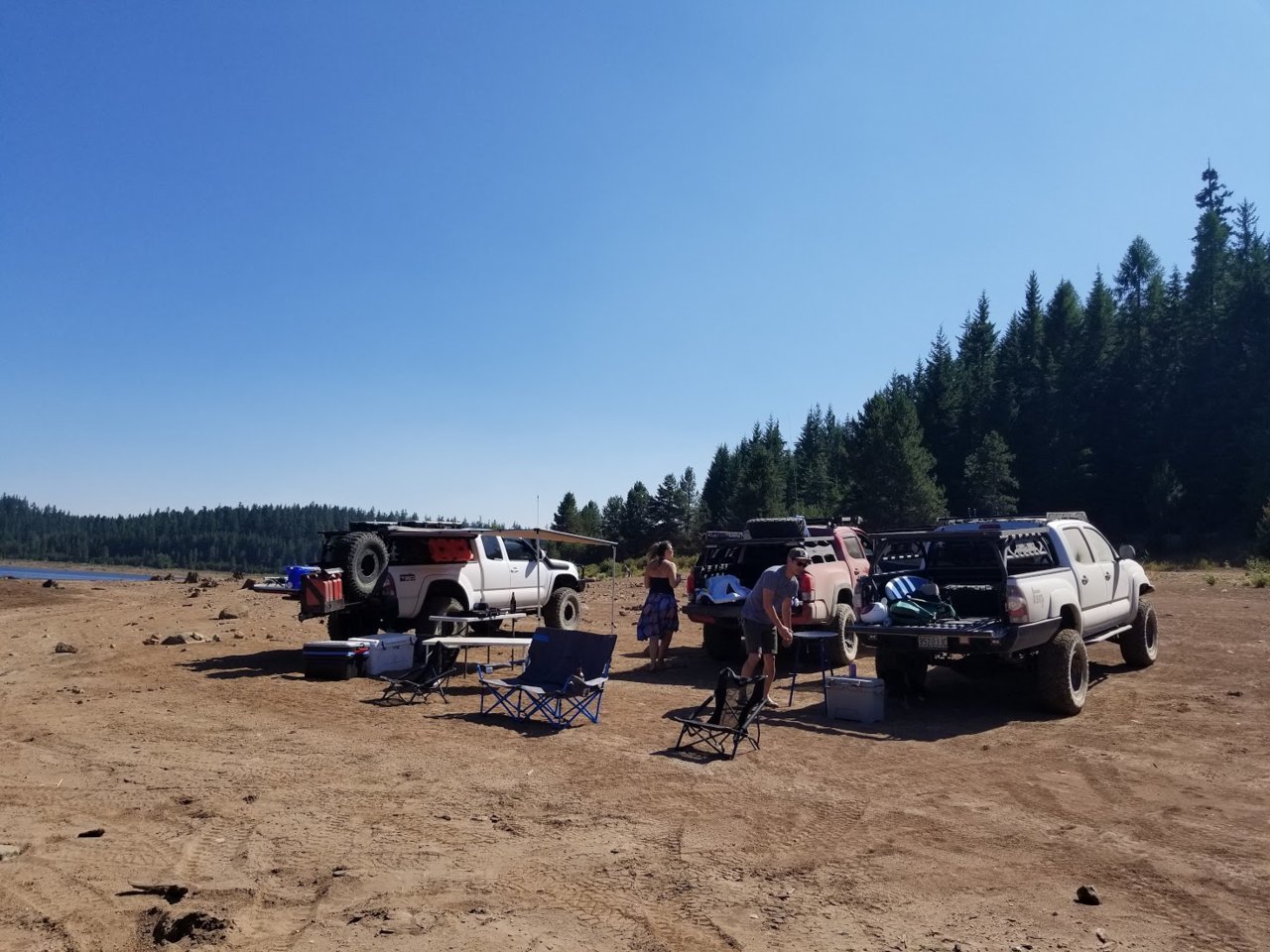

    yesterdays outing with the dogs

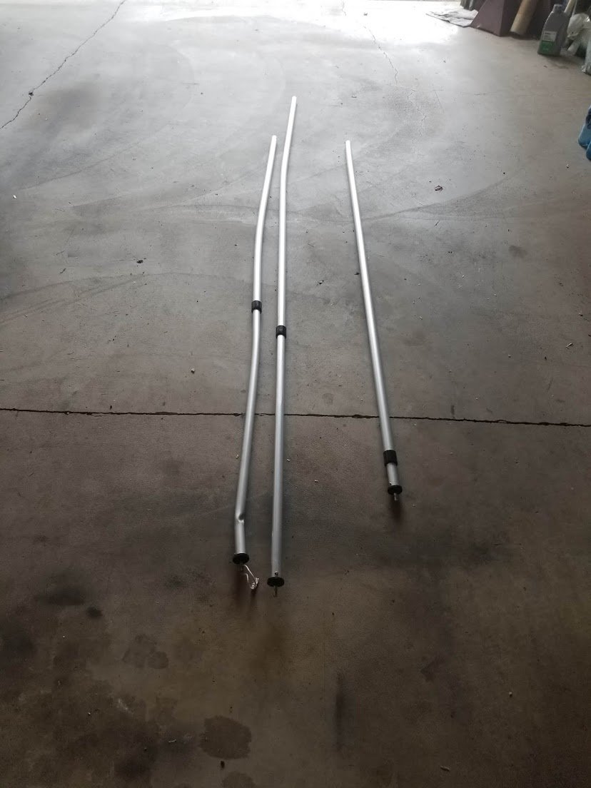

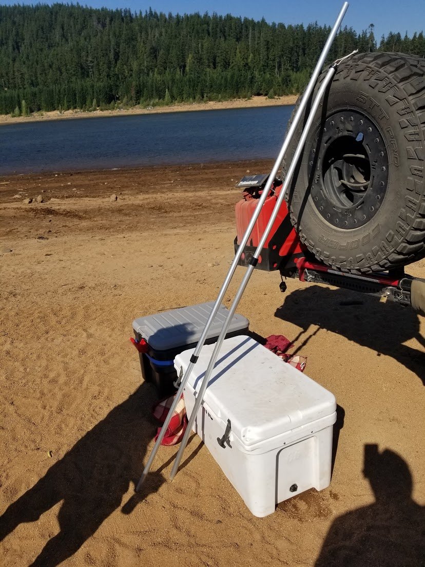

    and the wind took out the awning poles, even with them staked in and tied down with rocks

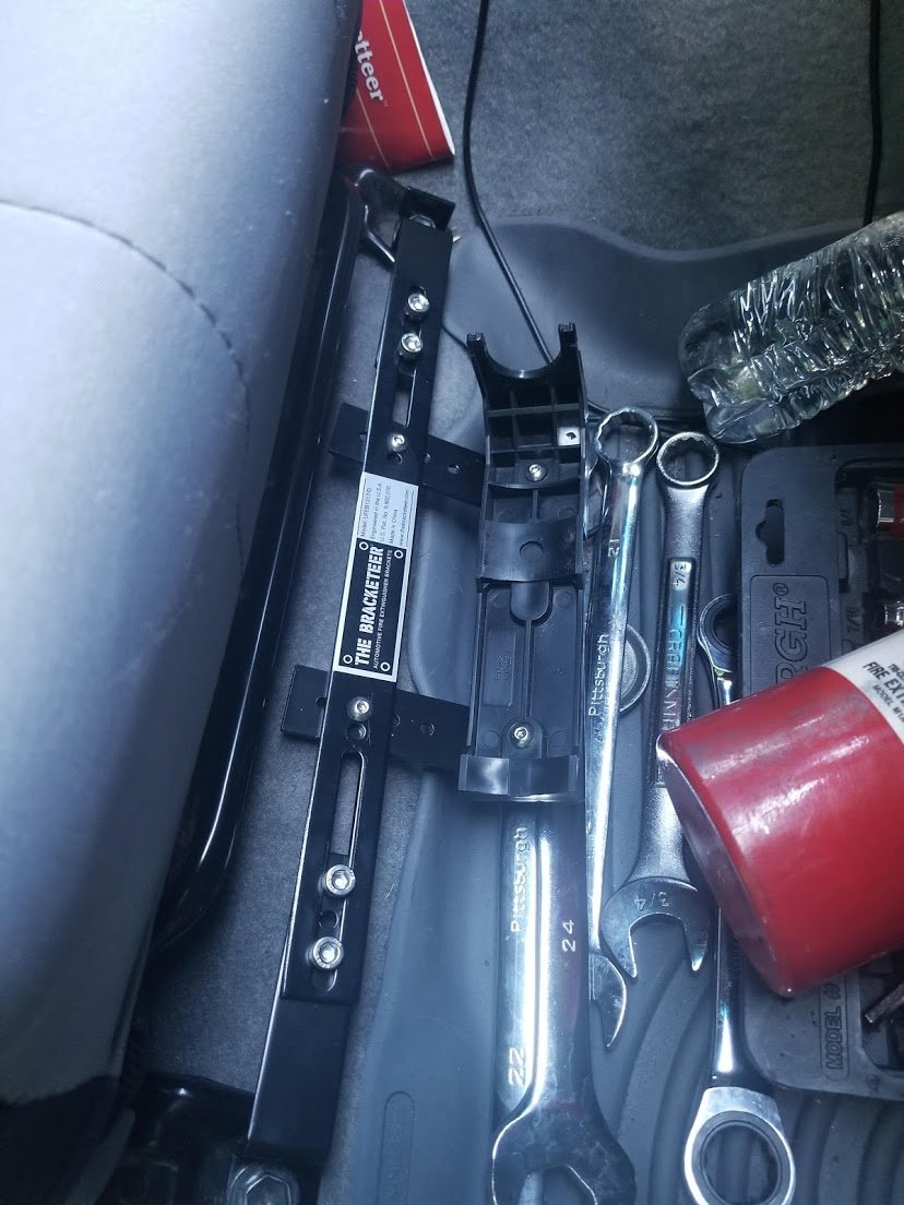

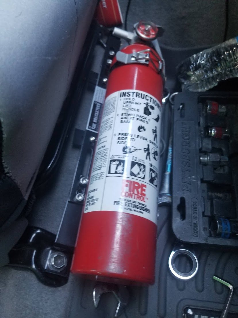

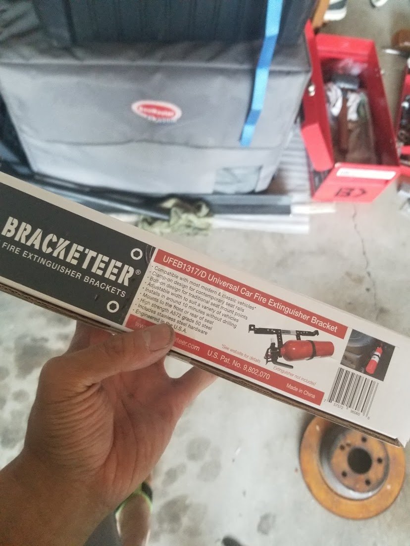

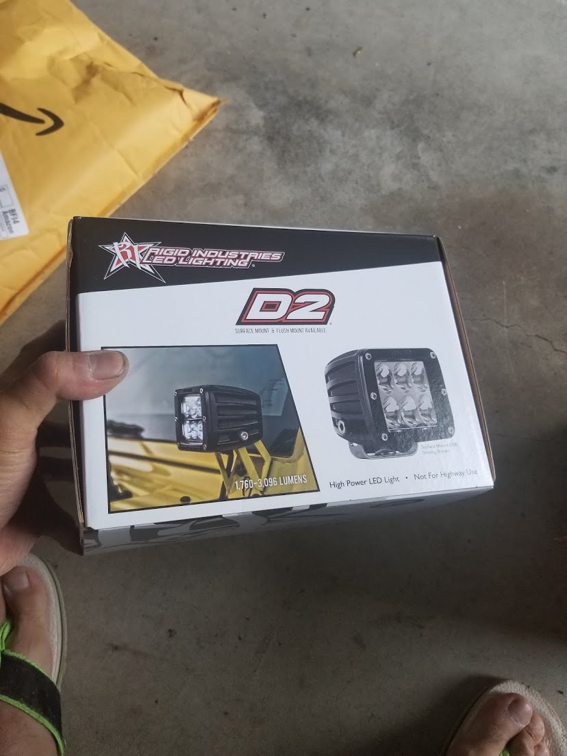

    some mods in the morning

    Well there's your problem. You are tying rocks together

    I have been trying to find a decent place for a fire extinguisher in the cab of the truck versus the one I carry in the back, going to steal this solution.

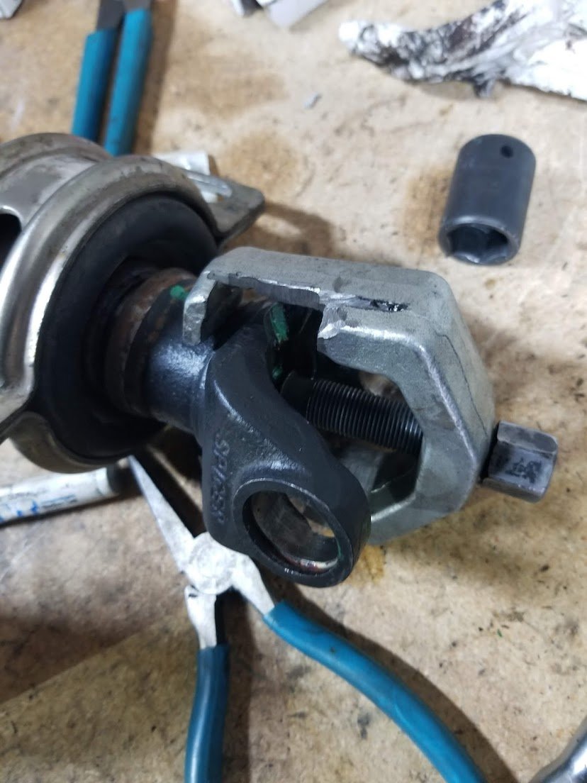

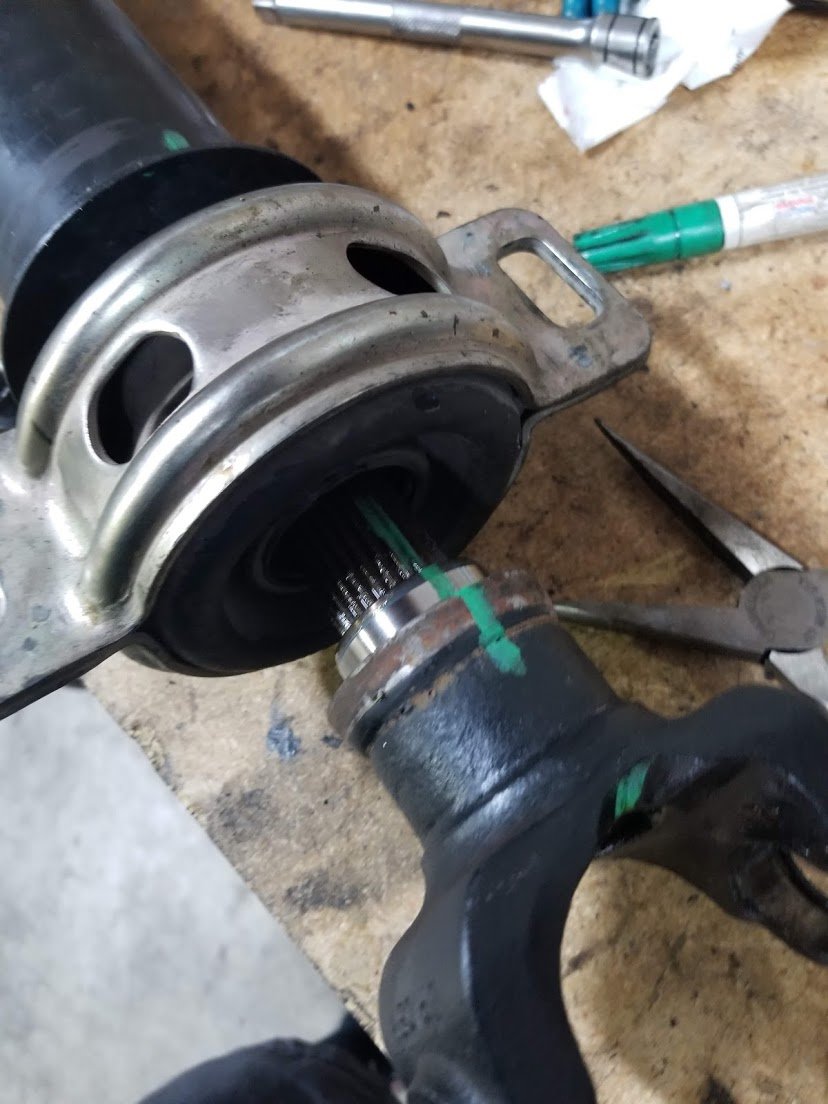

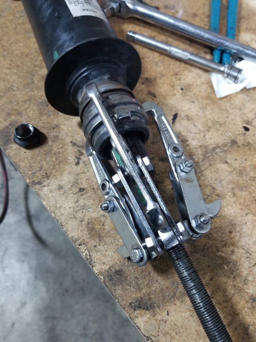

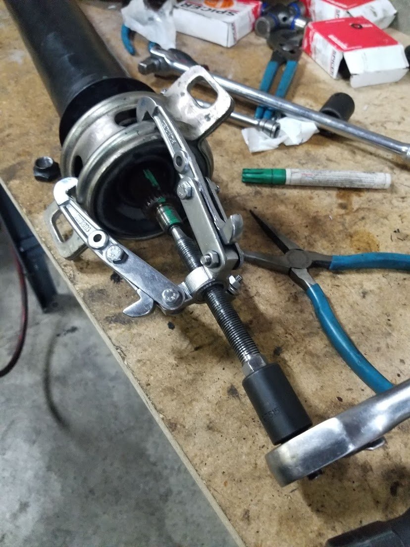

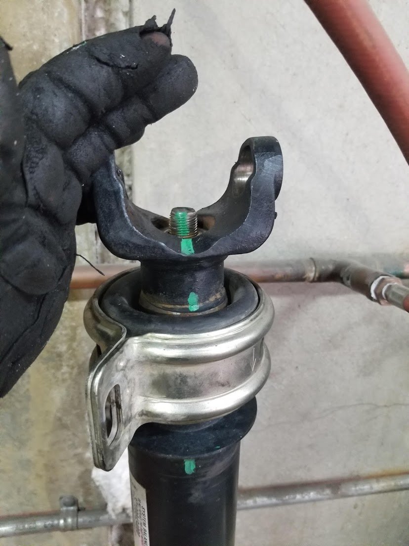

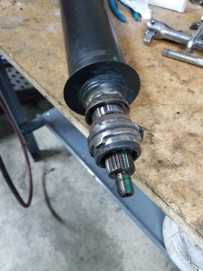

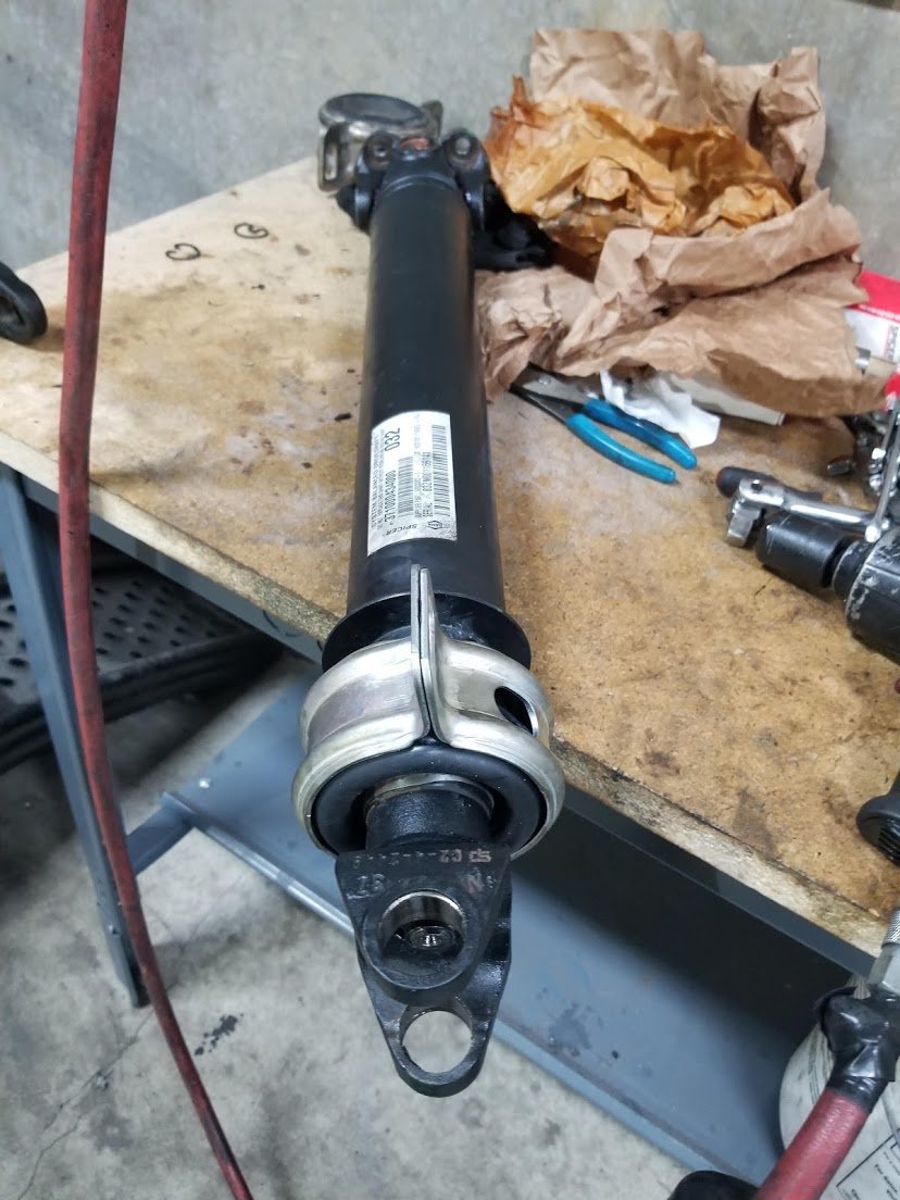

    new u joints and carrier

    You have made me paranoid after you wobbled my carrier around! have looked at all kinds of solutions but I think I will wait till it makes noise or vibrates lol.

    My bearing was fine, rubber was loose and I didn't like that. U joints needed a change, at least the rear one. Truck drives better but I could have stretched it longer, nothing dire.

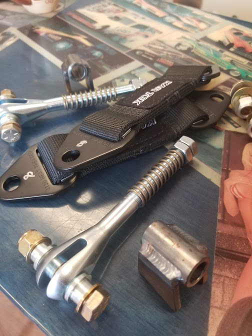

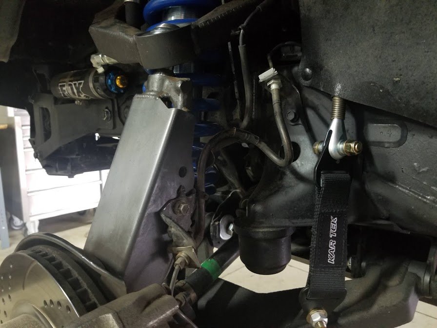

    finally installed the limit straps today.
