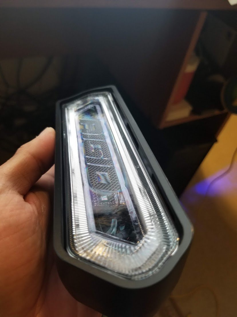

    All stock Superwhite 10' AC
    smoked inner ring

    What are the 3 little LEDs facing down for?

    work light

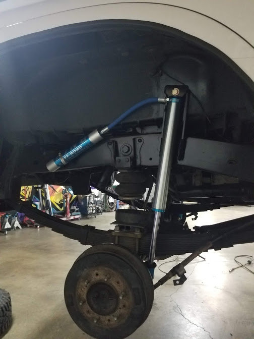

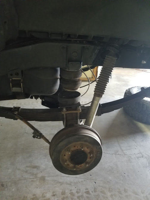

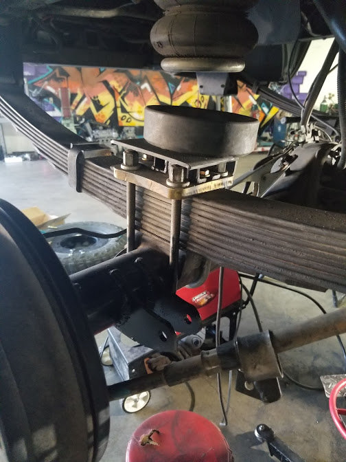

    Rear Bamf Relocate and king smoothies installation
    tools needed:
    lots of patience, lots of cutting wheels, and even more grinding disks
    would i recommend.....no
    before:
    N8Yb6uw1WXCKLguWk9mgCcUKFZbLV39OyjPFoPXi_64465e9ddfb0990f42b5bf71416ace2062d4550b.jpg

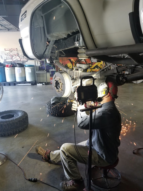

    cut and grind all the annoying welds down
    513WDgC4U_YCOzb84yTJ4h7LhCsl2SesFrF2mk44_8c830132c2a142422f62d13ec0001c1fbf093394.jpg
    use an angle finder and set the tower at 10 degrees and bolt shock until it sits with bracket on axle where shock body is in line with towers

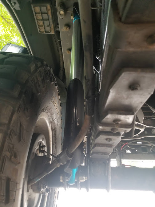

    N5BJbvHQ_kiHkwQzTi_-aJZEUnWzhBcI41-Rql36_c27a5c30e226216a761ea91c4343ddbb2e355d48.jpg

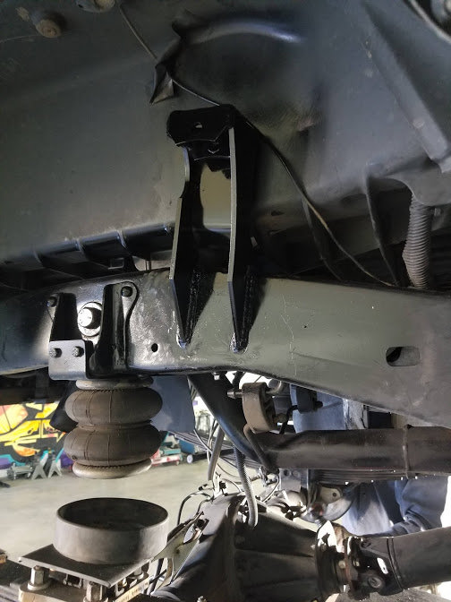

    unbolt and finish welds, did 2-3 passes where i could
    yJ-Scet4BIa9_EtpRfe0vwzzLNiNmyCUGOUVH6vy_b21ac200db8eedadeadc095542138b4f4503bd30.jpg
    aI7BIhgrWJhKRJKkgjVyNgDbHKnPzqpa33pKgvBB_cdd88a31bdf6c8ab5e863c117e6e8738483d9d7a.jpg
    e8tQI5VH5WhxTq-7bFEsGQJ9vko4Huav3FOK56aE_f86ac7ae563ae3fbfedc55f568641fb6c960982a.jpg

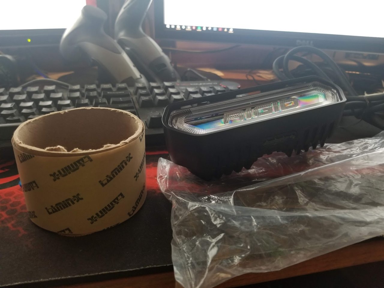

    Rigid Chase light install
    tools:
    wiretaps
    16ga wire
    where to tap on tail light plug:
    red- reverse
    blue- brake
    green- running light
    strobe - wire to separate switch
    work light - wire to separate switch
    OosrZzGyngjweb15XKTg2sI3NaqgLDLHTKPff7eY_7df458c36715be4469a35822327f00b17a66fdae.jpg
    -ykK45WTTZyUJtmRc9k9i7AXnycIgJAtQp4Z7CmG_63ba882e522070b9719745f712cefd0043f4c89d.jpg
    with brakes on
    XK8W7rdgiTKAFECZfPEfVyvGdVvvPmhEJYr0EHb3_7eb414cebdedb8d84e611cbf515cd91cc018b61b.jpg
    running lights
    D9jAxpTujFKDnRXNmTPDcP2MdBgJEe-bZCb4hzjX_a1347e8464776e73a26f2294984ce869c02da300.jpg
    strobe
    https://www.youtube.com/watch?v=qH66ddEcooA&feature=youtu.be
    *work light and reverse light not shown

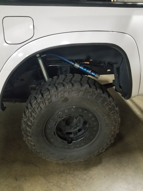

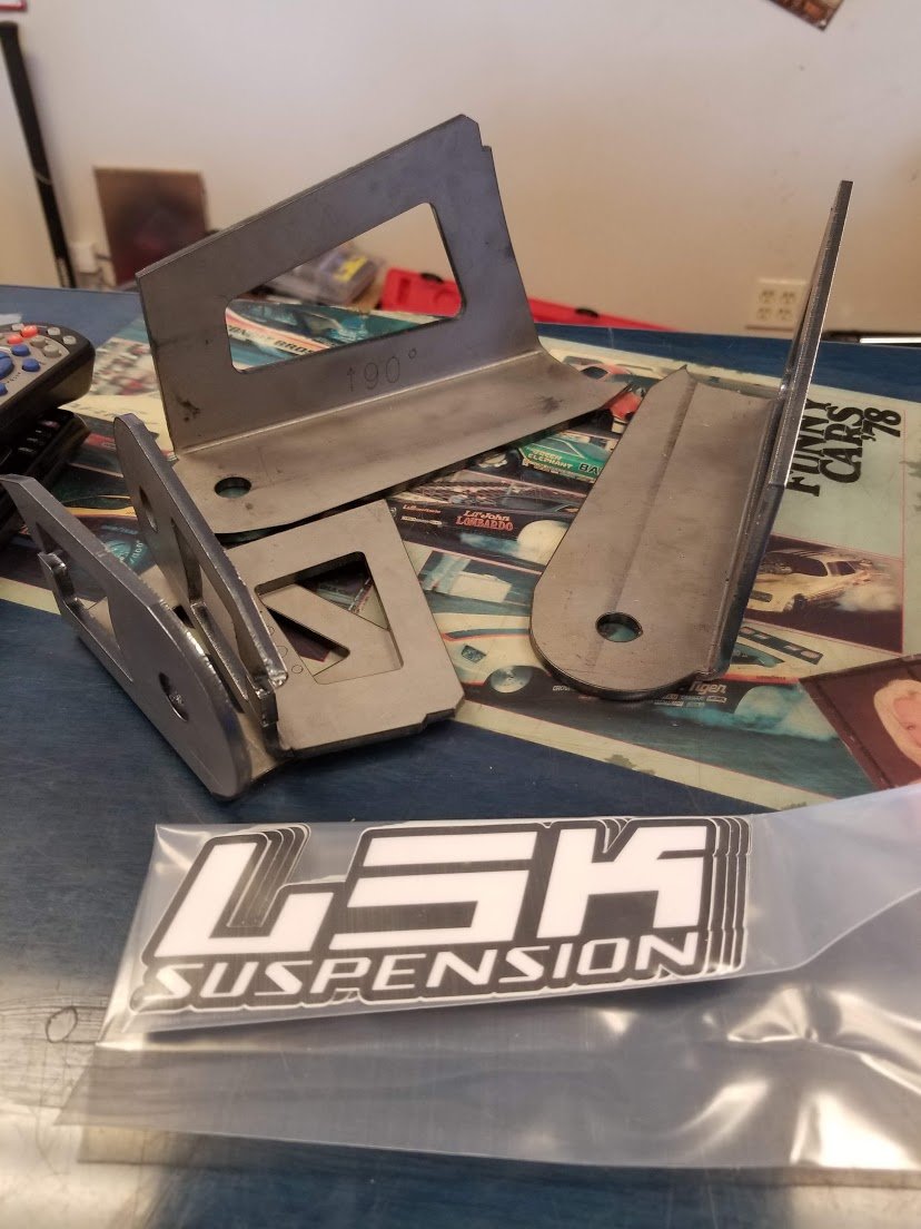

    fox guards on the kings
    wNyGYJgVTx5zAbtm_3TfOoetd7xvp3TU1vojU5Z6_738023b557150d58b3fb1a9273ffb4443e500282.jpg
    ChadsPride likes this.

    Gotta do some shaving to fit but they work. They should have some for your 2.5s but I was sol with the 2.0

    What are those? Shock tower gussets?
  17. Sep 14, 2018 at 5:21 PM
    #1277
    inesshell
    inesshell [OP] blah blah blah
    Aug 2, 2011
    #60986
    7,166
    yep double shear gussets for the shock tower.
