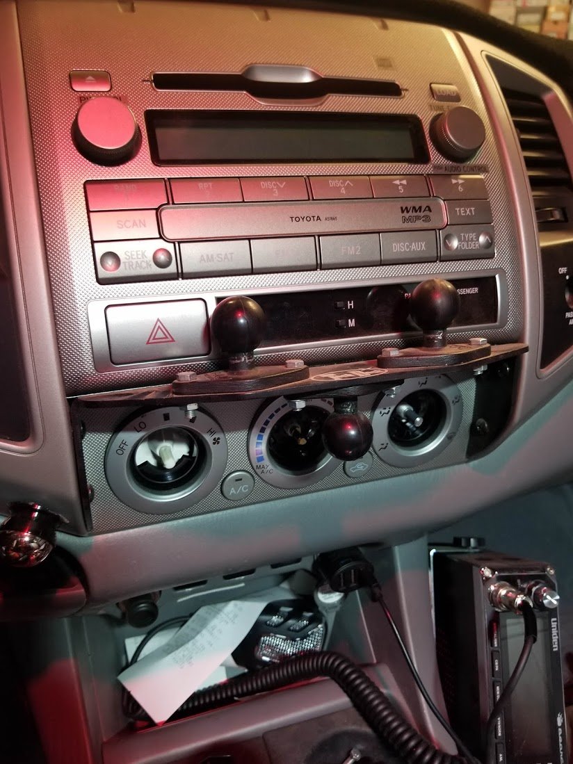

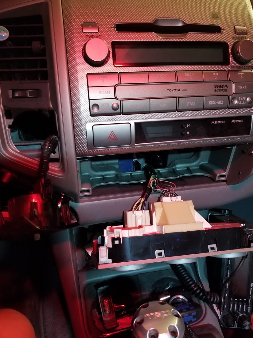

    remove all tech deck stuff to get to ac panel
    6tw17ahT3nn9vqgzypzb6YIJD2zf8m14h26e0EgX_952cfef078cd0e6cd22002d65f90b2de3a0fad25.jpg

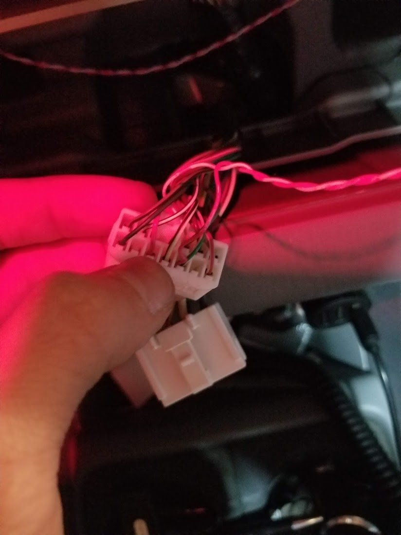

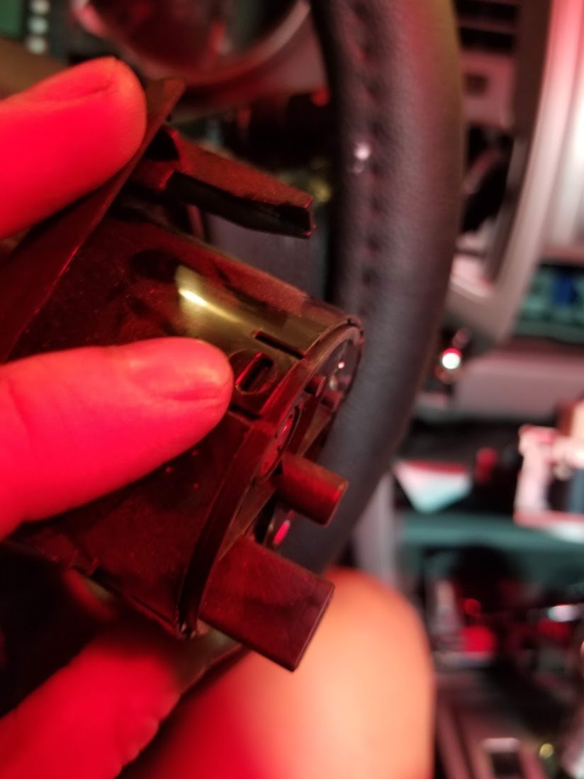

    use a knife to remove panels and disconnect 4x4 switch harness
    eIWzokHPwFzzlMRQTSXbOizZhcx-HWRl_U59tvkk_956ee19302309115b8079486023175e3396ab805.jpgq5M1PGL8rAQNKyoJdSmIvBfmkuFUX-W1JAw-J7r3_7a75acf9eedd0831f0504ef7cadddbd3c6053279.jpg

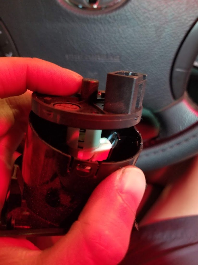

    slide bottom bracket from the 4 pins holding the backing in
    - remove slowly not to pull the switch assembly, detents could go flying

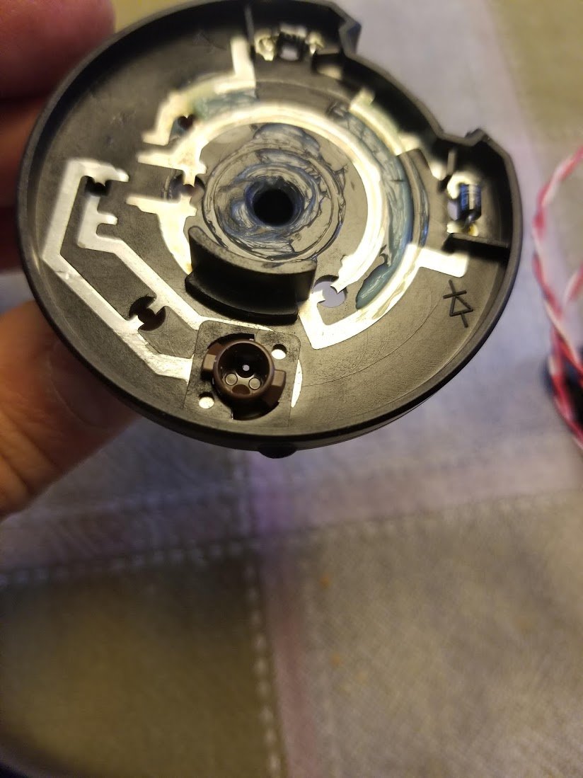

    P0s2KBkWLNtFRbmLZmIMTVJ5YUagl_Hkr1FKJmat_282cb5470773e432ef516f13ba919791bb900d24.jpg
    remove the brown cap for later running the wiring and sodering to the board

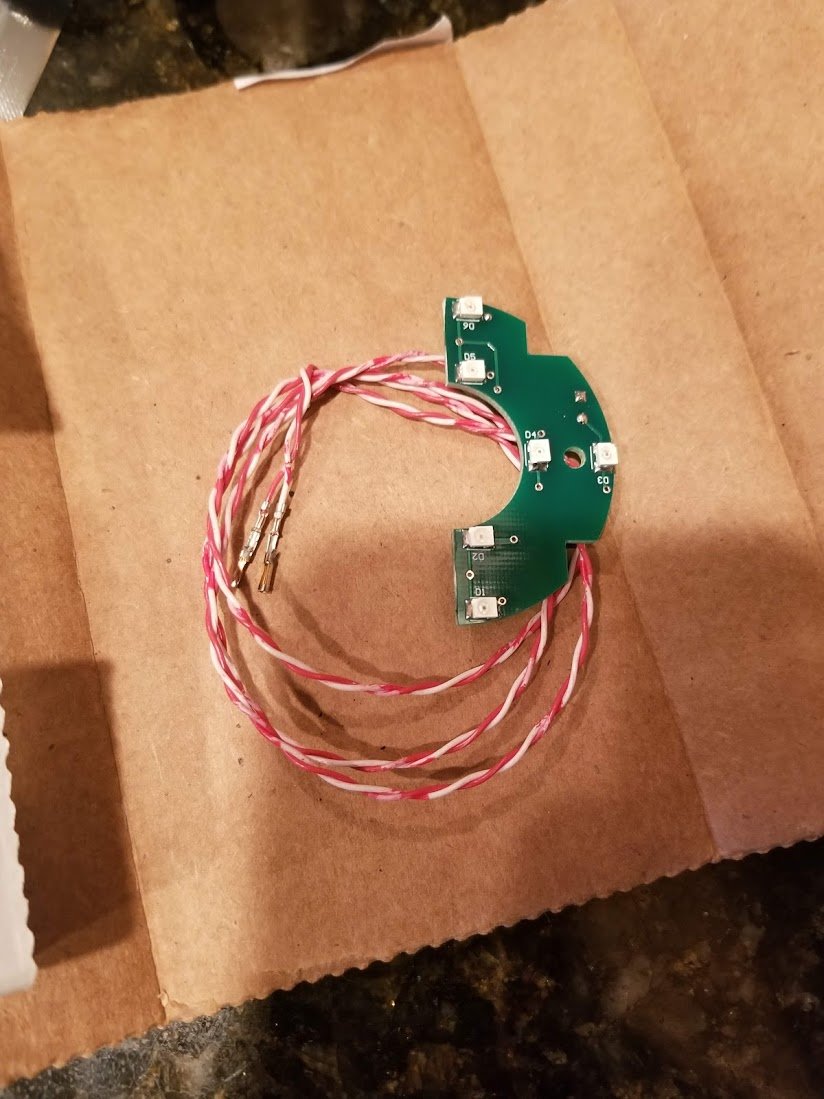

    2ptCtZAE9F3gi7SXms4elabB_qohCc1tI5dbzQns_bafe707a99f8f20c30decb79678af37fb344750b.jpg
    screw the led in place to the faceplate and run the wiring through the earlier board contact plate

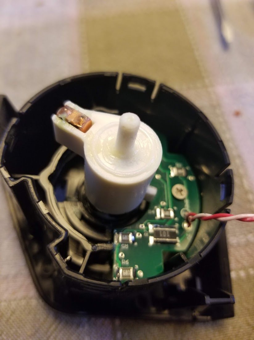

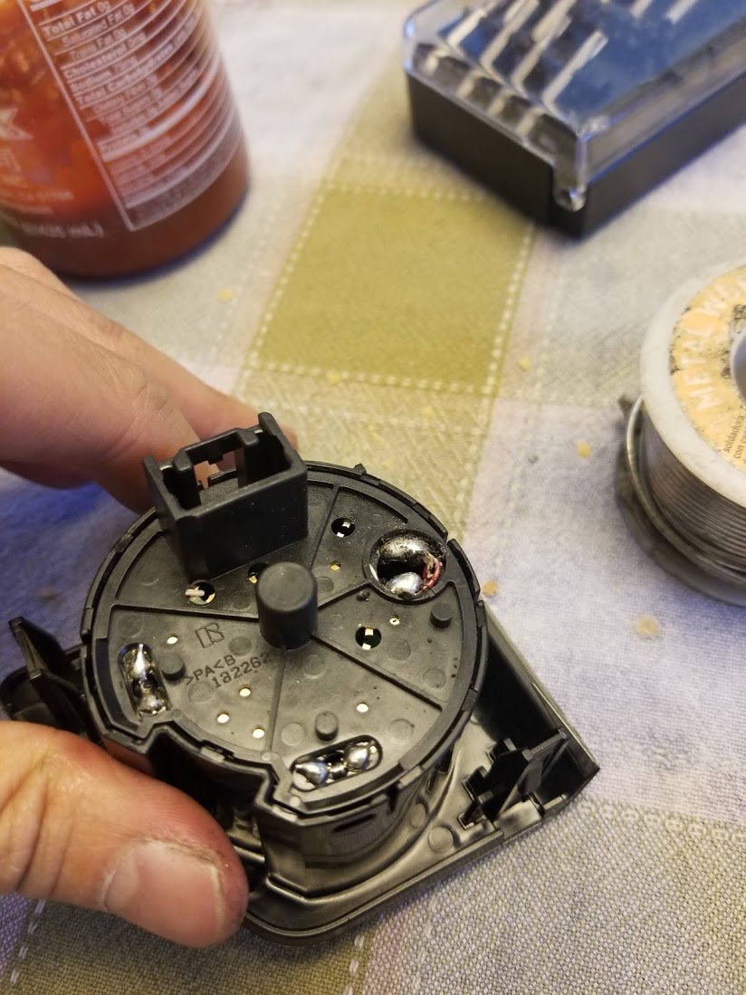

    ifMezErO9_3_XCbFbfmyydENTh08NrEPjbH7hPiA_cd8aa6d7ea4cb45b00291513c570be6f1e0acfeb.jpg
    trim just enough of the board to allow sodering of the wires to the exposed contacts
    - soder the white contacts closest to the harness plug and the red one the furthest away
    ifMezErO9_3_XCbFbfmyydENTh08NrEPjbH7hPiA_cd8aa6d7ea4cb45b00291513c570be6f1e0acfeb.jpgW7DhJ2LjWIHVOIhyTyI2QdKUrnn2w2SyZtX9C16f_1e05b27287c41e159d1979a20901b0dd3b815685.jpg

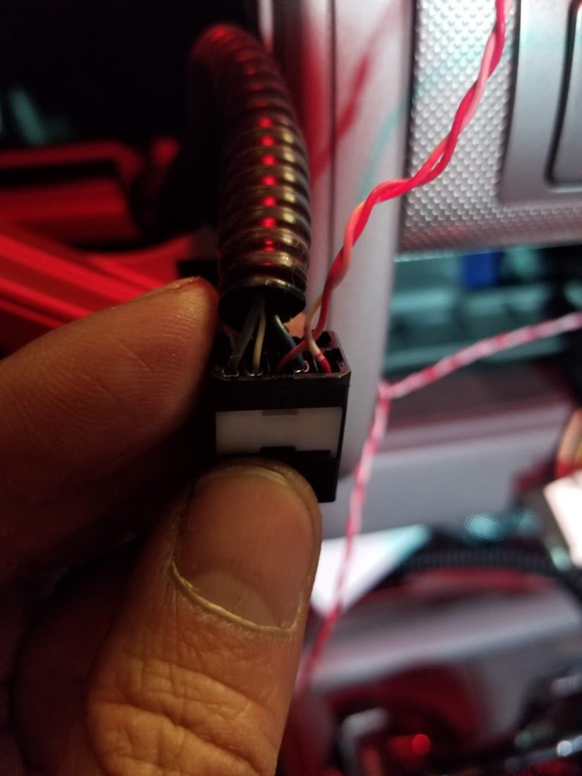

    using the extra supplied wire, slide the terminal ends into the black 4x4 harness, the red one next to the white wire and the white one on the end as shown
    unYFTsiQdYkkYnwIv5yBIIHyzAaVeHuEgIQy4ZOu_906b5de03b461a74e1333cf306e4d5fbb055e85a.jpg
    route the wiring behind the deck plate and through to the ac panel compartment
    - expose the ends of the wiring for the next step
    a5eH-_licifCRT9A-chpdx3mrk2HvUbTZt3FINdL_b1c81199ee2cff9d3d6e57872973066e123cf213.jpg
    i didnt soder for this step, i simply slid the exposed wiring into the terminal end in the plug harness
    - red goes into the green and white wire
    - white goes into the green wire just behind it

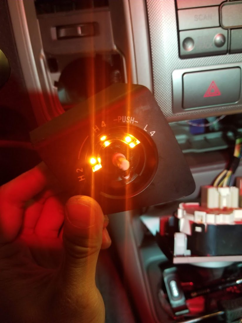

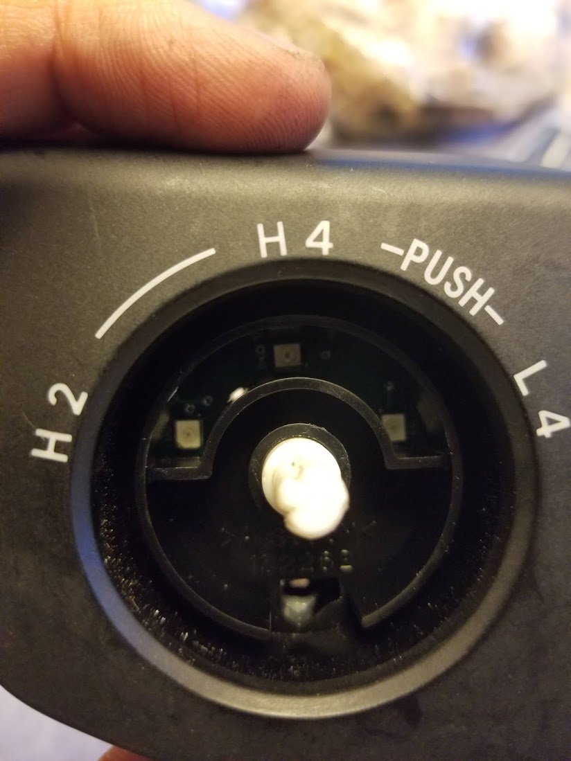

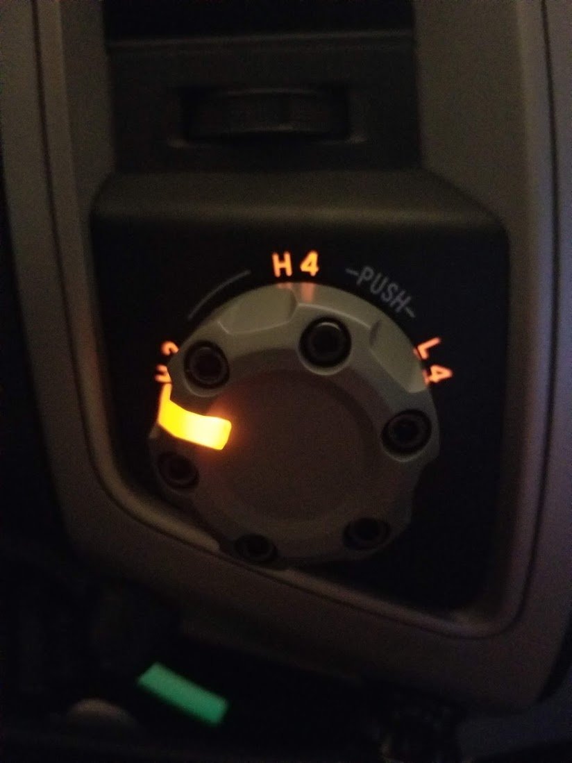

    testing
    9N4hnUjWTgYHlwnpRDPhsXFU-nXcHA0IzFjqnG0q_bfcb0aee21da3aa5b2d8ab1145704a7759d5529a.jpg
    assemble, test, and test 4x4 modes
    nUCrKOOOy2jG8f7RYRjQSgK-odB8Y6Af94FwsGWc_2dd585351f377254a2d035e773161749ed6071cf.jpg

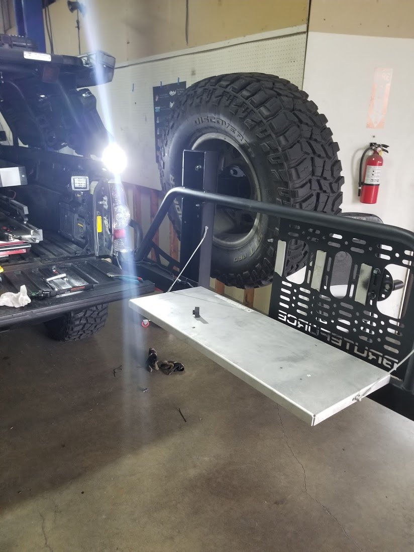

    new swingout table light
    ZWH86FT2xO7-ND7lr4CNjN_7PSFocI6uXbzU4wkW_e68944cd216ff239cf21d78a47b4284033c342f7.jpg

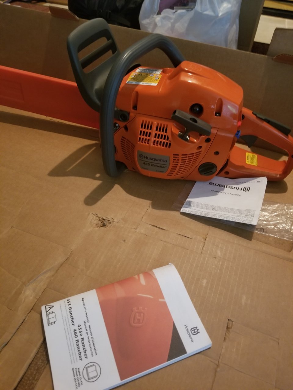

    Mmm truck saw arrived, gassed up and tested if chain gets good flow of oil
