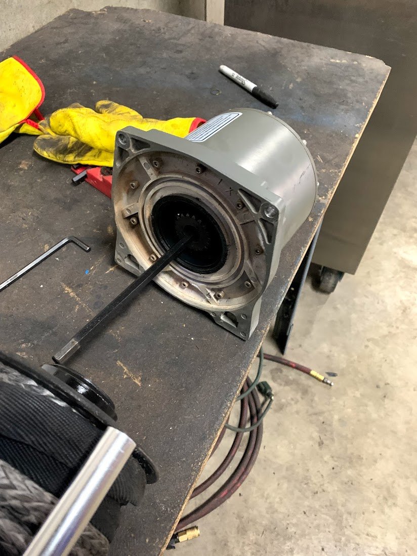

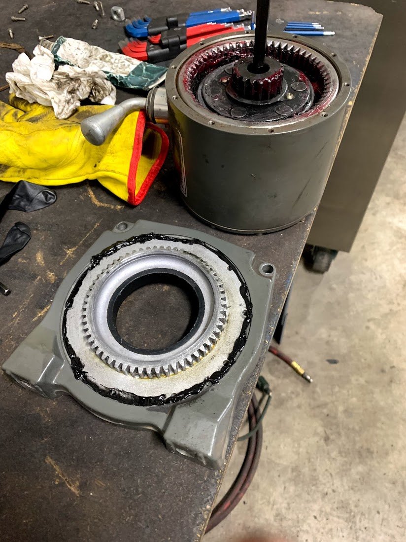

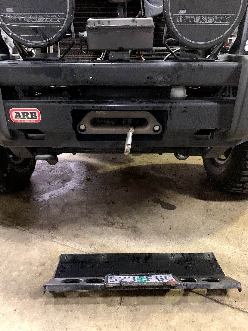

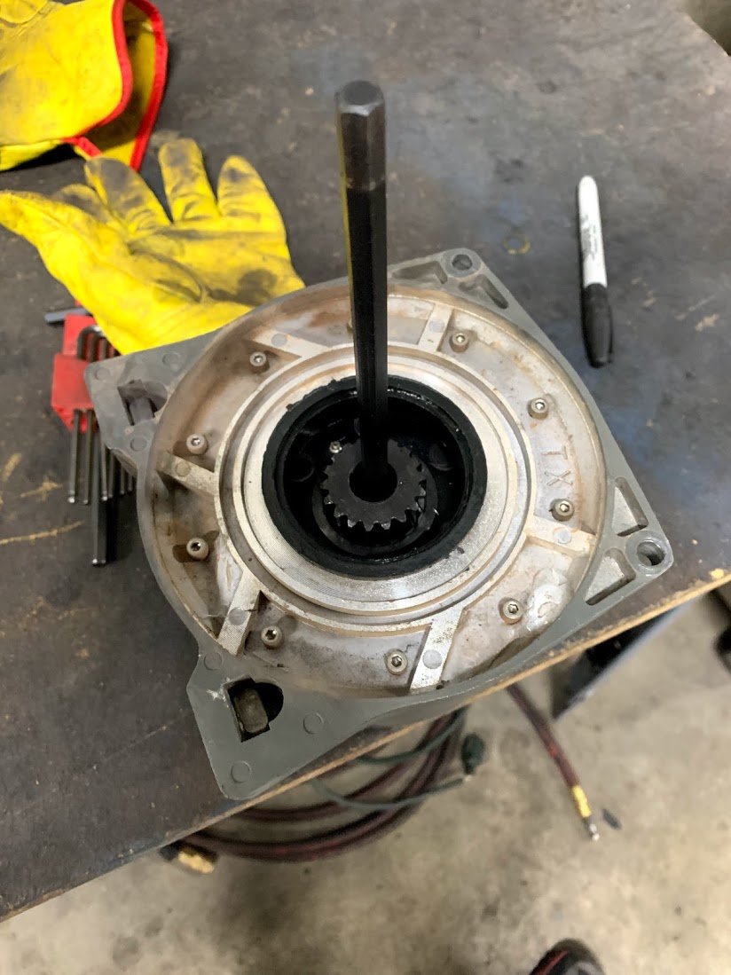

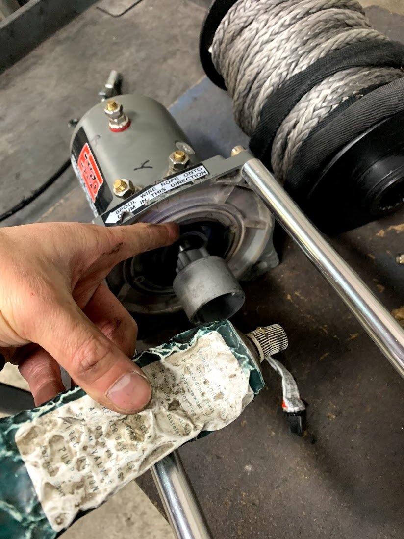

    the unbuild started today @75k miles
    sW4RkncFKcPU-3EMeg9Au_uULEmNRjguGBZaugJY_276ed94af97ed03053116b7ed98bb3c229d95d9a.jpg
    4rcI-Vo-8fhEA8kL3HgbllYfBO5RODhVFLz_uFnG_a2f9b20336035e7a584c65531ffda77ff33947b7.jpg
    _RM9pHVY3q7EQsOKsE0RRP99y8iFfb5Pu9Zq6R5x_46e00bac55b5eaf63546281cf49007715822ae6a.jpg
    h6g7PxIFd2JnkzCwtfuONf5orGZB1A_Jzr2RoNpf_089c2b89f4c687f7fa8f2bad1ecaa708c67da26c.jpg

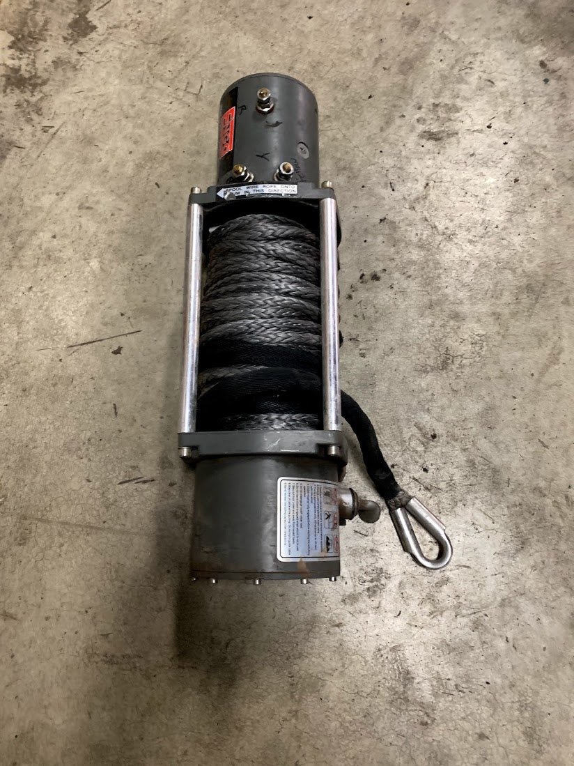

    rebuild/reclock of winch
    U_4bhQUskSoG3d8EmdWNzba5xhWrTwu-GbQ2n2Ya_bf109e8a0e670f5b71e36ba1dc92f7c444782533.jpg
    looks like some spiders have made a nest in the winch
    1LZT87DkCAb6yyBPnCkdjj275tWkKuiuwnQrPR_Z_1682a502fdf4746ae553c0dcca81a5681e3d5f1c.jpg

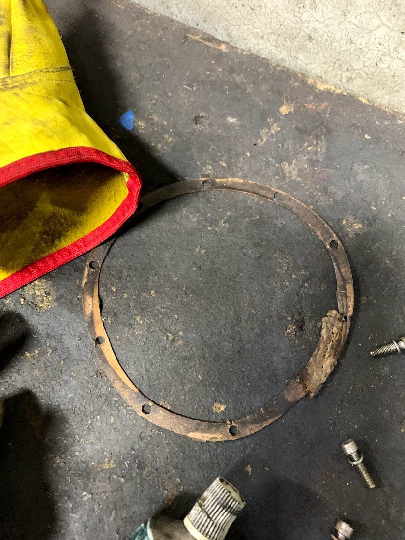

    the gasket failed on one side as shown
    bu5SWjI359owYwvBfUiLU16e9gFIXDdBnXZfqw0f_2b1d7f963d457d342ead5fafd5a61c90d9296d78.jpg

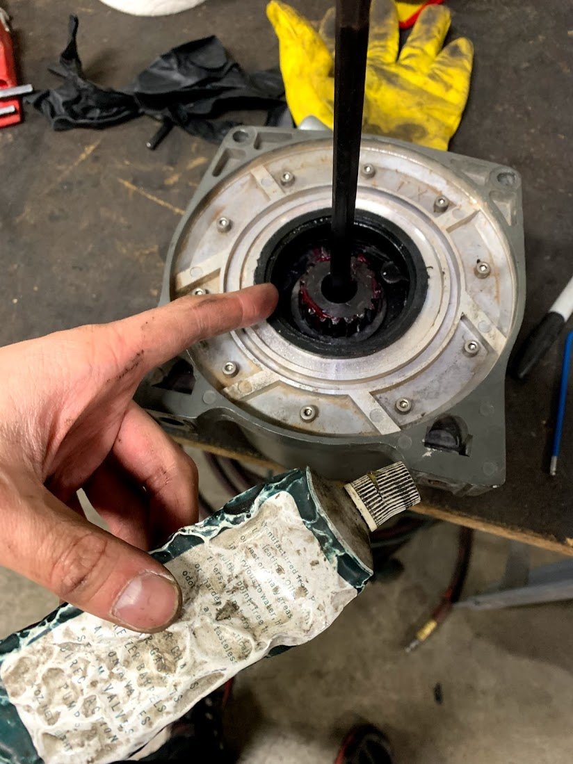

    dissembled the gears (not pictured) and greased, used rtv instead of new gasket
    IXmC6PmYMO7TrTapblnsEMnTCS-RRjHB4-TyXhxV_3f14e46f5d6ffedb3eb7bde5b1e81451a0598ad5.jpg
    oring grease on the seals
    pf5zwi53TM9I8TH27aKGfegrkJatJvDl-oJlrByl_1f333a835c9dd463098ddef82b16cf47383a1b4e.jpg
    motor side as well
    PVjDvNYIoKBBWYYP-8jA-X52-Pq-SVDWRBYkdxMi_e0436bb826d65bfd30a72571a5848775dd5a1537.jpg

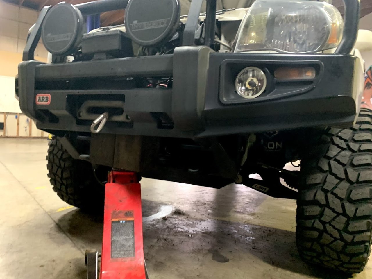

    the unbuild
    RQxPlHX983ZkkT04VQHKsWsGlgQS8iCEeXZ4yKa1_0d3bb9a8730ac335122251a51e4f50f8b2e6500c.jpg
