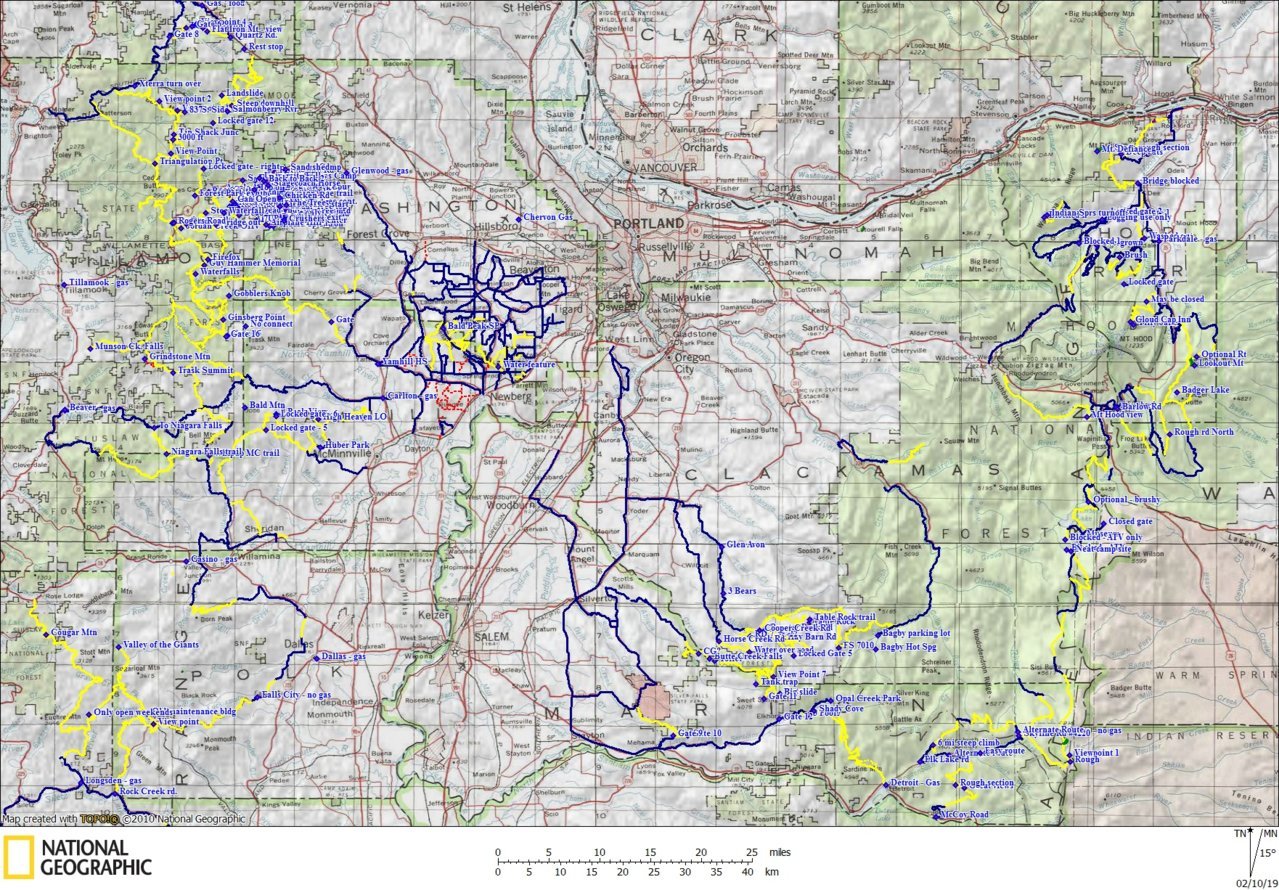

    You're not trying hard enough. :boink: This is probably single digit percent (yellow = dirt/gravel) of what is in our immediate area.

    Ken ill soon be a washington resident lol, just bought a nice piece of land on a delta by the columbia in longviewish area

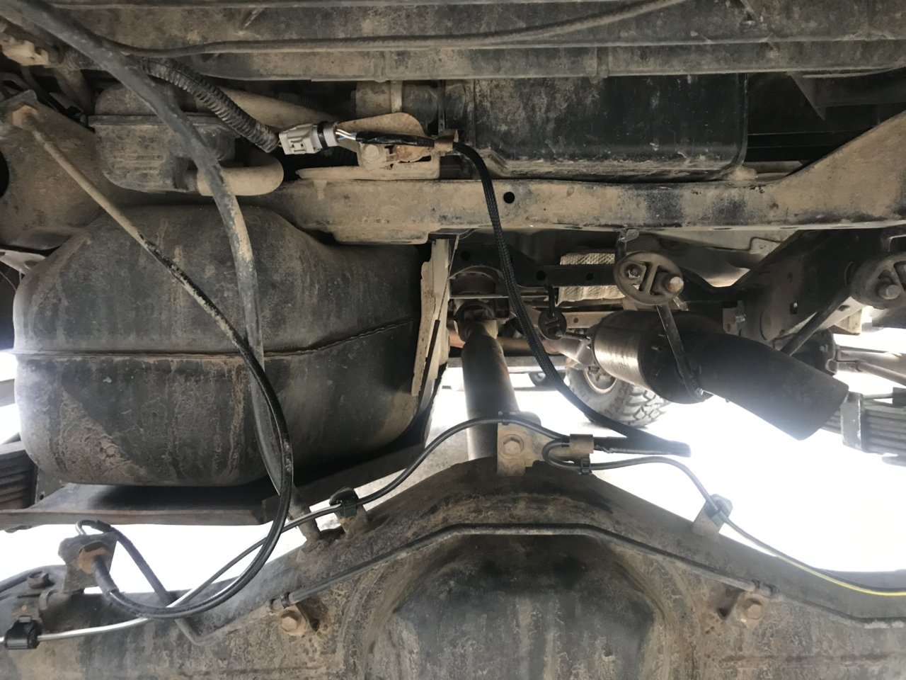

    Is that telephone wire?
    inesshell[OP] and fatfurious2 like this.

    Some CAT5 cable, so computer wire. Worked perfectly for what I needed it for, extending the rear abs harness.

    I tore my OEM harness, so I bought an aftermarket one, cut it in the middle, added about 5” of wiring and buttoned it all up. Requires cutting, stripping and soldering.
    Only reason I did it is when the truck is on a 2 post lift and the whole axle can droop, the wiring is tight. I have a relocate and 12” shocks on the way so it’s only gonna get tighter
