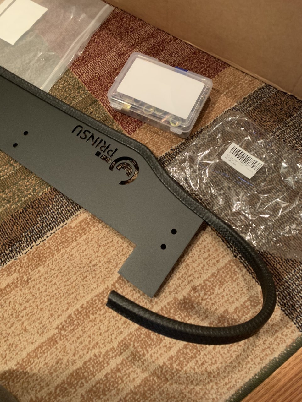

    Is it regular ol fender trim? If it doesn’t help with wind noise I recommend this. Seals nicely against the roof and makes a big difference.
    Door Rubber Seal Horizontal Bulb Extrusion 0.62" Bulb Height x 0.039"-0.137" Grip Range x 0.53 U Height (5 Feet) https://www.amazon.com/dp/B01ANO6RVI/ref=cm_sw_r_cp_api_i_pZlCCb8DKK49V

    Yep, drilling near the rear airbags sucked but finally done, everything is deadened with kilmat.
    Want to thank venture overland Co for hooking me up with the prinsu

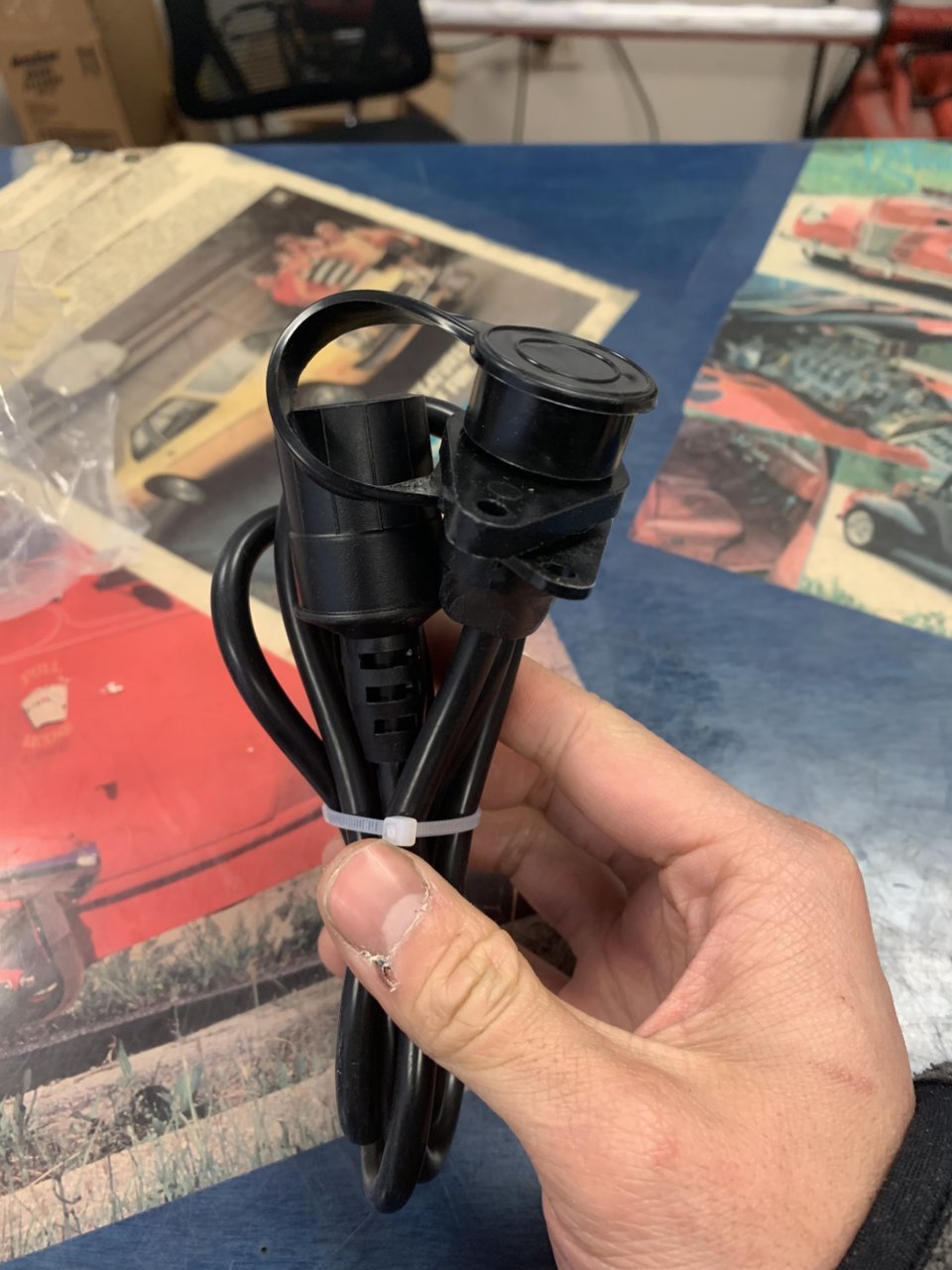

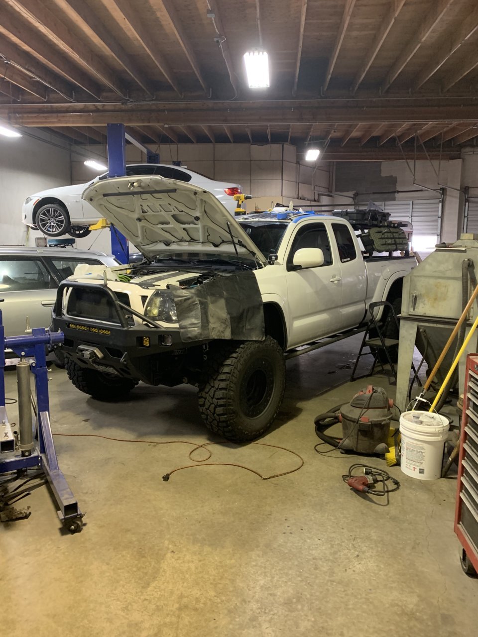

    Interested to see this one. A while back I had toyed with doing a project with that same harness and mounting it in the grille or somewhere else on the front of the truck. The only problem I can see is I think it's a similar problem to the wireless controller from Warn - the connection into the solenoid box isn't sealed, so they don't recommend you leave it permanently connected. So if you're planning to use the winch, I think you still have to open the hood or reach up under the bumper to get access to the solenoid and plug in the harness, right?

    reason for the extension is to not open my hood to get to my solenoid, this one extended the plug to the front bumper, takes away one less step

    Where is your solenoid? You can't just reach in those side access holes and plug it in? That's what I do but my solenoid is above the motor on the winch.

    Mine is next to my headlight, I would have to do some fumbling around in the bumper cutouts to fish for the connector

    Wanted the box away from any opening in the bumper since the last time I opened it up before sealing, there was a huge pool of water lol. This was the downside of having an external mounted box....water would make its way in every crack it can
