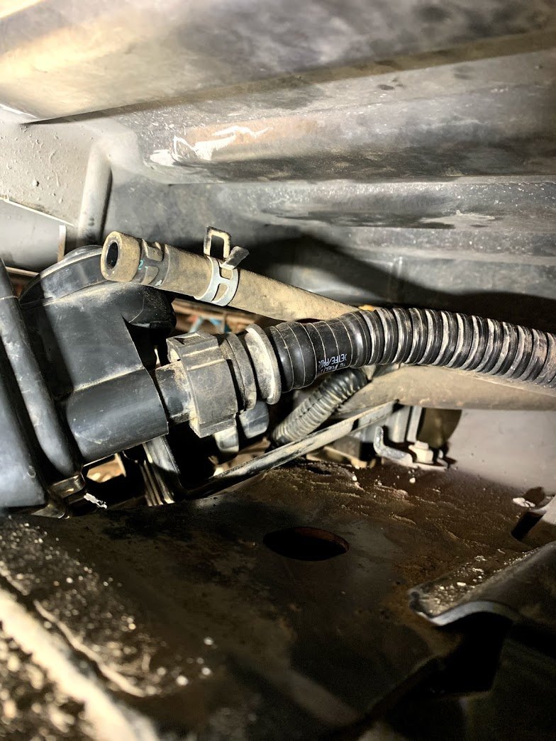

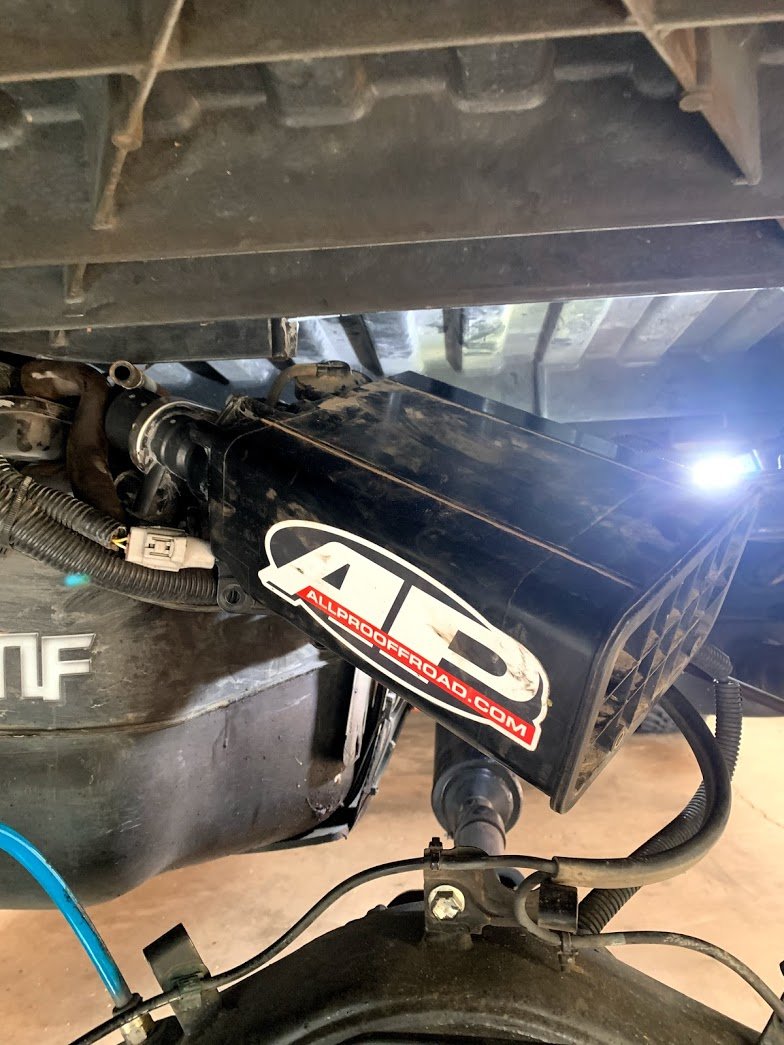

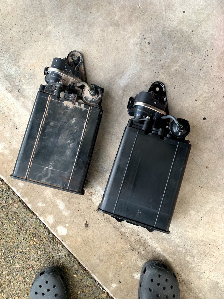

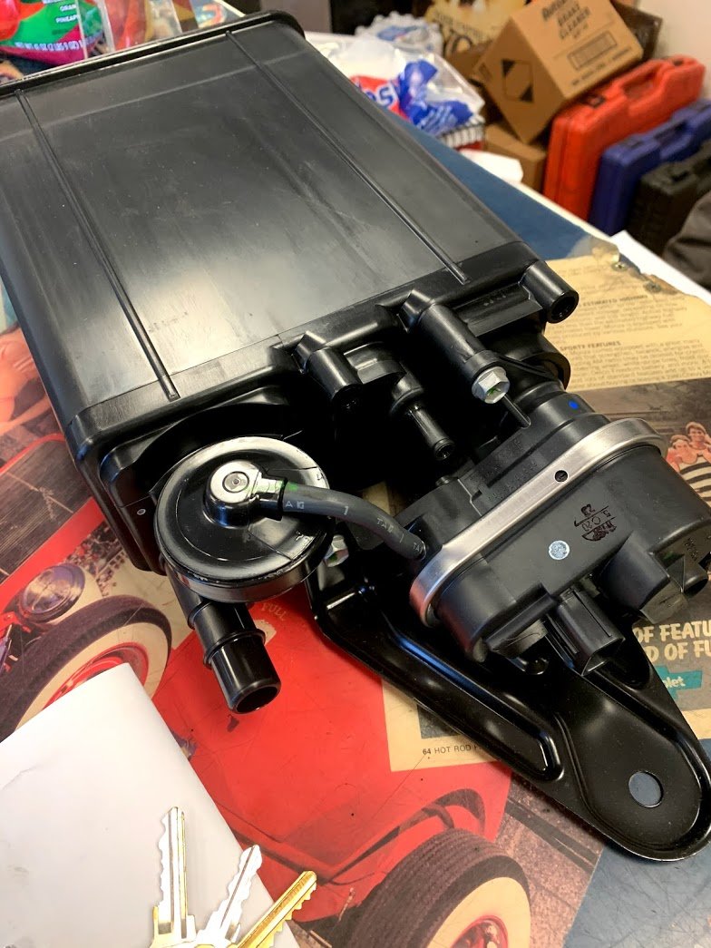

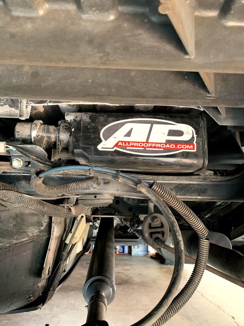

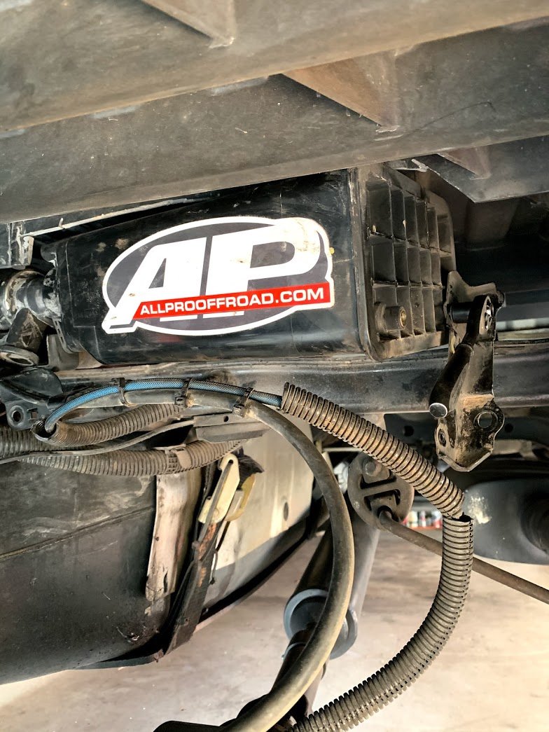

    replaced the fuel tank evap canister and sensor today:
    Ive been throwing the 5 code combo for a year now but only on really cold mornings, decided it was time to replace it.
    Part number is 77740-04020, ran me a little over $200
    dWGvdCexNjw92dnilgAVnie7feCYKeFvtRBssTXe_dd1d4b718aeb96a53619cce1fe816adbcf3c62b4.jpgBzEs6NYLO2tXZ6n0ZceZTcMhiTkh4ZhnK_jESv2o_d74e31e5465259d08a697329aca4dbc0587d75af.jpg
    Normal way to install these is to lift the bed off or drop the tank but I was going to have none of that considering all the wiring I have into this thing....
    I notched just a bit of the bed rib to wiggle it out, nothing to worry about
    ytAXzEngFTL6HJTgdkRt4lnmMdWe_nwvFveZznnA_ce9f5c7466dc9fb25ae9b21ed55e47601118f45d.jpg
    LZ6vy6fJKdAgd117Bgn2Eu2jfHaJhrWFhiTd6Gy5_075bd055026f87652d9605b41995bdf6af200dae.jpg
    4 12mm bolts removed, 1 electrical plug, 1 vapor hose, 2 hoses (1 with pinch clamp)
    the biggest pita connector is the one on the very back, dual pinch vapor hose -- it took a lot of pinching power to get this to budge.
    Xq52RA6sl5HfRmvEpZ4F-Bc5Dw-yjX9JlPI-UJwX_43d4016b92fa27d0f40453f42166c55591ce211f.jpg
    RxKNfclRvN9xb9TIMaHP1iCvXVIRBek3WoaC-Lkv_e363667f43d1a76d74d7c72a9a6bed6409f5a2cf.jpg
    _0ZJcnCBUimakb13xg3bpTKsGQjEMh3UaGog336E_da651b5275099248d7594d2f2532275e37b95cfc.jpg
    lets see how this goes moving forward.

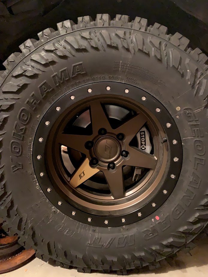

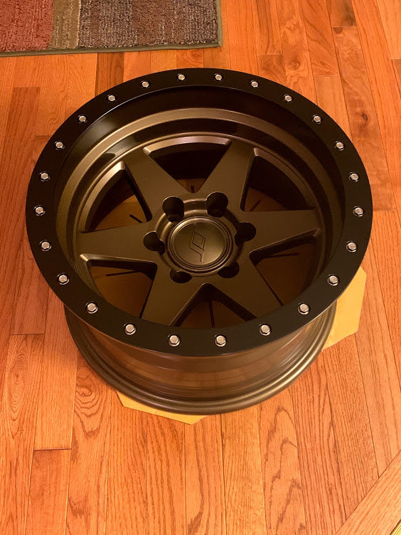

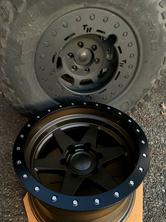

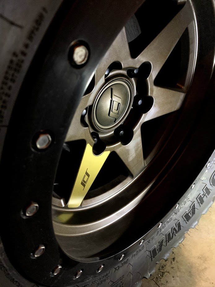

    Any particular reason for swapping from the TR beadlocks? I’m looking at getting some of the BeadLOOK version I love the bulletproof look of the rock ring.
  18. Jul 21, 2021 at 1:23 PM
    #1958
    fatfurious2
    Jun 28, 2014
    #132884
    49,631
    David
    Ashburn, VA
    2010 TRD OR Access Cab
    my guess would be weight
    inesshell[OP] likes this.
  19. Jul 21, 2021 at 3:26 PM
    #1959
    inesshell
    inesshell [OP] blah blah blah
    Aug 2, 2011
    #60986
    7,166
    All stock Superwhite 10' AC
    i gained back 4 mpg for dropping rotating mass and i dont wheel as much as i use to that would justify running real beadlocks
    RoaminRoman likes this.
  20. Jul 22, 2021 at 10:12 AM
    #1960
    OverlAnderson
    OverlAnderson A dude playing a dude disguised as another dude
    Sep 23, 2017
    #230862
    2,126
    Anderson
    San Antonio, Tx
    14 TRDS DCSB 4X4
    stuff and things
    i honestly am in it for the look i wouldnt get true beadlocks, just the TR look alikes. i dont wheel hard enough or often enough for beadlocks myself (min 15PSI airdown). any complaints with them? would you have kept them if they were the beadLOOK and not beadLOCK? also with the 3.5" back space that was enough to clear the stoptechs?
