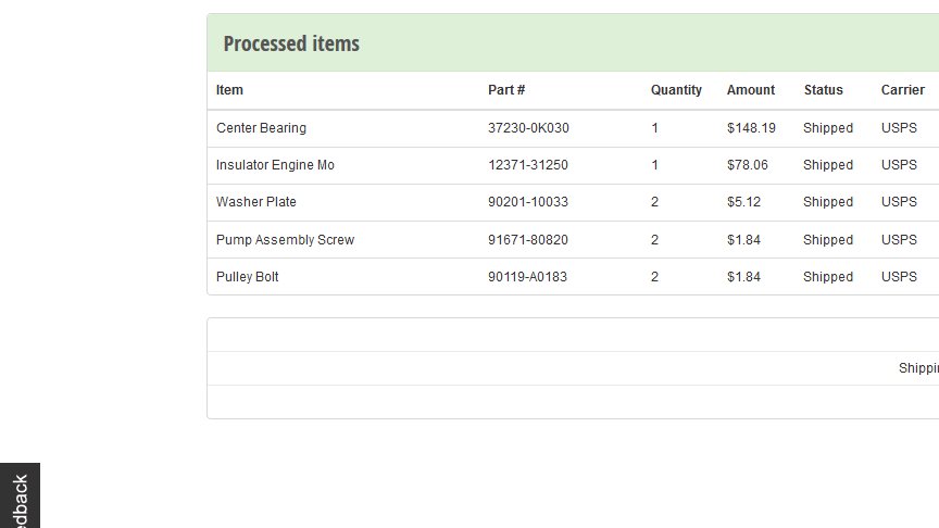

    Heck no, I bought the parts, Toyota rear mount and center support from Amazon and had Driveline Service of N Atlanta do the work. Do you want part numbers?

    Here's the list of parts that I used, center bearing and parts for the trans mount with bolts and washers for the new mount.
