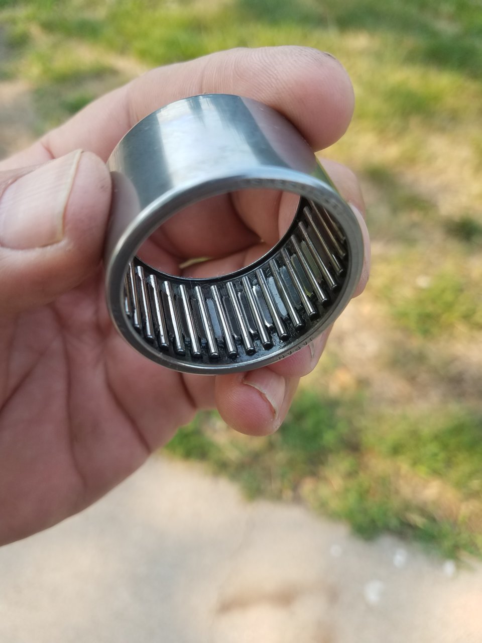

    In the front differential on the driver side is a needle bearing like this. I replaced it with the bushing at 100k miles, 40k miles lifted.
