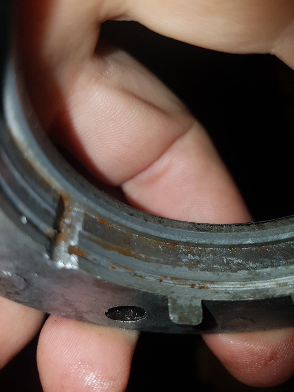

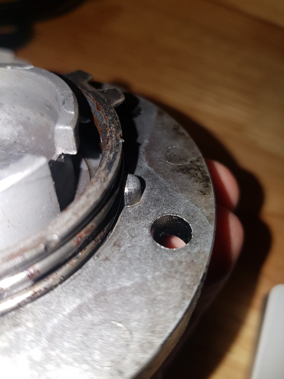

    Torque damage from shifting to 4wd on the fly? If the ADD can't find em let the hubs grind em. Jeep Quadratrac Tcases had a cone in cone limited slip that ate hub dogs, shattered springs and blew off hubs when shifted into full lock 4x4 on the fly.

    If I had ADD, maybe? I lock my manual hubs before I leave the house. This was clearly corrosion from leaky seals.
    EDIT: If locked hubs couldn't take whatever shock might be present from shifting, they certainly wouldn't hold up to wheeling.

    It is possible someone tossed the hubs together with the spring backwards, this makes the hubs not extend to lock in. That being said, my bet is it is a vacuum problem.

    Correct
    Another thing I have had the springs break in the hubs.
    Another one is way to much grease that things can`t move

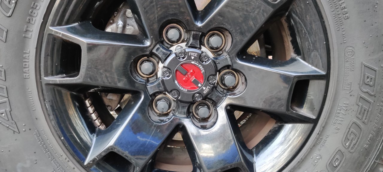

    Ughh, I had to admit that it does appear to be the light not working in the dash. I did replace the bulbs with LEDs and apparently I got this one reversed.
    To be fair, this was intended to be a reference-finding post, not a diagnose and suggest type of thing.
    Since I don't have a way to get all 4 wheels off the ground, the best I could do was drive and look for signs of 4wd being active. I haven't used 4wd for quite a while because the hub dial was so hard to turn before I replaced those o-rings this weekend. The steering definitely feels stiffer, but I couldn't tell if that was just placebo. So the best way I could tell is by trying to spin out in the thick gravel in my driveway. Delivery drivers have gotten stuck, and any pickup without weight in the bed will slip. I couldn't get the wheels to spin even when flooring it, so I guess it works afterall.
