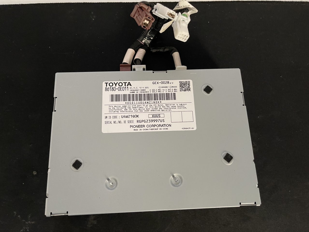

    Hi Tacoma World! It has been a few years since I have been on the forum, but now I have questions and need help desperately! I signed a contract Friday on a 2019 SR, was told multiple times it had satellite radio capability(even 5 minutes before I wrote the check), so Sat. morning before going to pick up the "new truck to me", I contacted Sirius XM to move my service from my old 2009 Tacoma to the 2019 SR, only to find out it didn't have satellite capability after entering the 2019 VIN. This was a deal breaker to me, but since I did sign all the purchase paperwork, paid them for the truck in full yet did not take possession of it yet since they had to clean it up first, now they will NOT let me out of the deal. They say the truck is mine, even though the salesman told me it had satellite capability which it DOES NOT, that is not on the contract, so they will NOT rescind the deal and return my money paid them in full.
    Not to get into a longer story here, my 2009 SR5 Tacoma had the roof fin just like this 2019, but didn't have the XM receiver, so I bought that small box and the wiring pigtail, easily installed it right onto the 09 wiring harness already there, no adapters needed at all, and quickly had satellite capability.
    So...now I am HOPING I can do the same thing with this 2019, so here comes the questions. I tried searching here on this forum this morning first, found some info helpful, but NOT exactly answers to all my questions. With it being Sat. yesterday and today obviously Sun., places like Toyota Parts Online or Toyota Parts Deal were closed - only open M-F.
    Well...from what I think I can tell after hours and hours searching all over the internet, there are possibly two satellite receiver "boxes" from Toyota I can add to get satellite capability which I believe attach to the underside of the plain 2019 SR radio - part#86180-0E021 and/or 86180-0E011? It appears either one should work? Of course I would need the Toyota harness which I believe to be part #86842-0E101 and it simply plugs from the receiver into the plain radio, so no adapters needed whatsoever? After install, I think it is simply plug/play with the plain 2019 SR radio screen now showing all the XM features just as if it was a Tacoma that had original satellite capability from the factory? I do not know if this add on receiver is how they do it for ALL Tacoma radios that have satellite capability?
    It would be AWESOME if someone could confirm this and these part numbers??? Obviously, you can buy these parts new(pretty high in price) or there is a used market for them too to select from.
    I am REALLY in a bad spot right now - can't rescind the truck deal/contract and don't know if this info above is correct or not, so EXPERT knowledge here is crucial! Can ANYONE help me here??? Would prefer if possible to answer my questions here instead of pointing me to possible multiple related threads I haven't found yet. It would also be AWESOME if anyone had either written instructions and/or a video to accomplish this if possible? Just like on my 2009, I will probably be attempting this myself since a dealer would want hundreds in labor costs more than likely. Lastly, I realize there are aftermarket non Toyota products to add satellite capability, but I prefer only Toyota parts. MUCH Thanks in advance!!! Walt

    TheCochese
    Much Thanks for that pic!!! If I could just ascertain if those part numbers would work/connect on this 2019 SR current radio???
