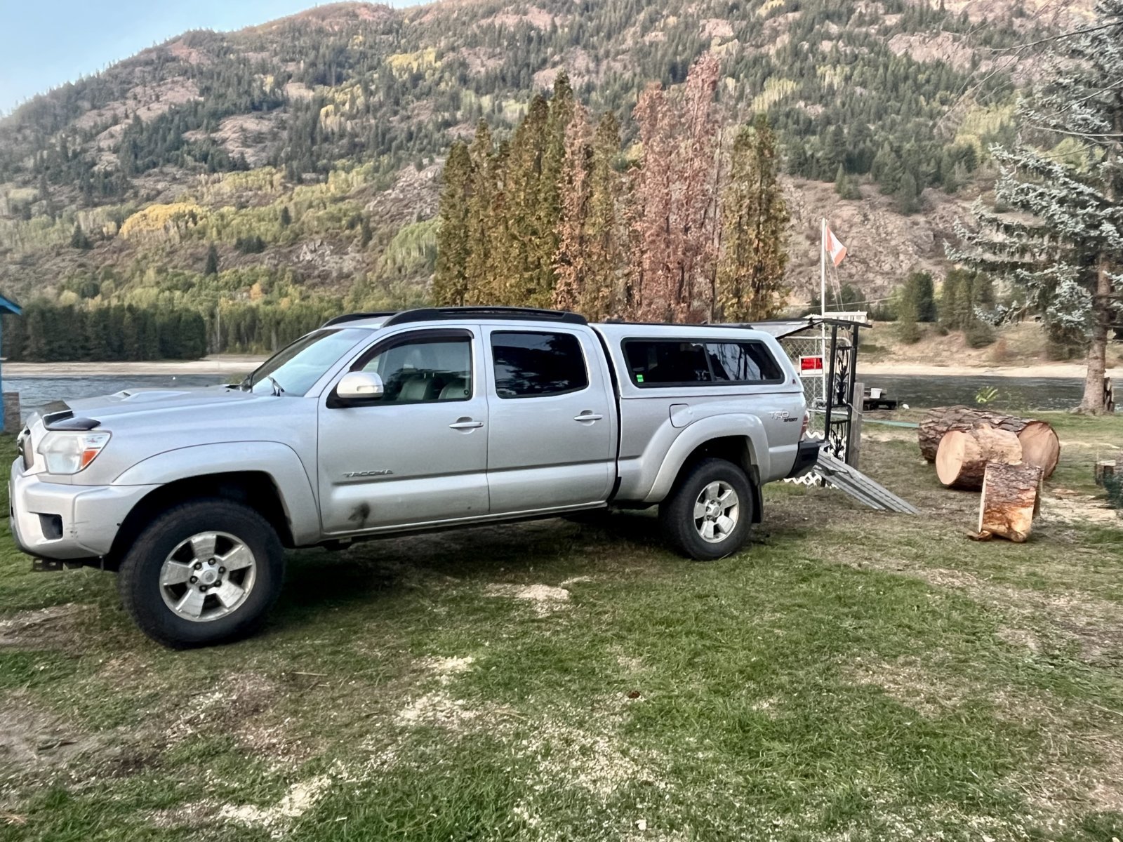

    5B4925F5-A222-4F2F-98D3-F817AC016096.jpg After doing some research, I bit the bullet and ordered Dobinsons 111-r leaf springs for my 2012 TRD sport DCLB with tow package, and had them installed last weekend. My nephew who is an apprenticing mechanic helped me out. I also installed Elka IFP 2.0 rear shocks rated for 2-3” of lift.
    I previously had Bilstein 5100s in the back on 3rd generation leaf springs, and still have stock 3rd gen coil-overs up front, which will be replaced with Eibach Pro 2.0 Coilovers soon.
    I found the stock leaf springs to be far too soft with even modest loads. With my cab high Leer canopy and steel rear bumper, there was a bit of sag. The weight with the canopy, and Body Armor bumper is approximately 260 pounds (bumper is 60-70 pounds heavier than stock), which falls in line with the Dobinson 111-r leaf spring recommendation. I forgot to measure because I was sick but the lift is right around 2.5” with 260-300 pounds in the back.
    Following the install, I went off road to a river valley in Alberta that involved a few miles of gravel road driving with continuous washboards and shallow ruts. While stiffer than stock, the performance on washboards, ruts and potholes was a significant improvement over stock leaf springs with less bounce. A major test was going over a set of two train tracks with a large dip and bump, that would have really bucked my truck before. With the new suspension set up, it just soaked it up and there was no suspension kick back, extra bouncing etc. perfect. My drive back to BC was close to 700kms of highway driving. The suspension felt very controlled and firm, with less body roll and superior for impact absorption.
    I picked up some wood rounds last night weighing 600 pounds at least, which dropped the suspension about 1.7 inches. This made for a total approximate weight of 860 pounds+ including the canopy and steel bumper. The truck drove and handled very nicely with the wood rounds in the back.
    I hope this short term review will help some of you who are considering the Dobinson’s leaf springs and are on the fence between the 110 and 111s. I will likely be adding bump stops and will be getting the Eibach front coil-overs on soon, and will raise the front just under an inch.
    93F77CE1-F939-43D1-B78D-380D20F017F6.jpg F196B848-B098-4383-9F16-612BC38BF28B.jpg 48A0E842-8D90-430C-98C2-3AFD4B384540.jpg
    The pics are of the truck loaded. I will throw up an unloaded pic soon.

    That's some hunks of wood !

    Yeah, and these were just the rounds I could get to fit. Old Pine in town that was recently cut. I plan on using the rounds for landscaping steps and possibly table tops.

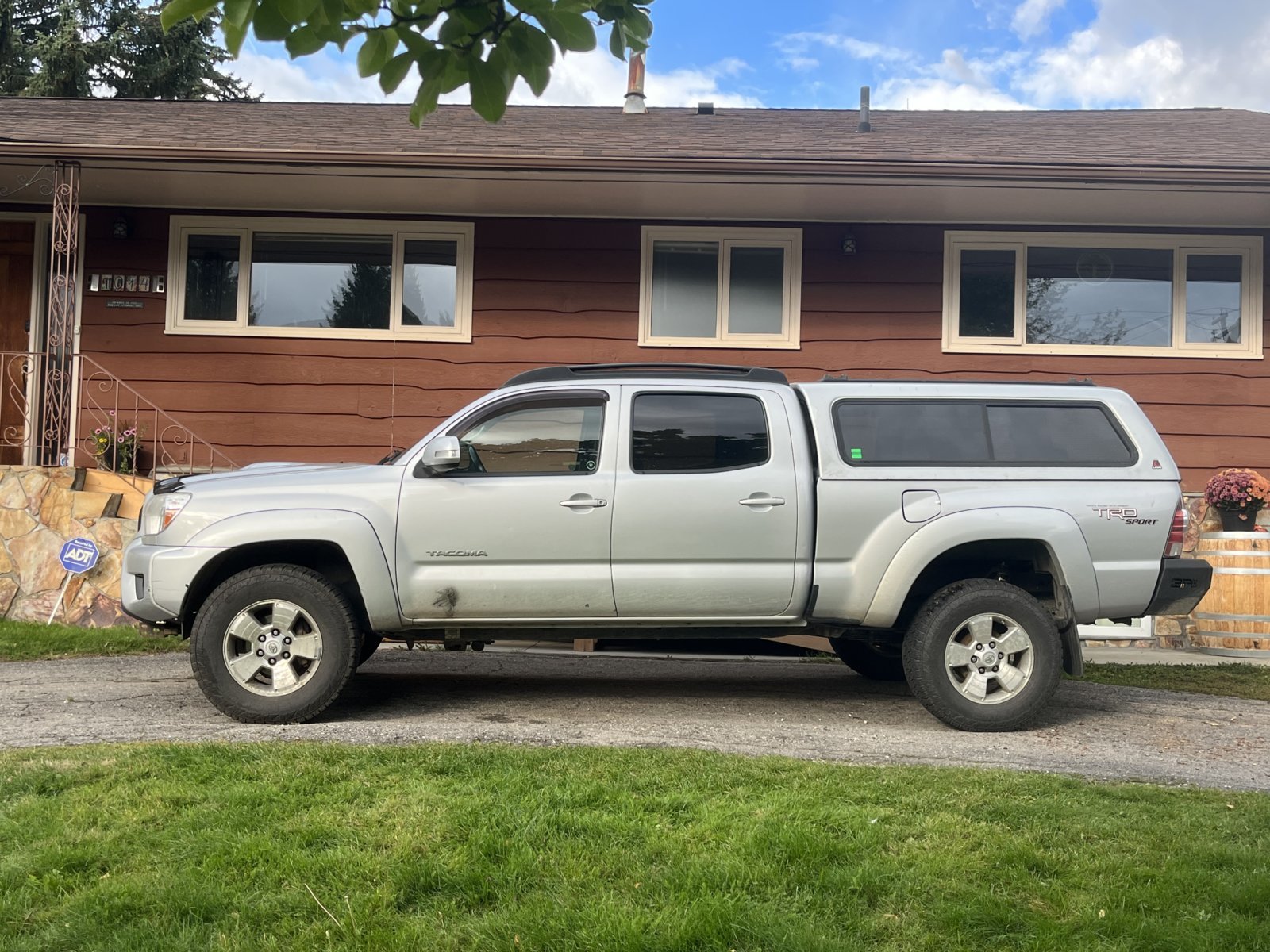

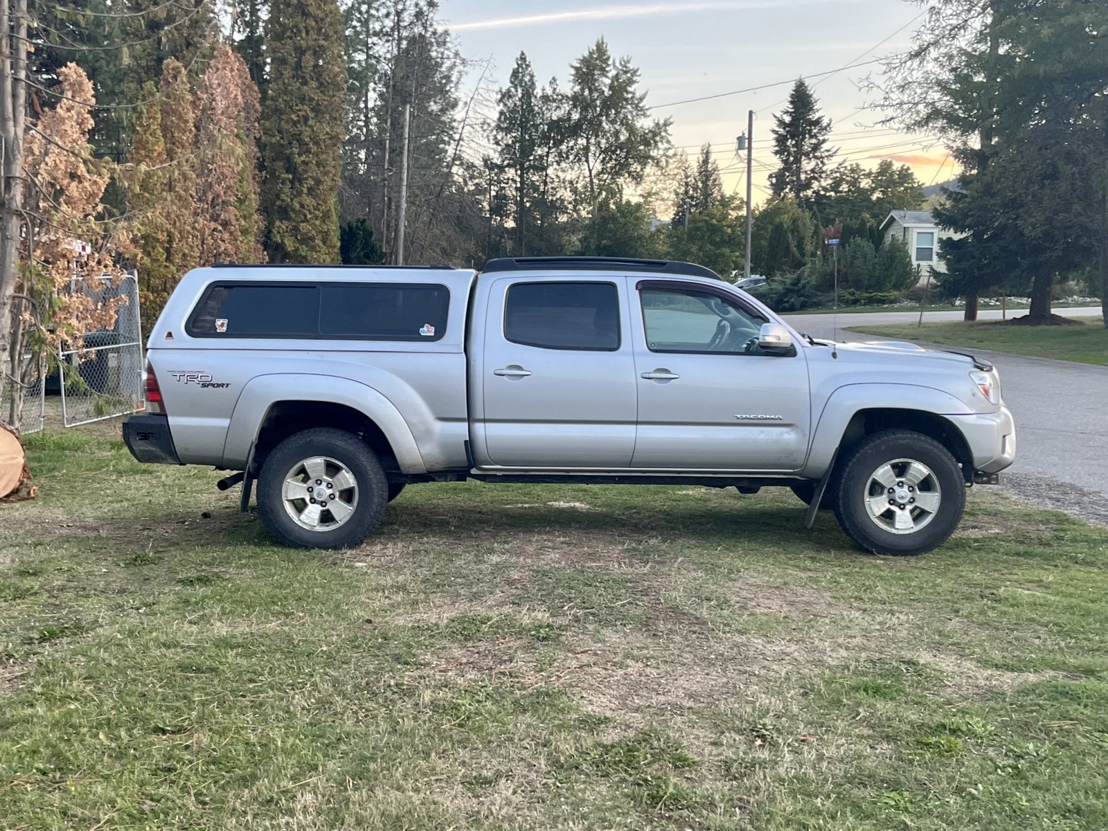

    DCEDE751-08FA-4222-8857-50883833EF4E.jpg Unloaded pic.
    banditcamp and IvanhoeTaco like this.

    2014 MGM AC SR5 4x4
    Nice slight rake stance unloaded.

    Thanks, I could leave it this and be fine with it. The 3rd gen factory coilover gives close to 1” lift on a 2nd gen. It’s a worthwhile upgrade for someone wanting to refresh their front suspension on a second gen for a really low cost.

    I love a guesstimate on how much that wood weighed in the back of your truck

    I guessetimated 600 pounds for three rounds. Some effort involved to get them up the ramps.
