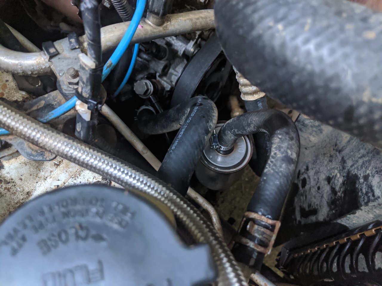

    On the 2nd gens at least, the ability to remove the crap from the PS reservoir would be a plus. Mine has never clogged that fluid wasn't flowing but the internal filter has caught a lot of stuff and cleaning it out is a pain because it doesn't fit through the screen and the shape of the top doesn't allow you to just pour it out. I'm replacing my pump and will be adding a filter. 3/8" ID line is what you need for a 2nd gen, put the filter on the return (low pressure) side and you'll be good.
