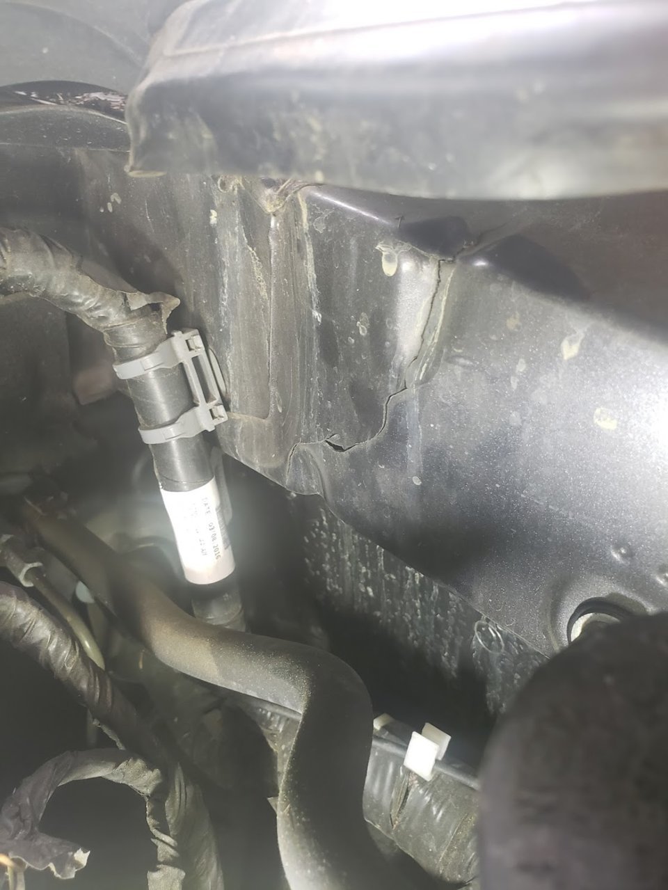

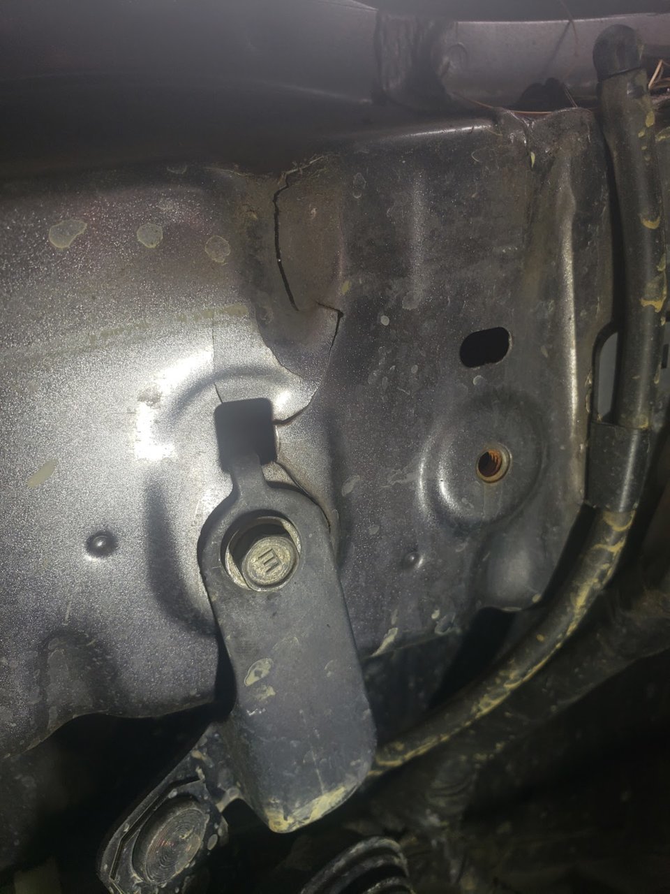

    I've noticed large cracks on my inner fender supports on both sides on my 2016, similar to the "Fender Buldge" or "Fender Rip" issues that were happening to FJ's. Has anyone had this issue on a Tacoma, especially a 3rd gen? What could the cause be, The truck has not seen any hard off-road use. I do have an arb bumper, so perhaps the frame flexes more than normal over potholes and bumpy roads?

    All of them.
    Mine driver side inner if completely trashed. Tons of large cracks. Mine is from the weight of the battery and going a little to hard and fast.

    Where it cracks depends on several factors. What suspension are you running?

    My bone stock TRD sport has this bad as well. No jumping the truck or anything gnarly. Dirt roads :confused:
    Hasn't gotten worse though been ignoring it for a few years now. Only problem is a clunk over speed bumps at times. Not sure if that's what is even causing it but that's what toyota blamed and my mechanic says everything else is in perfect shape.

    Dobinsons with c59-354 front coils, 730lbs

    I'm thinking that if enough trucks are having front end body cracking issues this can possibly be a similar situation to the frame rust recalls, clearly a major defect, in alot of cases affecting factory engineered crumple zones

    All that goes out the window with things like bumpers batteries and suspension mods.

    It is jacked up. If I was buying that I would consider it frame damage and it would need replacement.

    What size battery/batteries?

    Just a single napa agm stock replacement, can't remember the group size but actually shorter than the oem battery

    It is known that a heavier battery will cause that sheet metal to crack.

    Yep, insurance covered it since we assumed it was from hitting a pot hole. I do think it’s possible though that the previous owner may have us something to do with it though and that they were bulged or otherwise compromised all along. Who knows‍♂️

    Sheet metal. It’s part of the structure of the body and crumple zone

    Truthfully I can’t remember but I think comprehensive being it was a road hazard and not a accident with another vehicle. Did not change my rate. It was about a $4400 repair but I do have a $2000 deductible
