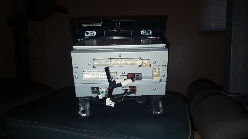

    Here's the backs of the two radios...

    you need a GT5-1S to SMB adapter

    DunkinDal You are the MAN! I have contacted about a dozen radio houses and no one was even close to knowing what they were, even with the pics!

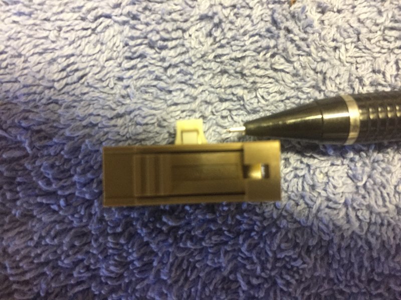

    Once you get the antenna cable out of the old radio, you'll see the brown connector shown below:
    [/URL][/IMG]

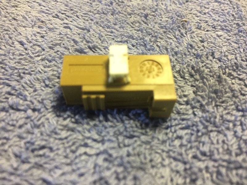

    Pry up the tiny white clip with a razor knife and toss it away:
    Once you have it out, you'll see the metal outer ring of the SiriusXM antenna. Take a jewlers screwdriver and gently push it backwards and then remove the brown housing:
    Now you have the correct original SiriusXM radio connection to connect your blue sharkfin antenna to and the other end goes to the black antenna connectection on the Sirius unit (below the radio display unit).

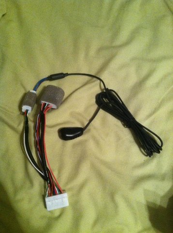

    so if i wanted xm to work how would i do that if it has the module already???? has been frustrating just getting the proper answer on what i need for install. one guy said in ollld threads all one needs is those 3 things.
    i happend to pm him and he said he never did install on pre 2012 only 2012 to 2012 and may have been just passing the info all i know is the one harness of the 28/20 adapter is for the bluetooth mic as shown here. i have 4 plugs on back my radio. would thst mean one plugs into the 2nd end of that harness and than 3plug into the 2015 radio???
