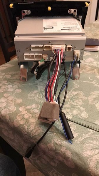

    So I bit the bullet, so to speak and shelled out the $60 for the XM cable lead/adaptor. The female end of the adaptor didn't fit the Toyota male end as I would have liked so I had a hard decision to make, start chopping up the brand new $60 adaptor jack, or send it back and start dumping my Entune goodies and just forget the idea of ever installing it in my 2012...
    I opted to 'hack the jack' and see if it gave me XM signal... I'm happy to report that it has and I now have the radio in my truck with the phone, steering wheel controls, 3.5mm input, XM radio and AM/FM functioning.

    just hooked mine up.
    pandora and spotify work flawless over bluetooth and when my phone is plugged in via the iphone cord

    plugged it into my radio yes, and than i just plugged my iphone cable into that.
    my 2010 didnt come with a factory usb port

    the gray one

    no problem, and 2015. i wanted to do the usb port in the dash so it would look factory but when i got the truck i had the blank switch next to the aux port so i put a usb port which is simply for charging and i needed to cut the switch opening a little bit bigger for it to fit. so i dont think a new usb switch would fit tight in there.
    so i just plugged my iphone cord into the end of that plug i showed you and routed it theu the dash to cone out in the cupholder area
