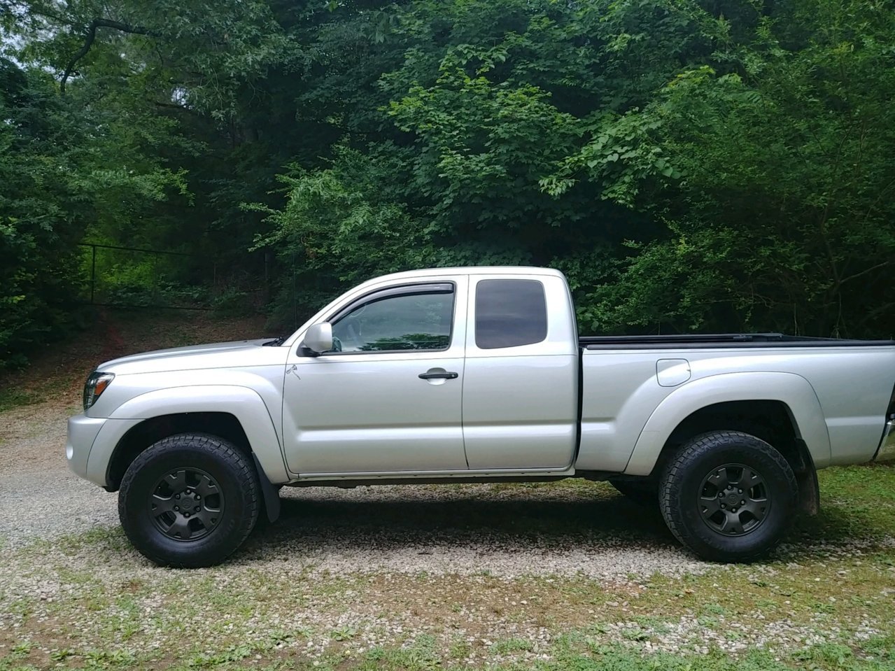

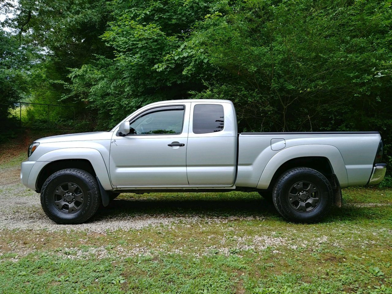

    before
    after
    I'm not gonna lie...There is now a tiny bit of "axel wrap" below 5mph.:annoyed:
    Not sure if i should have gotten the shims now because bilstienlifts.com told me I shouldn't need them with the 1.5-2 AAL.
    Having 600lbs of garden soil in the bed last week was what pushed me over the edge to try this.

    I installed mine over the weekend and drove it for a day and was trying to be hyper sensitive to any vibes, didn't feel any. jot the front jacked up yesterday and still don't feel any problems... yet.

    Axel wrap? I thought that's why you use an add a leaf and not a block.

    He’s probably feeling vibes, and calling it axle wrap.

    Yeah I was feeling a little vibe in the shifter at take off.
    Drove it a little today and I barely feel anything (new) if anything at all now.
