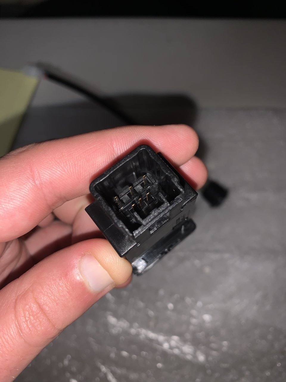

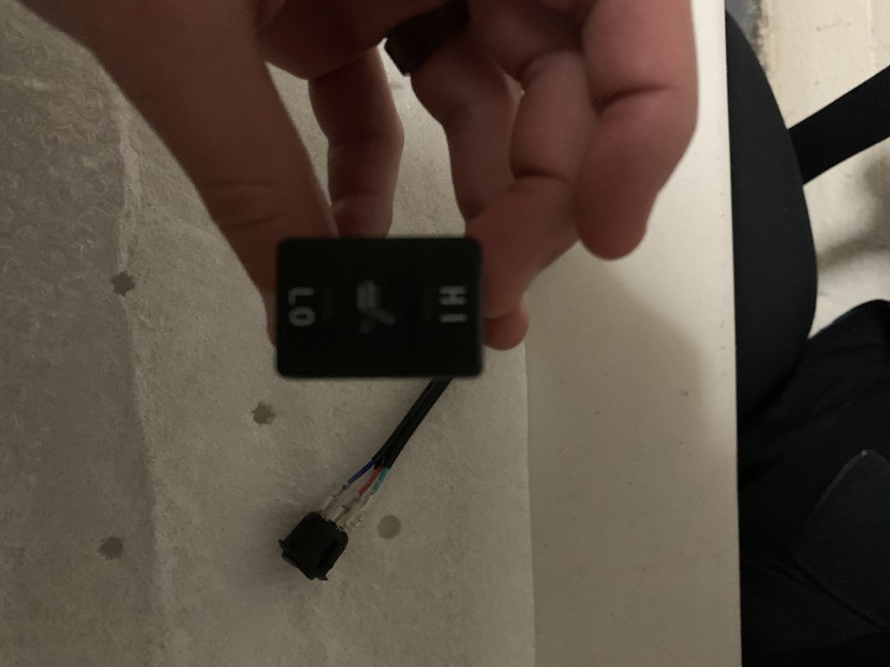

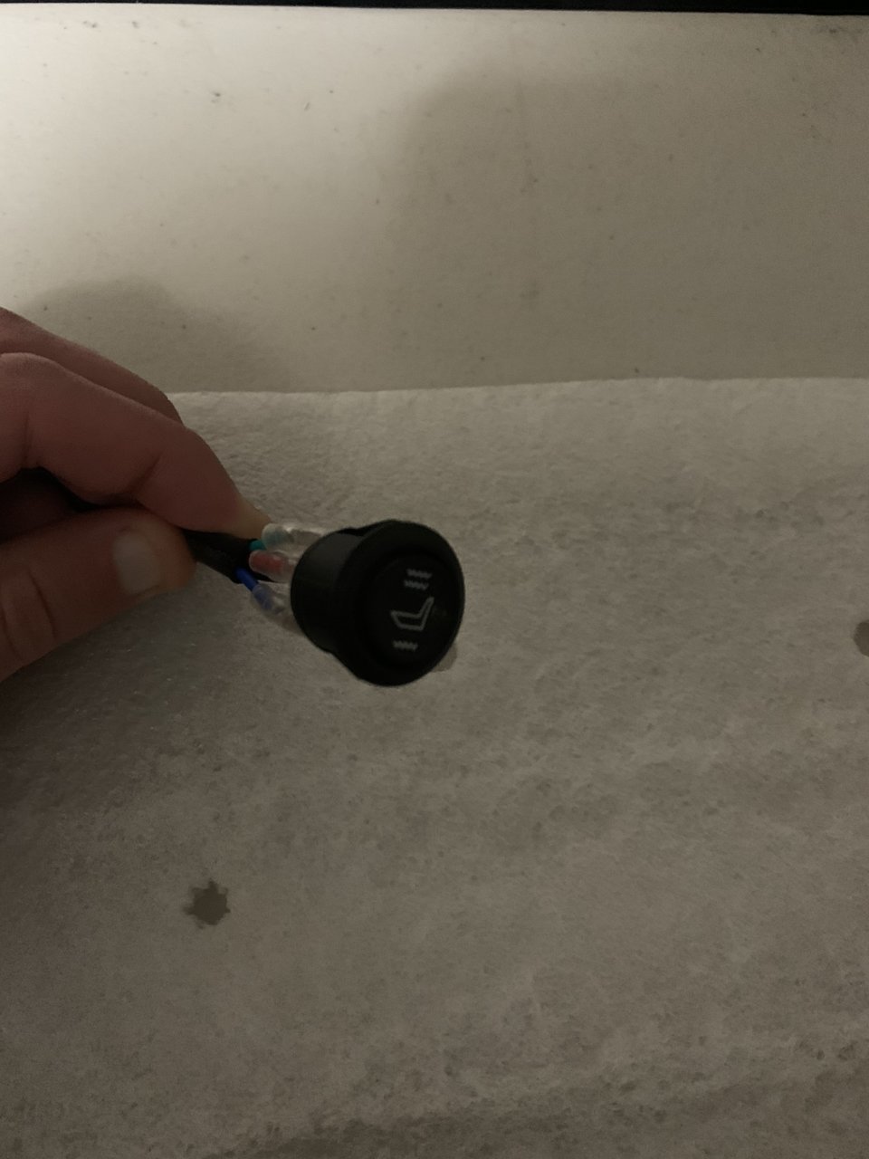

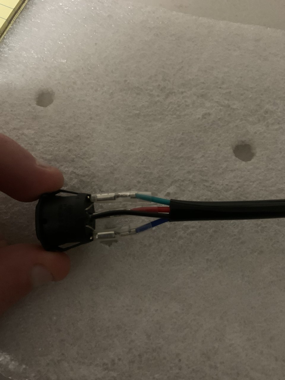

    A friend of mine gave me a heated seat kit that he never installed on his SR5, then he upgraded to a TRD trim that came with heated seats. The buttons on his kit were the cheap 3 position rounds, and I wanted the more OEM look of the switches in this thread, so I bought just the switches on Ebay. However, the cheapo switches only have 4 wire connections, whereas these have 6 pins in the back. Any ideas on how I can make these work with the kit I have? I've reached out to the seller on Ebay to see if he has a wiring diagram for the switches, but no luck so far.
    cheapo switches from kit
    OEM style switch
    #70

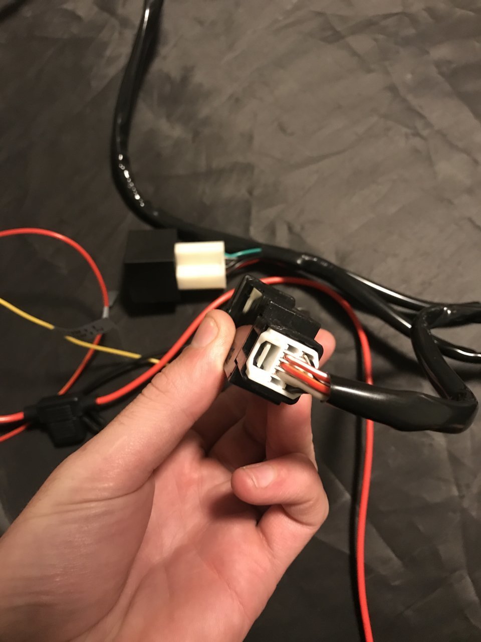

    I just installed a heated seat kit that came with that OEM looking switch. The wire harness that it came with had (2) relays per per switch Which I thought was odd. I think the connector for the switch only used 5 wires. Here's a pic from the back of the switch. Hope this helps.
    #72

    The 2 relays should be for High and Low

    If it’s 1 relay per switch, then wouldn’t it be the relay provides power for each switch individually rather then 1 relay for low 1 for high. Did the kit you linked above include 2?
    I think it’s actually a good idea to relay each seat/switch separately. In case of fault they aren’t connected

    Thanks for the pictures of the correct harness for the OEM style switch. I heard back from the ebay seller of the switch with the wiring diagram and I don't see any easy way I'll be able to make my kit work with those switches, so I went ahead an ordered the full kit and the ebay seller gave me a $20 dollar credit. :spending:

    Rich
    Northern Vermont
    2016 Tacoma TRD Off Road 4X4 AC Grey
    The OEM style switch has an extra set of contacts because the switch lights up when the dash lights are on.
