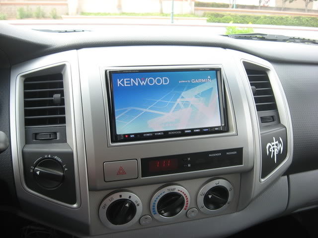

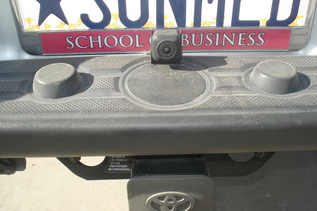

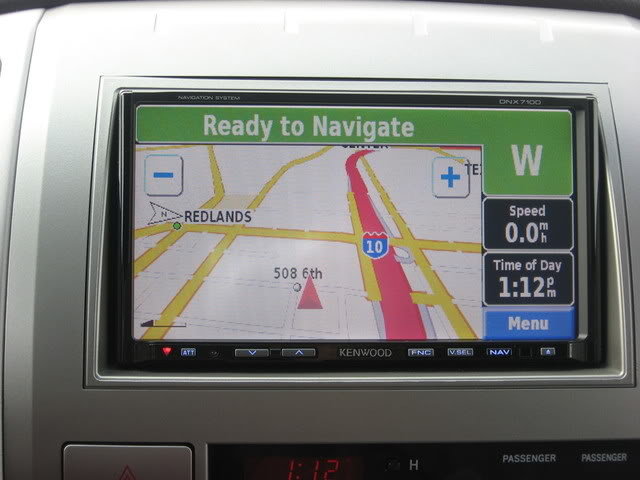

    got my dnx7100 installed today and its great. check out the pictures i uploaded. thanks again for everyone's help.
