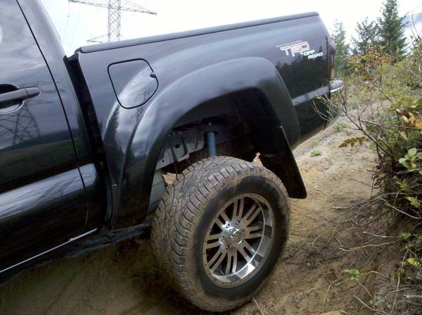

  6. Jul 13, 2011 at 12:00 AM
    #26
    BrettBretterson
    BrettBretterson Wild Ginger
    Apr 2, 2010
    #34449
    1,148
    Bothell, WA
    06 DCSB TRD OR 4x4
    5100's
    I definitely took my truck offroad and I never rubbed even at full flex. Here's a picture showing this tire on my truck on stock suspension before I installed 5100's at 1.75" and stepped up to 275/65/18 Duratracs:
    KPT, you should definitely have no problem with this size tire on 5100's set at 1.75".
