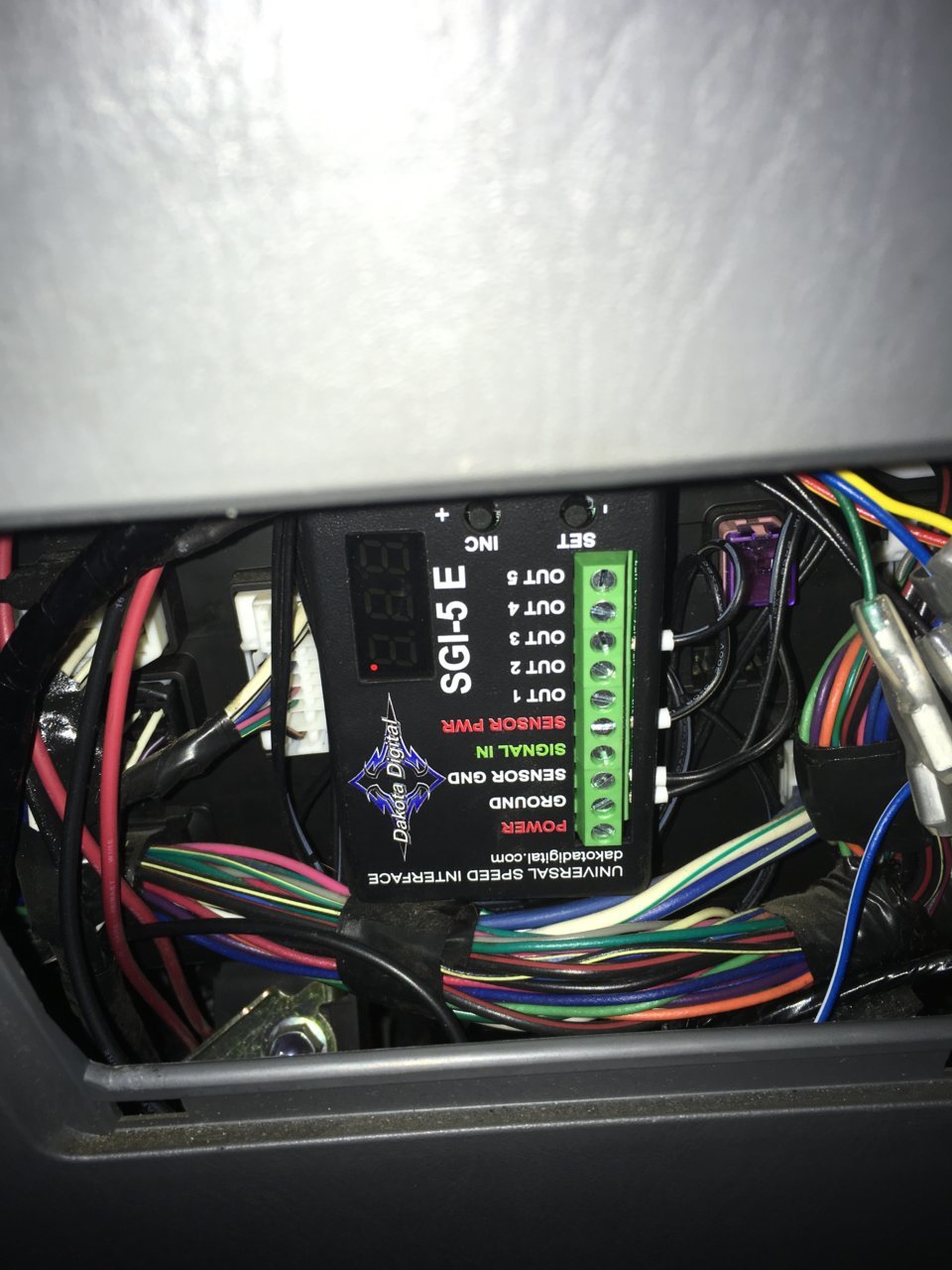

    Black this black that , 315-75r16 pro-comp A/T's , 285-75-r-16 treadwright gaurd dogs full OME lift with Dakar leaf spring pack, boss airbags, 4.88 nitro gears, dakota digital speedometer calibrator, tjm air locker, arb onboard air, spider tracks 1.25" wheel spacer, sport headlights, brute force fab hybrid front bumper, 6000k 4" led fog lights, 24" double row led reverse light, storm trooper shift knob, rebadged badg-less black mesh grill, Kenwood double din stereo, 400w Rockford 12” sub . Anytime fog lights. Oh yeah almost forgot the 2016 FourWheel camper fleet model for extra traction and a place to crash if you do get stuck or broke down. 2x160watt solar, mppt charge controller by blue sky energy. 3 deep cycle batteries 20gallons water, 6gal hot water, 3.5cf 2way fridge/freezer, 6gallon propane... just getting warmed up.
    I installed a Dakota digital speed calibrator for $85. It was a cinch and corrected my drastically wrong speedometer reading. After gear change I was reading 70mph while doing 55mph with 285/75r16’s a couple quick wire taps and back to spec. B08B4E6C-FF84-486D-99B2-6FE120F5233D.jpg

    Thanks, but unfortunetly that won't work in 3rd gens. #toomanycomputers
    It will indeed since it taps into the line going directly to the speedometer all other systems are before the tap.

    You have tested and verified a Dakota digital speedo calibrator on a 2016-up Tacoma????
    No I have not tested one. You’ve got me there. However knowing how electrical systems operate and how this system operates there is no reason it would not. The 3rd gen gets its signal the same way the 2nd gen does, through a speed sensor a speed sensor sends our a signal that can be modified. The DD unit does this at the input to the speedometer which in turn relays it’s signal to whatever else needs it. All this unit does is change that input by a percentage. For $85 and no harm to your truck if it doesn’t work I would be willing to bet the company would give you one to be a test mule. Better odds then Toyota giving me a 3rd gen. If you also look at the hypertech unit you will notice it has 4 wires run to it. These would be the same 4 wires for the dakota digital box. They are essentially the same thing. The difference in price from what i can see is the mess of wires they give you to make it plug and play. I will be meeting up with a friend who has the hypertech unit in a 3rd gen and see if he feels like being adventurous for the good of the group and try my simple cheap version.:boink:
