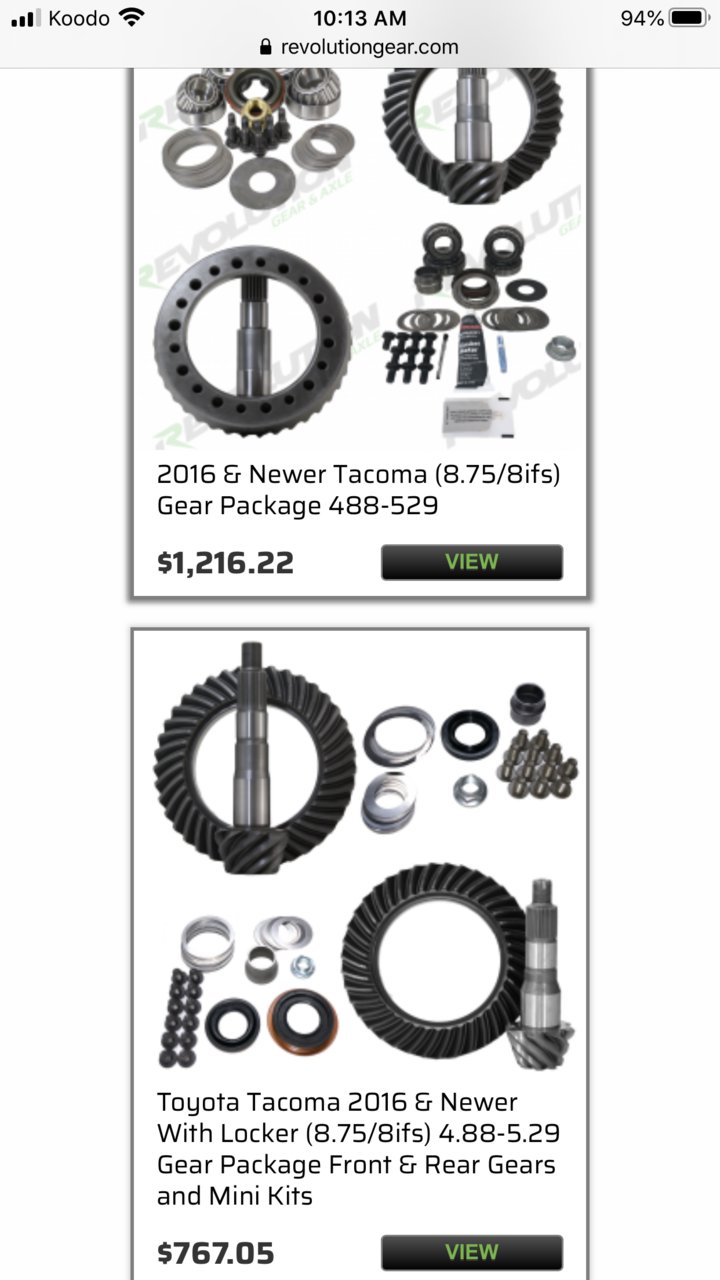

    So looking to do a gear change. I’m pretty heavy with bumpers, winch, skids, and sliders on 285/75/16’s. So I’m going to be going with 5.29 gears. Has anyone installed revolution gears? They are cheaper and there is 2 kit options. Wondering if I would need the full kit or if the mini kit would be all I need? Only 45,000kms (Km’s not miles) on the truck. Will be pulling the diffs myself then bringing them to a shop for them to install.1605343F-1940-4DFA-8B91-69C5EB2706A7.jpg
  8. Jun 16, 2020 at 10:41 AM
    #1188
    Birks
    Birks Well-Known Member
    Dec 16, 2019
    #313523
    148
    Junkhead and JoeCOVA like this.

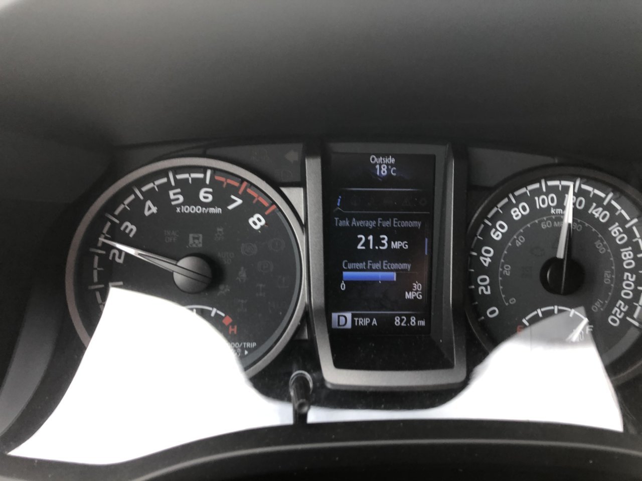

  20. Jul 22, 2020 at 8:28 AM
    #1200
    Birks
    Dec 16, 2019
    #313523
    148
    I will find some time this week and get you a photo of my dash at 70 to 80 if you would like. I don’t have stock, my 32” come to 32.4”.
