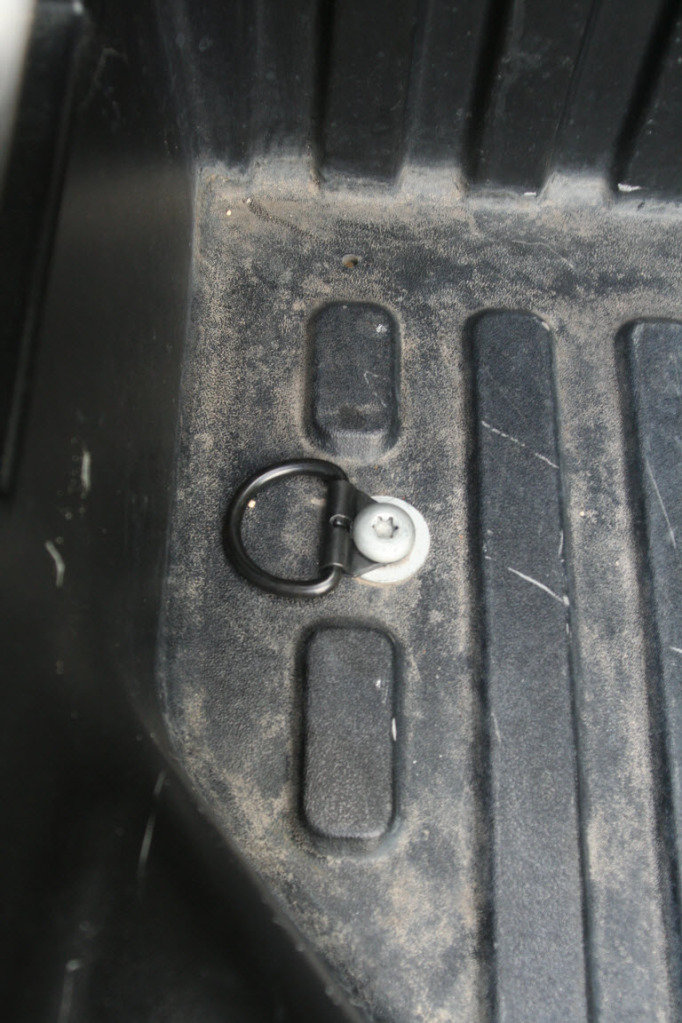

  4. Mar 21, 2012 at 8:34 PM
    #324
    senn4586
    senn4586 Well-Known Member
    Nov 27, 2011
    #67797
    204
    Orange County
    05 PreRunner SR5 TRD Off Road
    Always on lighter output, Any Time On Fog lights, rear 12v outlet, 4 additional D-Rings, Plasti-Dipped Side Steps, Satoshi Color Matched Grill, Dash light swap, Dome light and map light, Under hood light, Back up light/Bed Light, Diff Breather relocation, Cubby Combo Lock, Ammo Cans Mounted in bed
    I did mine a few months back but instead of cutting the heads of the washers I put the bed bolts on a vice with the washer up and bolt under and just pounded it out. Came out pretty fast and no cutting. To put it back on the bolt just flipped it around and hammered it back in. Didn't do anything to the threads for those of you who are wondering.

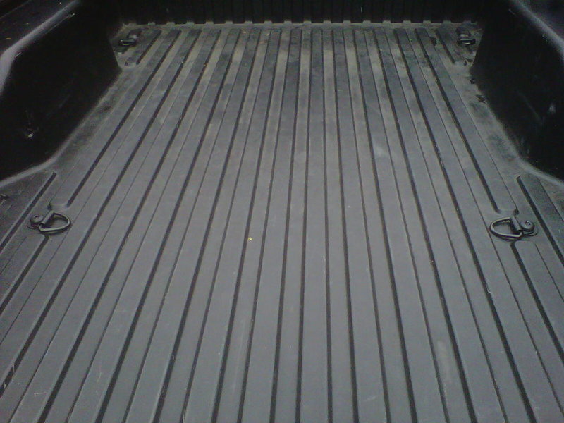

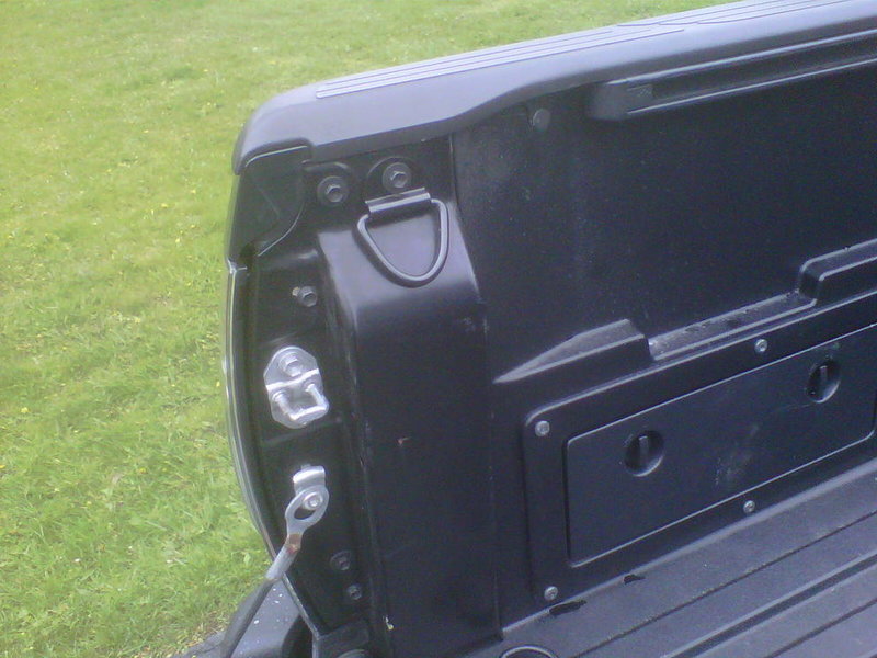

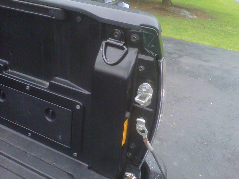

  13. Apr 30, 2012 at 11:24 AM
    #333
    blunt
    blunt Active Member
    Mar 15, 2012
    #74951
    37
    Syracuse
    2009 Tacoma SR5
    I just did this mod - very easy. Added two in the front and two in the middle of the bed. In addition to the original factory installed ones.
    I went one step further and put a couple smaller D-rings on the sides close to where the tailgate closes. I used one of the existing hex bolts. They both feel really solid. See the pictures to get what I mean.
    This works well with the nylon cargo net I swiped from my wife's Highlander. It hooks at the top with these rings, and at the bottom with the existing factory installed rings. Perfect for loose and light stuff.
    I've had this truck a month so far, and am having lots of fun finding stuff to mod out.
    GoRideToday and 69TACO16 like this.
