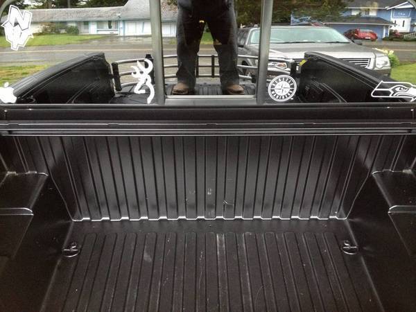

    Shortly after buying my truck I was hauling some materials and wishing I had d-rings up front. I was excited when I found this simple mod. I wanted to stay with the stock d-rings, felt it was more uniform. Jorge at Camelback parts here on the forums hooked me up. Got them last night and got to modding. :thumbsup:
    D-rings installed.
