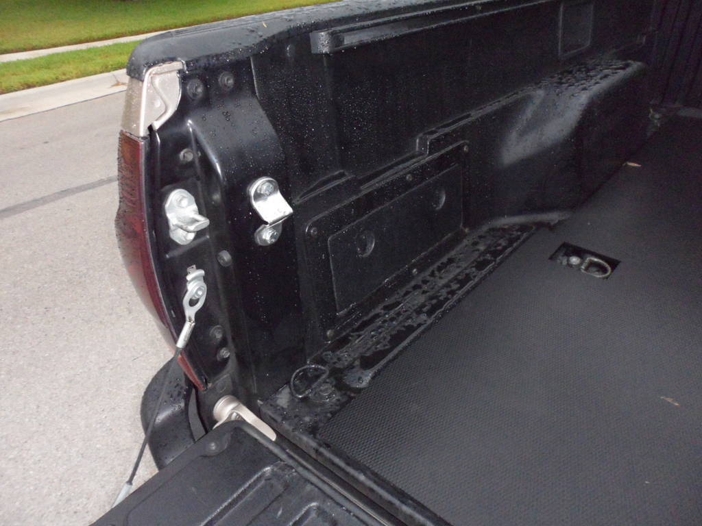

    I actually got to retire my 05' Sprinter work van (literally going to metal scrap) and I pulled the D-Rings out not knowing that everyone's buying them now...how ironic is that!
    Check it out you can see my 08' in the background! Sorry guys- I have to keep those in for work but when I give up this guy I send a shout out!
    D-Ring Mod and Custom Bed Mat
    I got bored and pulled a bottle opener off of my old pit and mounted it on the driver side bed wall!
    [​IMG]:cool:

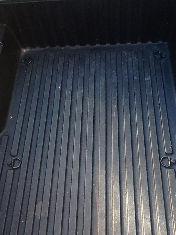

    Thanks for all the good info here. Did the install and it is great having these in the bed. One of the best and cheapest mods to do.

    Nice holes in the bed mat. What did you use to make those?

    Thanks.
    3 1/4" hole saw I found at work.

    Just did this easy mod today. Put d rings in the floor of the bed towards the cab as well as on the top part of where the bed meets the tailgate. Ready to haul some big loads now. thanks everyone for all the write ups and info. It was super helpful
