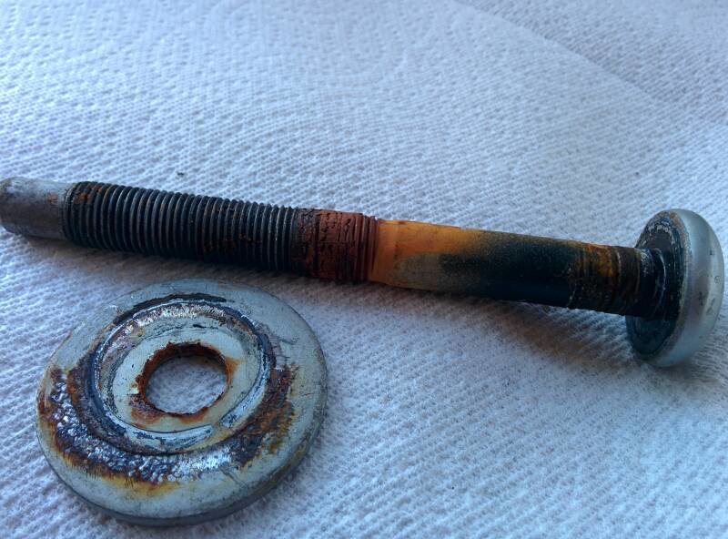

    You may want to check your bolts. I'm in San Diego too. This is what happened after 2-years to my bolt after doing this mod:
    Water in the bed from rain or garden hose will seep under the washer, where there is a little cupped space...the water will pool up in this space and corrode the bolt.
    I cleaned up my bolt well and applied a light coat of grease and put it back in, I also sealed under the washer with roofing sealant. I have a shell on my truck now so water is not a problem now...
    For what it's worth, factory replacement bolts are about $9.00 online.

    In New Mexico, much drier than SouCal, mine looked like this.

    Yikes. I might have to check those puppies. I do run with a DiamondBack cover over my bed and really never spray it out with a hose. Occasionally shop vac out the desert sand and gravel.
    Thanks for the pics. Next time I am tinkering with my bed configuration I'll take a look. The front most ones will take some effort to check since I keep a very large hinged action packer secured to those D-rings.
