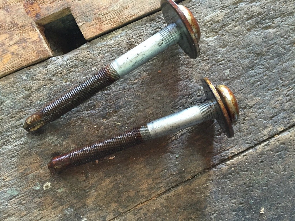

    Anyone attempting should poke their head underneath the bed to look at the bolt, if it looks like this, you will have a long day and may need to visit a mechanic like I did to heat the bolt washer to remove it....

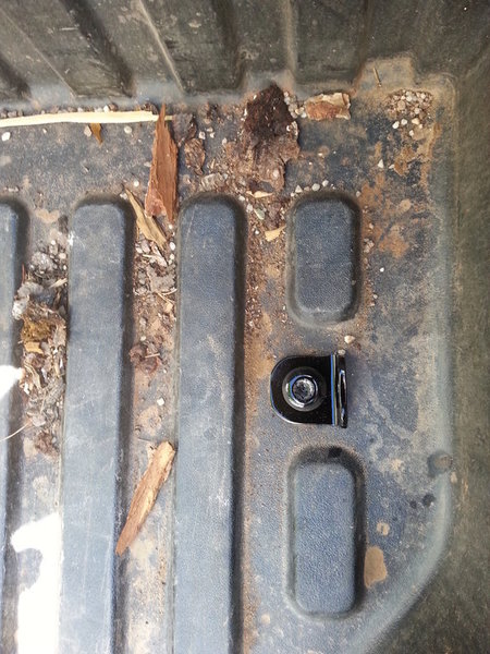

    Here is what I did, cost=$0 lol

    Made them out of 3/16 steel angle!

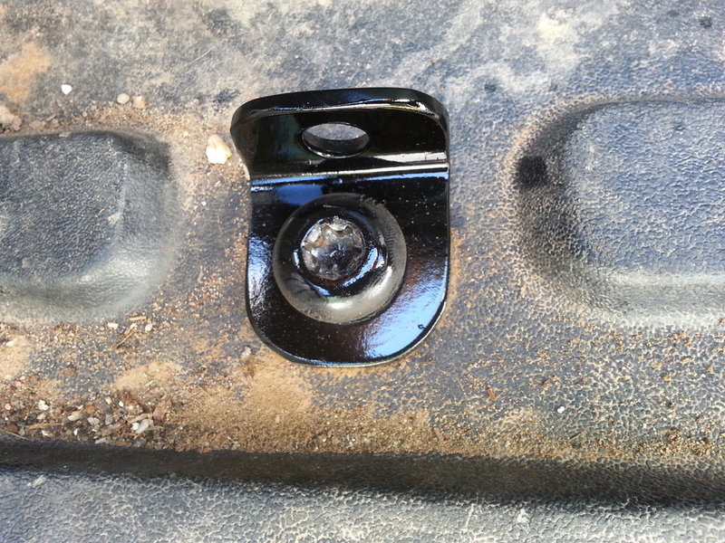

    Did this today. The bolts didn't play nice at first so I used an impact and they came out.

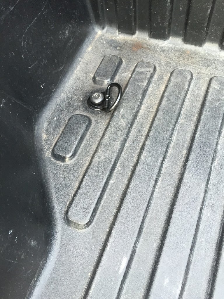

    I finished up my Chrystler D-Rings, got the last two installed, 6-total.
    Then cut holes in my bed mat. I'm so stinking OCD I am resisting buying another bed mat and doing it all over again but cleaner. See originally I decided the d-rings should sit flat, so had a rough idea and cut the first one. Accidentally over cut the rear one so just trimmed all the way to the edge of the bed. Then I realized I could actually fold the rings over some to help keep the mat in place but let's be honest the mat doesn't move hardly at all.
    They will be fine. They are stout as all get out and fold flat when needed. Best part no grinding or drilling. Just a BFH and a large socket!

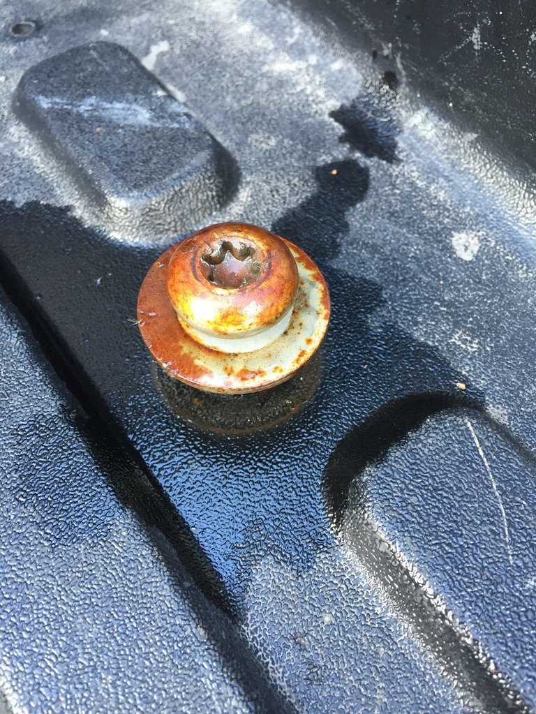

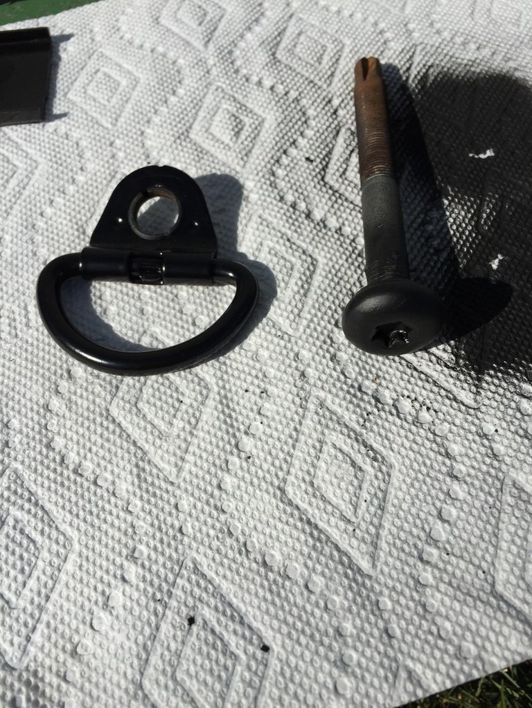

    Somehow my 2011 AC long bed got out of the factory with NO forward tie downs. Seems most of the trucks I see have the square galvanized brackets on the wall of the bed. Not mine. So I ordered the Toyota D-rings. I was a bit concerned about getting the bolts out after 4 midwest winters. Put some liqid wrench on from above AND below. The passenger side one in particular gave me a fight, but they both came out with out stripping the bolts or the tools. You can see a fair amount rust.
    B9E56C00-9A89-4B1E-9DA7-A57DBB2B2F77_zps_2a5648fca2edff0948c753ec44ad3a867eaeeb51.jpg
    8C4CD06A-009C-4B8F-AF02-152460B5B723_zps_979d1ab075ae244258925e27a50d8dcfebaa891d.jpg
    Took care of the ridges on a pedestal grinder, bought a couple of extra M12 washers, painted everything with a rustproofing primer followed by a flat black, and put 'em back in. Simple, cheap, practical and functional mod.
