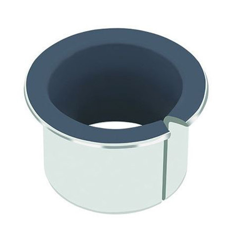

    Ok, I was bound and determined to do this, so I combed the depths of the internet for the right part. Here is the approx data for the "ideal bushing" using the OEM bed bolts and D-ring hole dimensions (3rd gen Tacoma):
    ID = ~11.9mm
    OD = ~16.4mm
    Height= ~4.86mm
    I found this data for suppliers and "flanged sleeve bushings" that fit the OEM Tacoma bed bolts and Dring to enable swiveling, with little to no modification. Here is a raw copy/paste from excel. Messy I know, but the data is all there.
    Maker model ID (mm, IN, Fraction) OD (mm, IN, Fraction) Height (mm, IN, Fraction) Total Flange Diamter -total width (mm, IN, Fraction) Flange Thickness (mm, IN, Fraction) Price
    Fastenal 435211 12.75/.502/ 1/2 15.9/.627 6.35/.25 22/.875/ 7/8 1.6/.0630 thick $5 for 5 pack
    grainger 12r665 12.7/.5/ 1/2 15.875/.625 9.525/.375 22/.875/ 7/8 3.175/.125/ 1/8" thick 4.35 for 3 pack
    Mcmaster SAE 7815k28 12.7/.5005/ 1/2 15.92/.627 9.5/.375 22/.875/ 7/8 3.175/.125/ 1/8" thick 3.23 for 1 pack
    McMaster Metric 5448t8 12mm/.472/ less than 1/2! 15.05/.59 8mm/.314 18/.70/ less then 7/8! 1.5/.059 4.19 for 1 pack
    I ordered this since I can pick up locally, best price and best size:
    https://www.fastenal.com/products/details/0435211
    Here were the other condenders, albeit more expensive:
    https://www.grainger.com/category/s...atalog/N-171cZ1z0o061Z1yzin7kZ1z0o427Z1z0o060
    https://www.mcmaster.com/#7815K28
    https://www.mcmaster.com/#5448T8
    They all look something like this.
    Per suggestion above, I will flip this with shoulder/flange downward, replace the OEM plastic bushing in the D-ring, keep OEM bed bolt washer underneath and finally be able to torque the bed bolt to spec WHILE KEEPING SWIVEL!!! Fingers are crossed it'll work. I'll try to report back.

    FYI, I'm doing this because I cut my OEM bed mat with a large hole saw with a big diameter that would allow swiveling of the Drings 360 degrees. To my dismay, after torqueing the bolts down on top of the Dring, the OEM plastic bushing/bearing was CRUSHED under the torque spec and did NOT allow swiveling due to the plastic compressing so far.
    Since I spent so much damn time cutting beautiful holes and following up with beveling the edges with a dremel, I was pissed they didn't swivel.
    TL;DR - I cut big holes in my bed mat (to allow 360 swivel), they didn't swivel after being torqued down and am on a quest to get these to swivel

    Pic for reference...
    This is the plastic bushing/bearing in the OEM Toyota swiveling D-rings I'm referring to:

    i think you want the flange up , so that it is underneith the head of the fastener if I’m not mistaken . I don’t think it goes the other way, I could be wrong thou. That’s some good info thou as far as what might work and where to get it , thanks !

    It’s not the bushing that allows it the swivel it’s the bolt , the “step” on the bolt allows the d ring to swivel and not crush the plastic insert on the d ring

    I figured I would turn it down to allow the head of the bolt to apply pressure on the "unflanged" side of the bearing and have the flanged side down to more evenly distribute the pressure over the OEM bed bolt washer.

    I don’t think that’s the right way , I think it’s the other way around
    The ones included with the D Ring kit , they are stepped and allow the ring to swivel

    1) Ok, I can see benefits of both sides. Once the part is ready for pickup next week, I'll try both ways and see what seems to fit and function best. I'm no engineer, so am just winging this.
