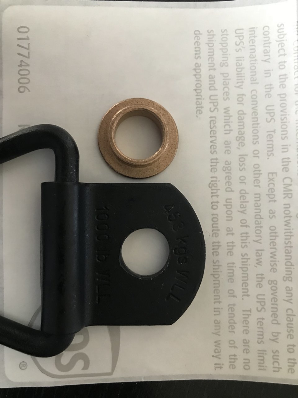

    I removed one of the bed bolts and it measured about 15/32" diameter. Most of the d-rings I've look at have a smaller mounting hole diameter. Does any one know which one(s) don't need to be drilled?

    The Dodge ones.

    Being mindful of the proximity of the D-ring running through the cylindrical channel in the base/mount/bracket, I would use a dremel (or any type of rotary tool) to surgically remove just the right amount of material to allow the bushing to pass through your aftermarket mount. It looks like you have enough metal material to keep widening the hole, without getting to close to the edges.

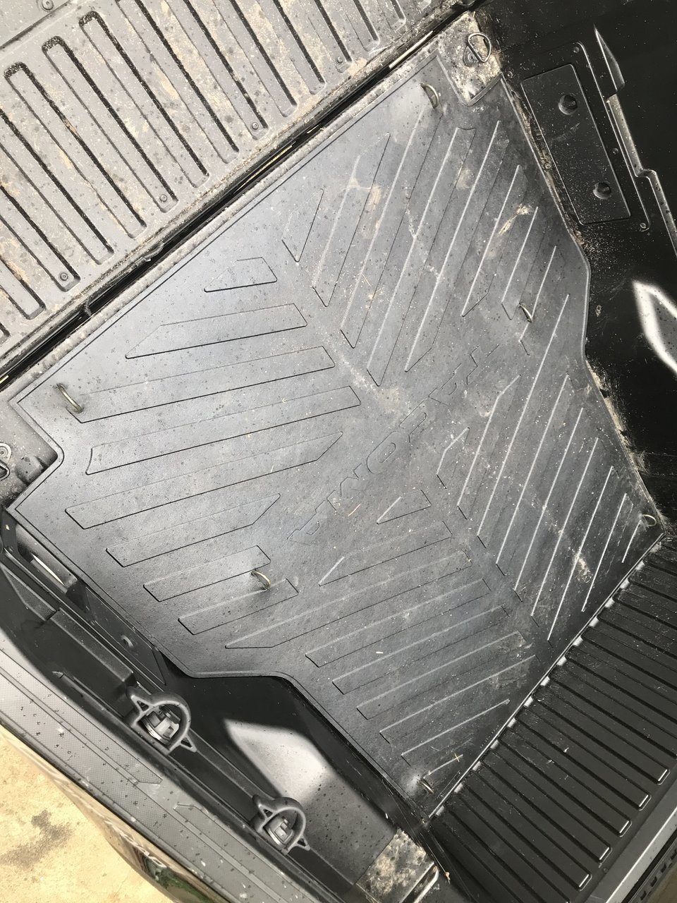

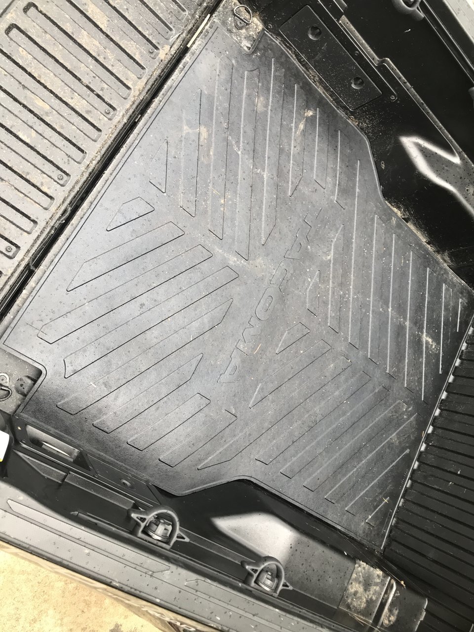

    Just did this mod... now to measure and cut my bed mat to expose the D-Rings
    Just took some time and patience with the paint drying.
    Thanks!

    The cleanest way to cut holes that look OEM-ish is using a hole saw bit that fits the entire radius of the swiveling D-ring (if you're doing the swiveling thing):
    Once the holes were cut, I used rubber abrasive bit on the dremel to smooth and bevel the hole:
