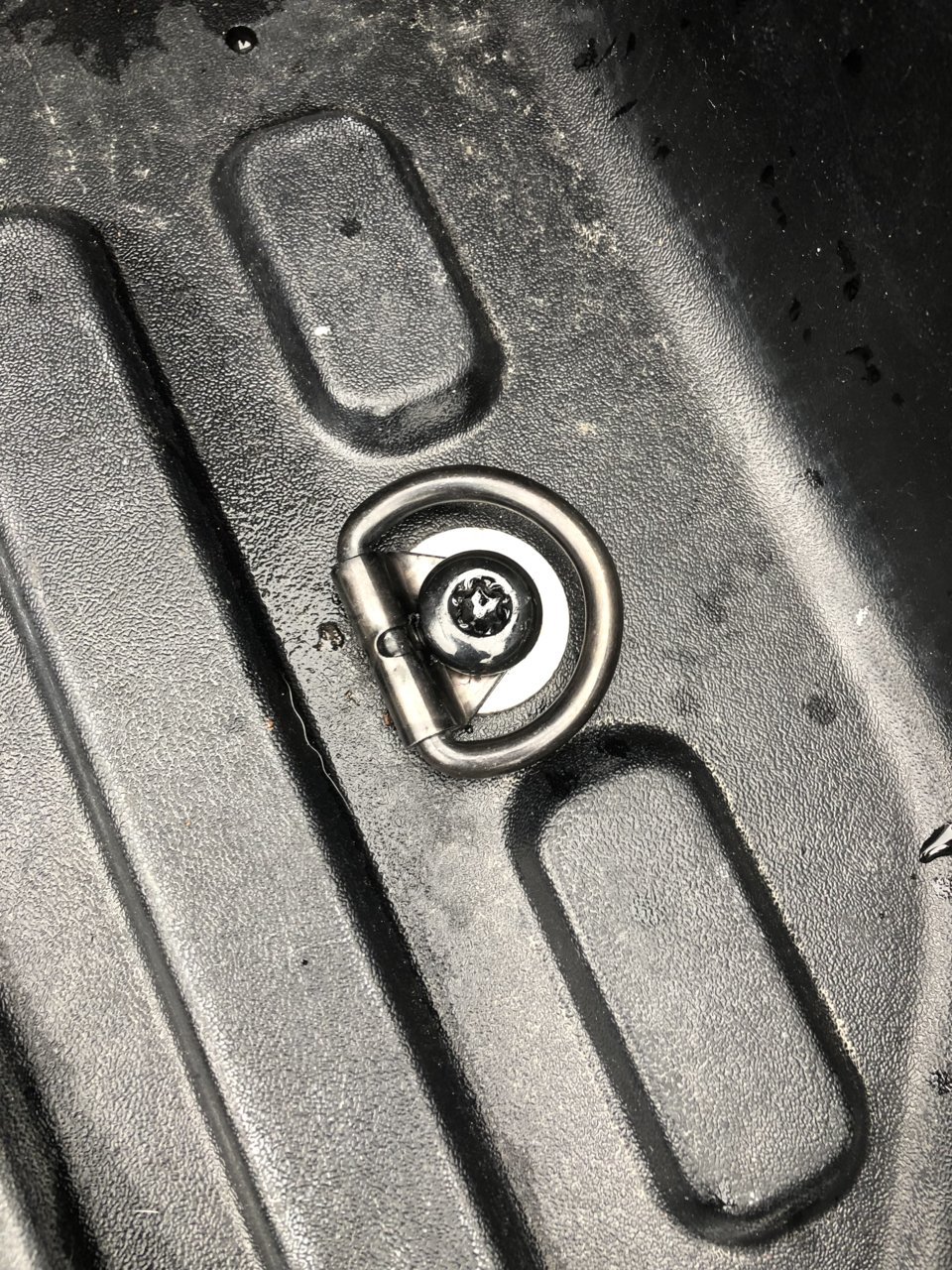

    I live in a salt free environment and was able to get mine out without issue - but before I put then back in I hit them with a wire brush, rustoleum, and lithium grease hoping that they will come out agin if needed in the future.

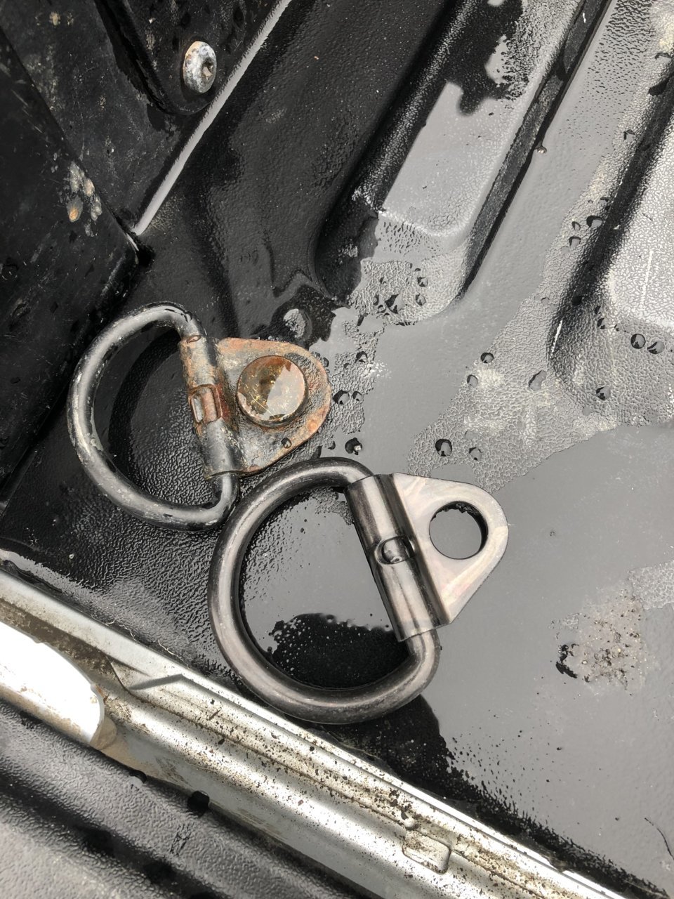

    Get d rings from a dodge sprinter van. No need to drill them out and they’re a little beefier then the ones from Toyota. The washer is the stock washer off the bolt just have to file the retaining ribs off the bolt to get it off.
    Installed with front bed bolts

    Bought the rings on Amazon (link). There are cheaper ones I only paid about $19 for them at the time. Don't know what size the washers were, they came out of a Mercedes engine I took apart and they just fit. I am sure if you take one of the bolts out and go to the hardware store you can find a size that works. You just need to make sure you have enough of them to space the bolt head away from the large washer so the D-rings can swivel if you want that.
