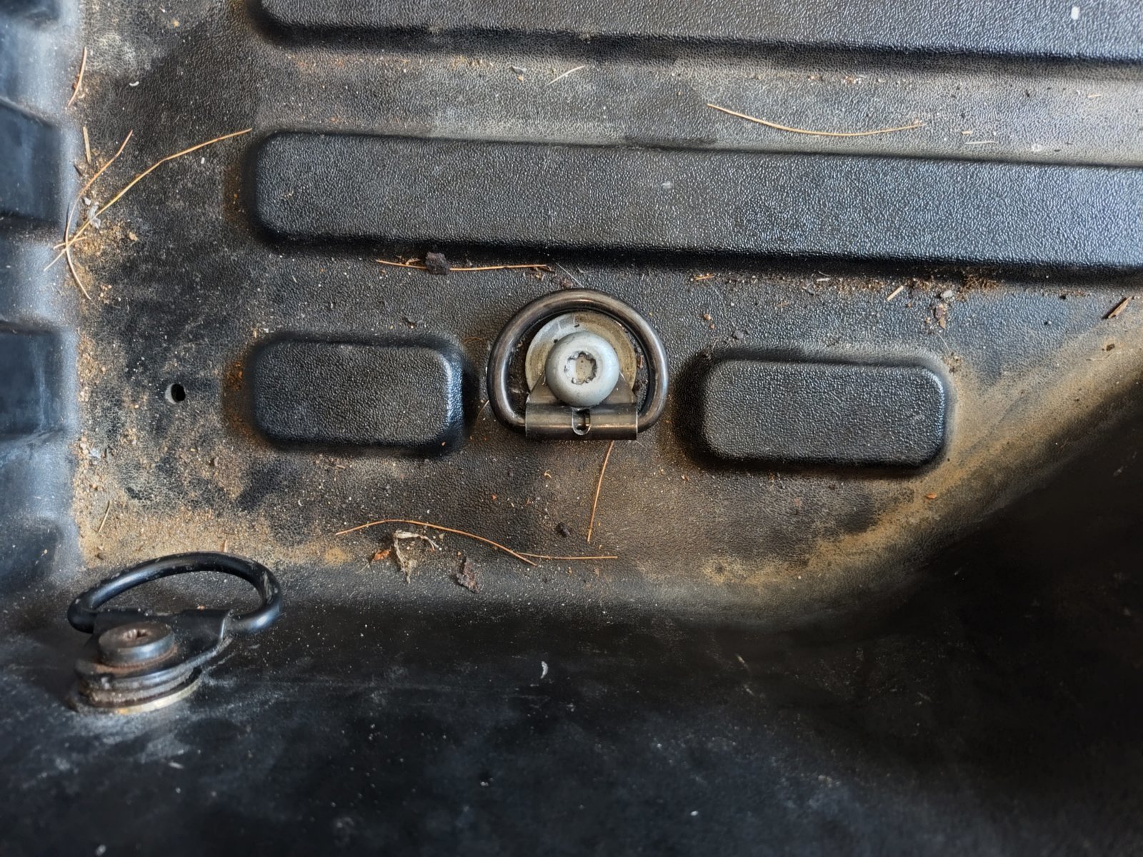

    introducing, VersaTrax (I have no idea what it is)

    Sprinter van D-rings installed

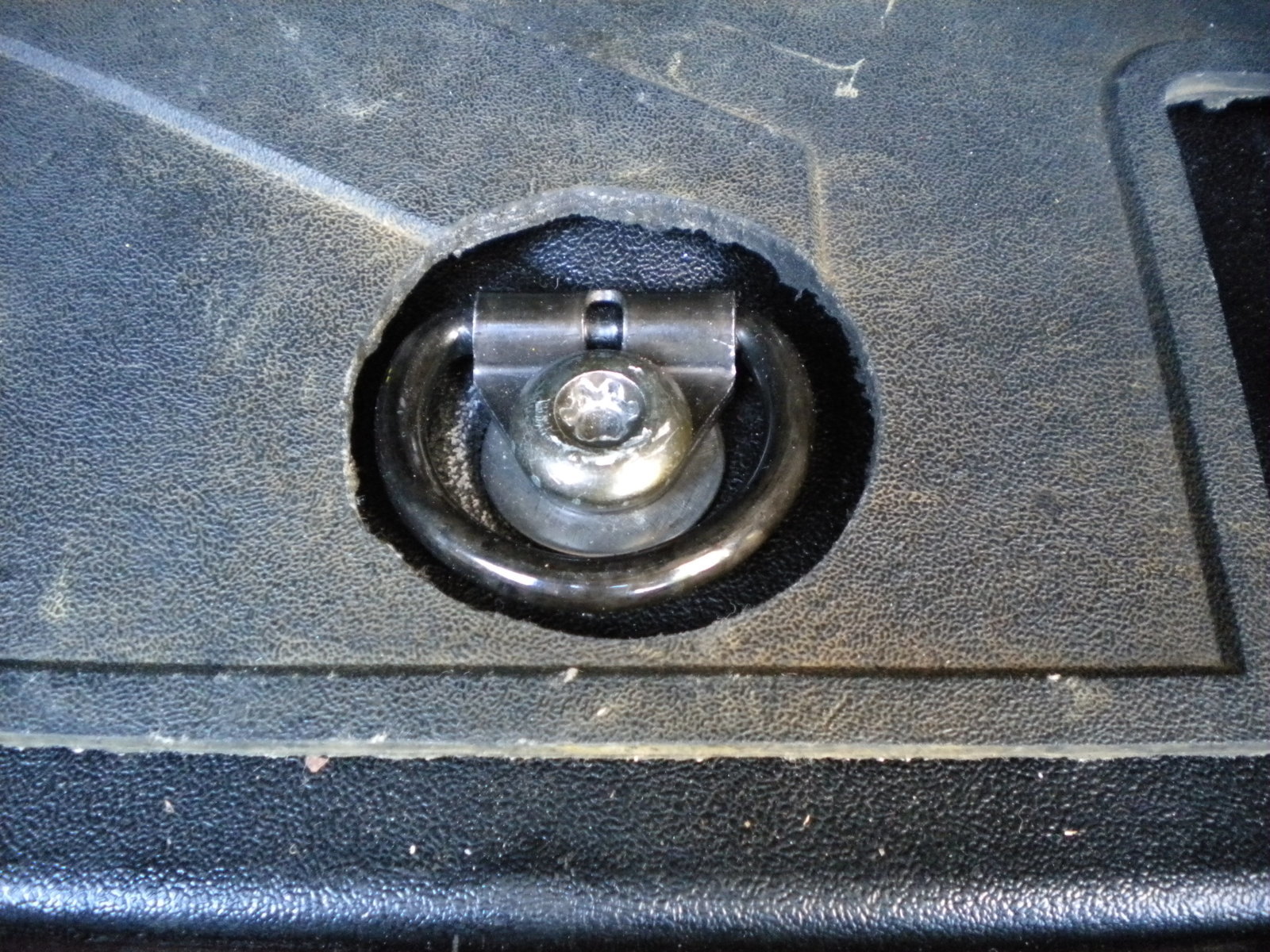

    Mounted sprinter van D rings in 6 bed bolt locations and 1 in center front drain hole. For center front hole increased hole size, bought grade 8 hardware, and cut metal for top/bottom backup plates.) Used hole saw on bed mat. To get washer off bolt i placed a large socket over bolt head onto washer... placed bolt on wood and after a couple hits with a sledge hammer washers slides right off (flattens down ridge on bolt that holds washer in place.)
