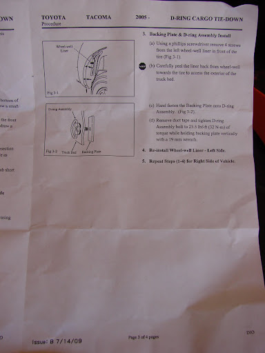

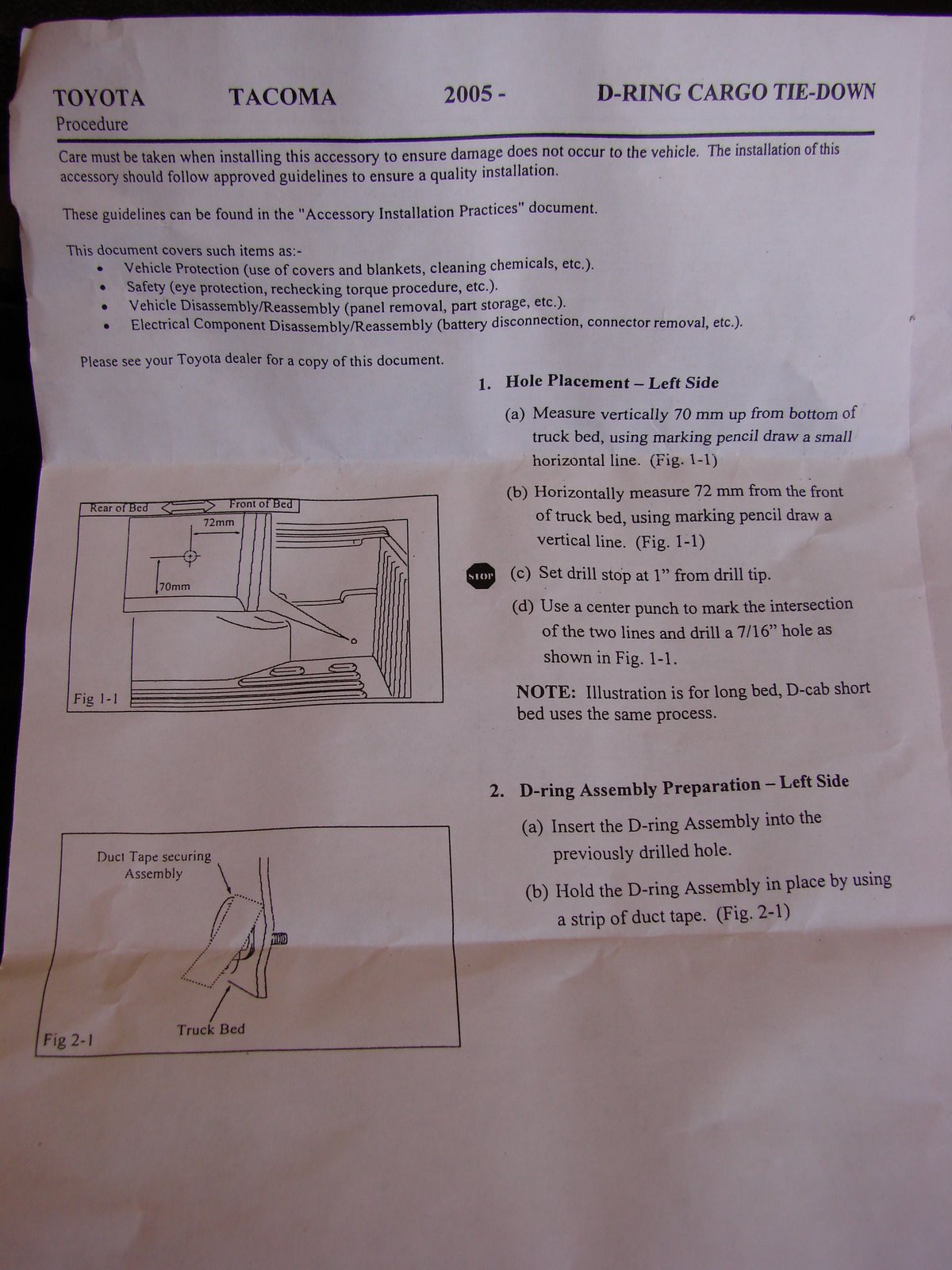

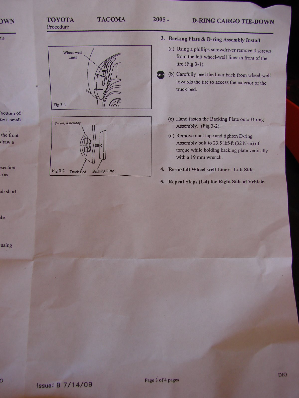

    For those of you that are so concerned about the torque for the factory D-Rings, I looked it up. It's 23.5 lbf-ft (32 N-m)
    Here is a picture for your reference:

    Are those the instructions for the Side mount? Do they come with the factory D-rings? I think I read in one of the early post that the torque is quite a bit larger on the frame bolts, Doc

    Yes, that is the instructions for mounting the OEM rings to the side of the composite bed. I am certain the bed bolts would be torqued more.

    Thanks for the information regarding torque and the PDF, Monrad. Also, thanks for posting pics of the side of bed mounting option for the D-Rings, Coke. Of course, the bed bolts are probably torqued down much tighter, so I'd probably just stick with what they come with from the factory.
