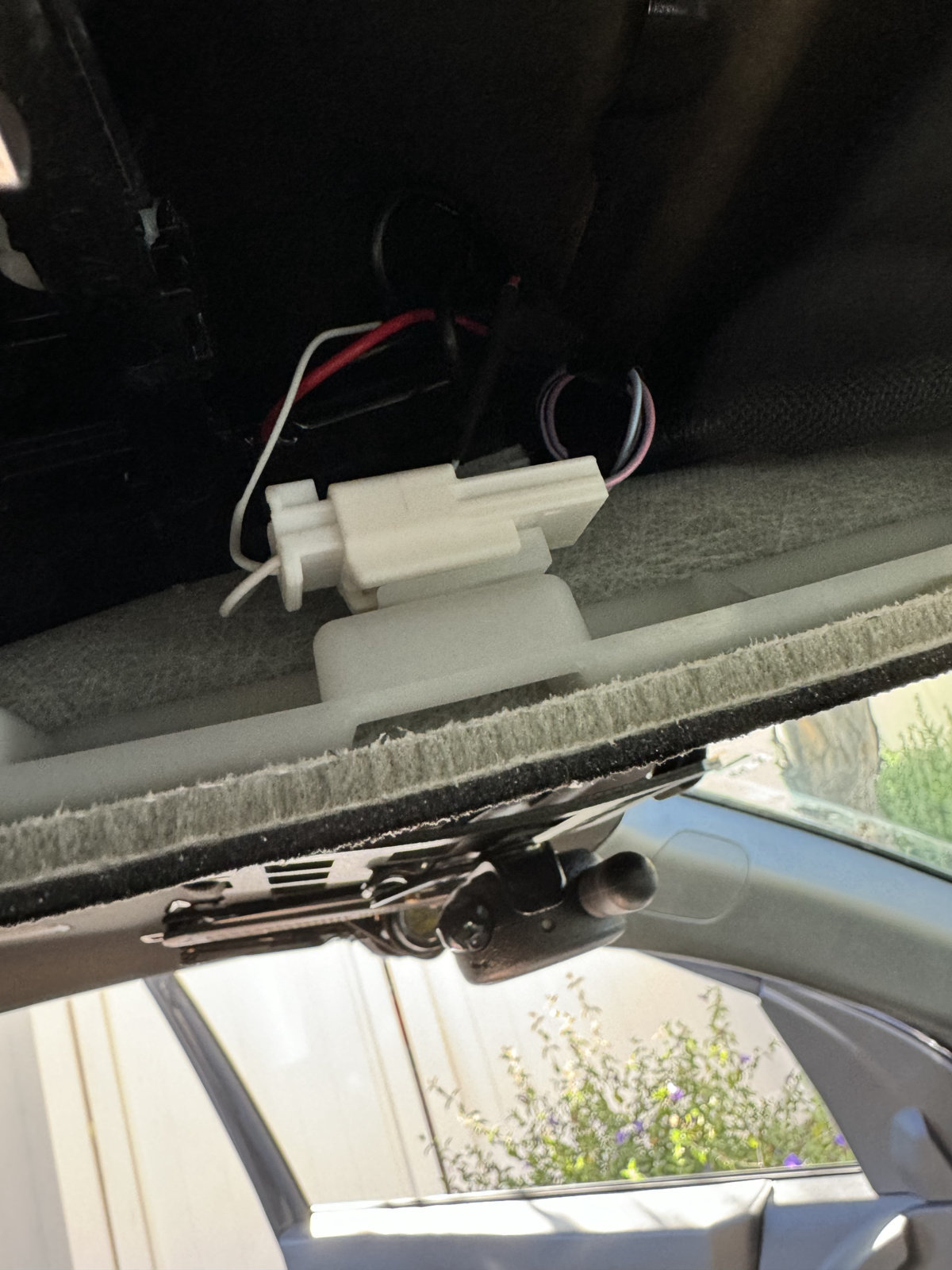

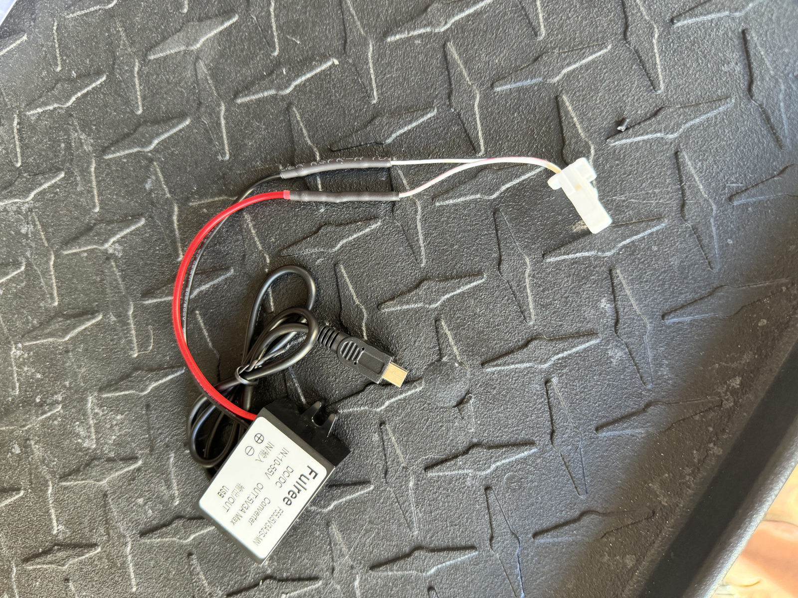

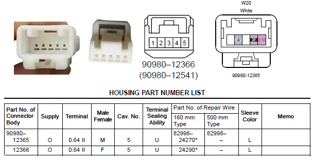

    I know https://dongar.tech/ makes a solution but I wanted to make my own for less because I’m cool like that….
    While I was waiting for my truck to arrive at the dealer, started doing some research. I wanted to find a dash cam hardwire solution. I found the new 4th GEN trucks are pre-wired with a pigtail to connect the OEM dash cam sold as an option for $500.
    I ordered one part from AliExpress and another from Amazon.

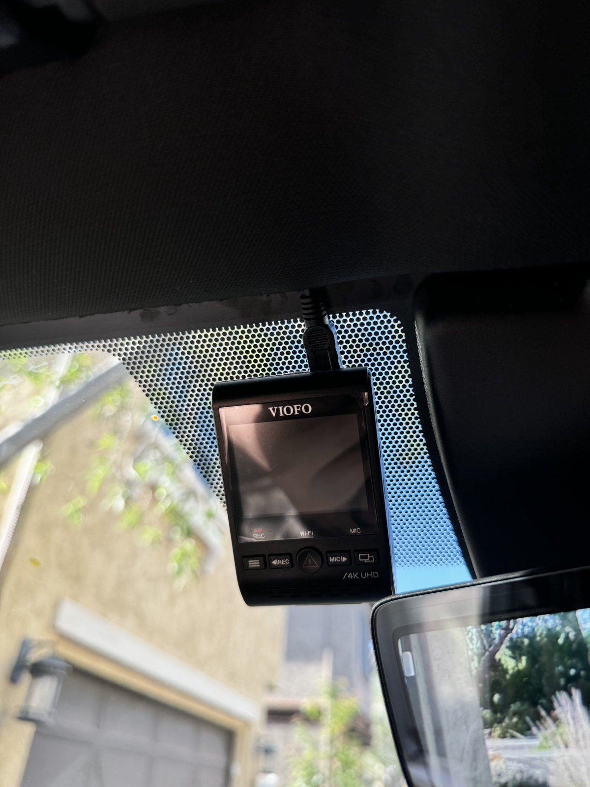

    I successfully hardwired my Viofo dash cam. Came out super clean.

    Would you be so kind as to tell us the name of the 2 parts? Thanks

    I think that connector is IGN on only. Dongar said they are working on a parking mode compatible connector.

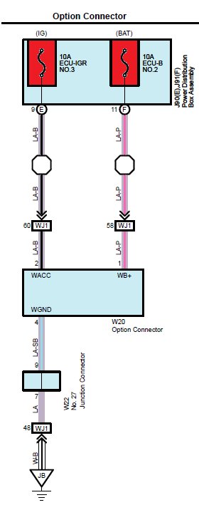

    So is the factory connector 12 volt?

    Depending on how you wire it. There is an option for always on.

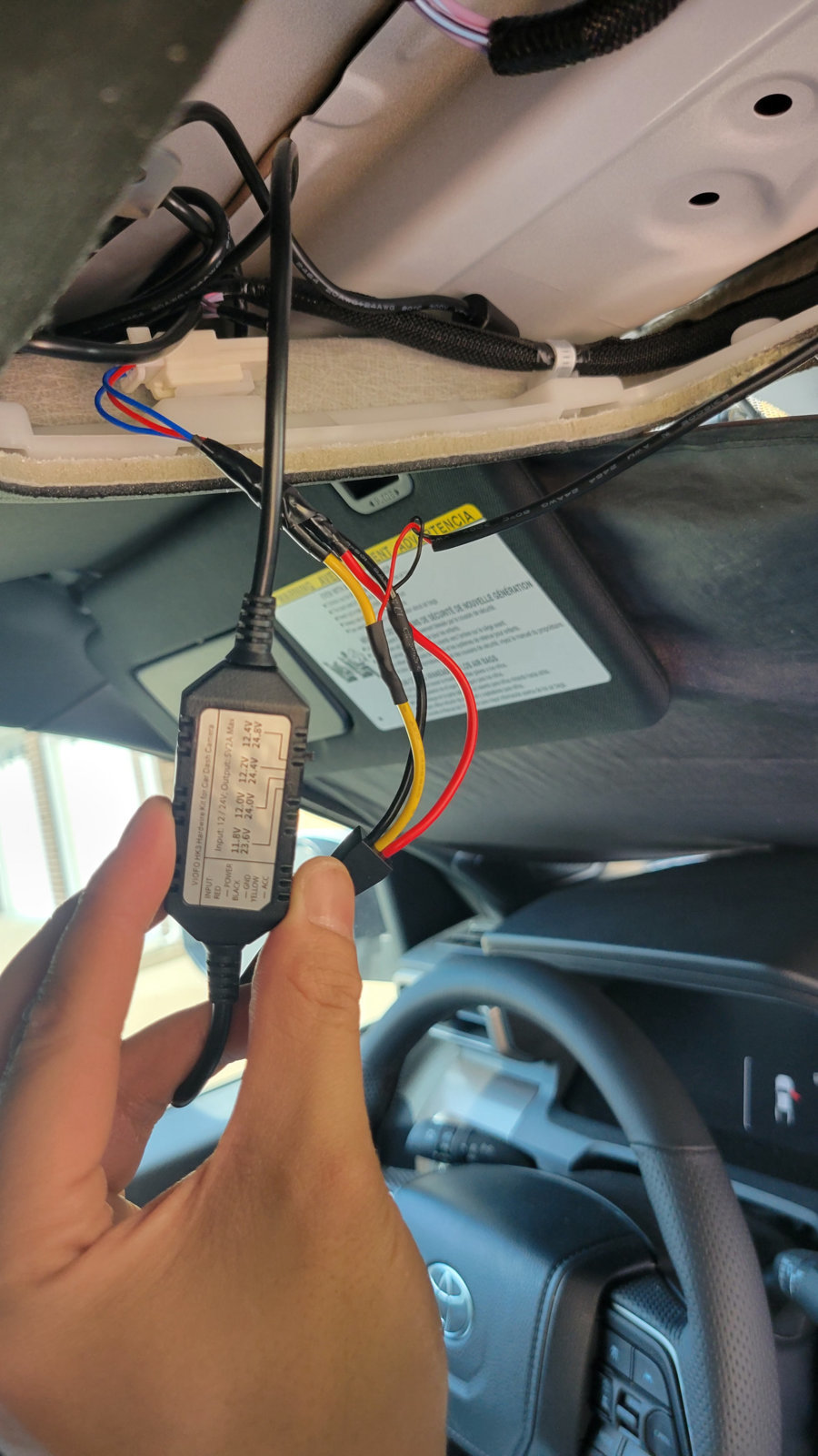

    Since I had the pillars off anyway for MESO puddle lights, I ran a 10a fused switched and continuous power up to behind the mirror. Added a 12V-two USB behind the overhead panel.
    Currently running an Apple MagSafe window mount and Uniden R7 off one leg of the switched power leg. Dash cam to be on one of the USB dongles.

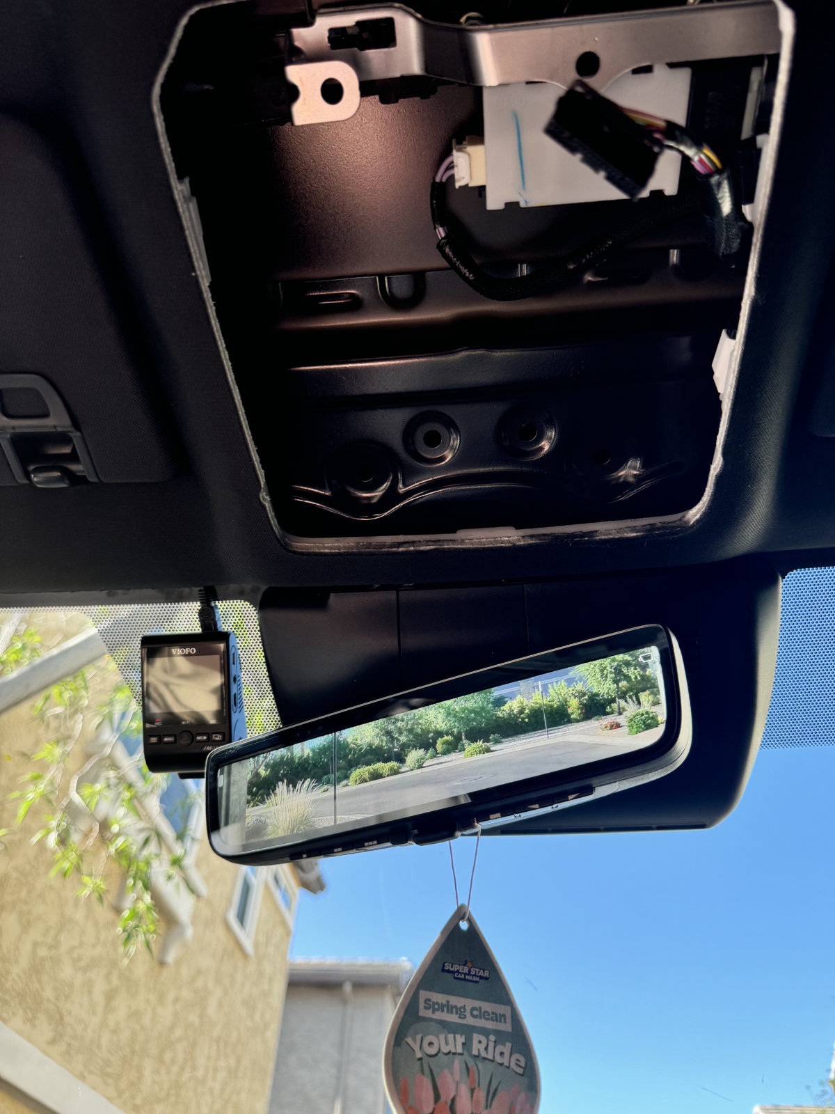

    Grab either the front or back and just pull down. Nothing will break as it’s just held by these red clips. It gets easier the more you do it. Don’t be scared. If a clip breaks they are super cheap.
    Once you get it dropped the connector is on the headliner on the drivers side.
    You can do it!

    Nice! Do you think I can power both my uniden r3 and viofo from this? I don't think the amp draw is very much.
    I would run 12v in straight to dash cam and modify my hardwire kit for viofo to have parking mode. Might be a good idea to put a fuse on the radar detector but this power source should already be fused?

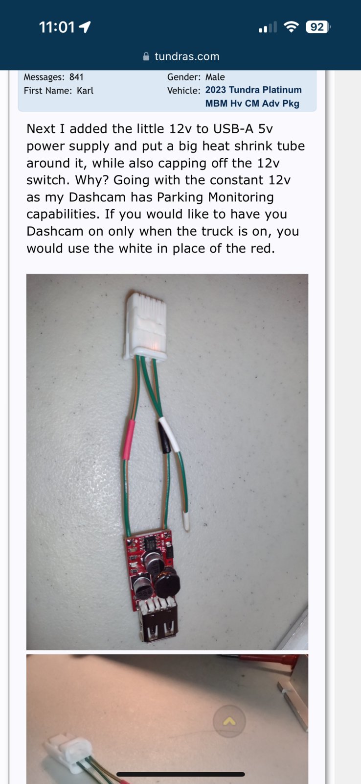

    The one I have has the following in the description on Amazon:
    • PARKING-MODE ENABLED: Dongar PRO is the only parking-mode-enabled plug & play dash cam adapter on the market.
    • VERSATILE POWER MODES: Choose from Ignition, Timed, or Continuous modes to safely power your dash cam even when parked.
    The timed keeps the camera powered for 4 hours after ignition shut off. For continuous, it runs until it senses the low voltage threshold for the vehicle battery and then powers down. Their estimate is around 36 hours of parking time.
    https://www.amazon.com/Dongar-Auto-...543642&sprefix=dongar+pro,aps,121&sr=8-3&th=1

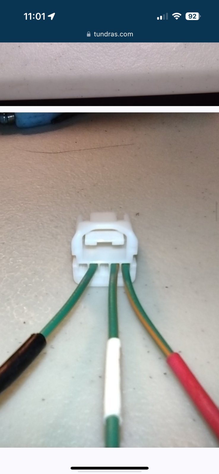

    A later post indicates the connector carries constant 12v, switched 12v, and ground.
    easy enuf to double check with a meter.

    Some dashcams (blackvue, thinkware, others) do their own parking mode with options such as timelapse, motion sensing, shock sensing, etc. and do their own configurable low voltage cutoff. These use three connections - constant 12v, switched 12v, and ground - to sense when the vehicle is turned off and on.
