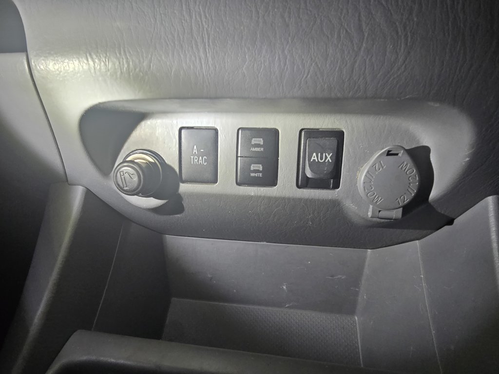

    Hey Gang,
    I installed rough country amber/white ditch lights. The difficulty I am having is where to put the switch... All the tall spaces are filled and the one short space under the ac controls won't fit it. It's a rocker switch- top for amber bottom for white Any ideas? It's taped under the coin tray at this point... Help!

  2. Jul 27, 2024 at 3:25 AM
    caribe makaira
    caribe makaira Well-Known Member
    Feb 13, 2011
    #51121
    11,714
    Caribbean, Puerto Rico
    05 PreRunner TRD Offroad AutoTrans
    Hood Struts, My version Fogs always ON, Map & Overhead Light Mod,
    Sell the switch, buy one that fits in the middle between A-trac & AUX.

    There's room for it, OP just doesn't have OEM switch holes except for the one between a trac and aux

    I've been looking and can't find one. It's a rocker switch- on off on and ground, so 4 pin. amber, off and white. If you know where to get them, I'm in! I appreciate the help!

    OK. ended up with a Cali- Raised small switch. For those who do the same thing in the future- here is the wiring set up on the switch.
    SMALL Switch -> Wire Harness
    GREEN -> Power
    BLACK -> Ground
    YELLOW -> Illumination of Switch
    BLUE -> White Light
    RED -> Amber Light
    On my 2nd gen- the only color option I have is orange- so I didn't bother with the switch illumination - also the black wire on the rough country switch is for the switch illumination only. If you are not going to use it, no need to connect the black as the lights themselves are grounded.

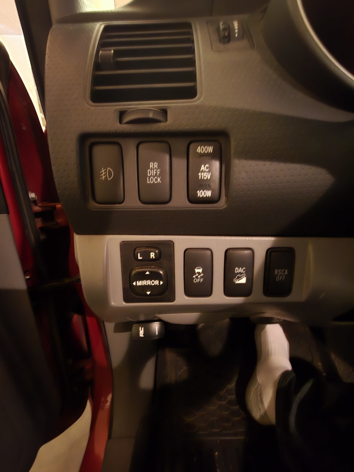

    Above that location there is the A/C connector. You could tap into the dash illumination there.

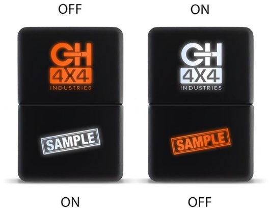

    CH4x4
    Sell the Cali one
