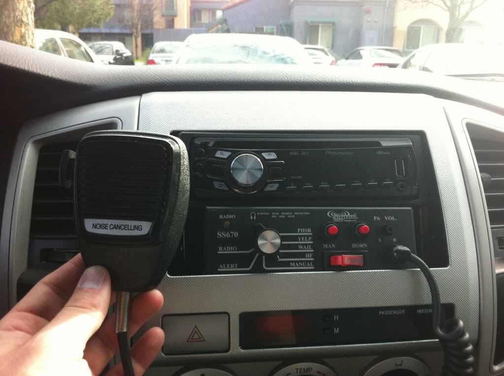

    1. So first I started by taking off the radio cover, don’t be afraid to wedge a butter knife in there and get these off... look on *********.com if you need a walk through.
    2. Disassemble everything until you have removed the radio, hazard/clock thing and the metal brackets.
    3. I took the metal brackets and drilled two holes in them to match where the two holes in the siren amp are. You will have to do some measuring, make the drilled holes even and estimate (using your new radio) about what depth the siren amp should be at. I personally made the siren amp sit a little farther back so it would not hit the dash cover later.
    4. Install your radio on the top of the double din brackets (I’m assuming you can handle and/or look up how to install a new radio in including dealing with the wiring harness), then finagle your siren into the lower part. This is when you will probably need 1.75 or 2 inch bolts to center the siren in between the brackets, and use the locking washers and nuts to secure it all in there.
    4.5. Eventually I would like to bolt on a little piece of metal/ a bracket so I can mount the mic clip next to the siren so there are no holes in the dash.
    5. Now that you have the radio and siren unit complete... lets move on to doing all the wires

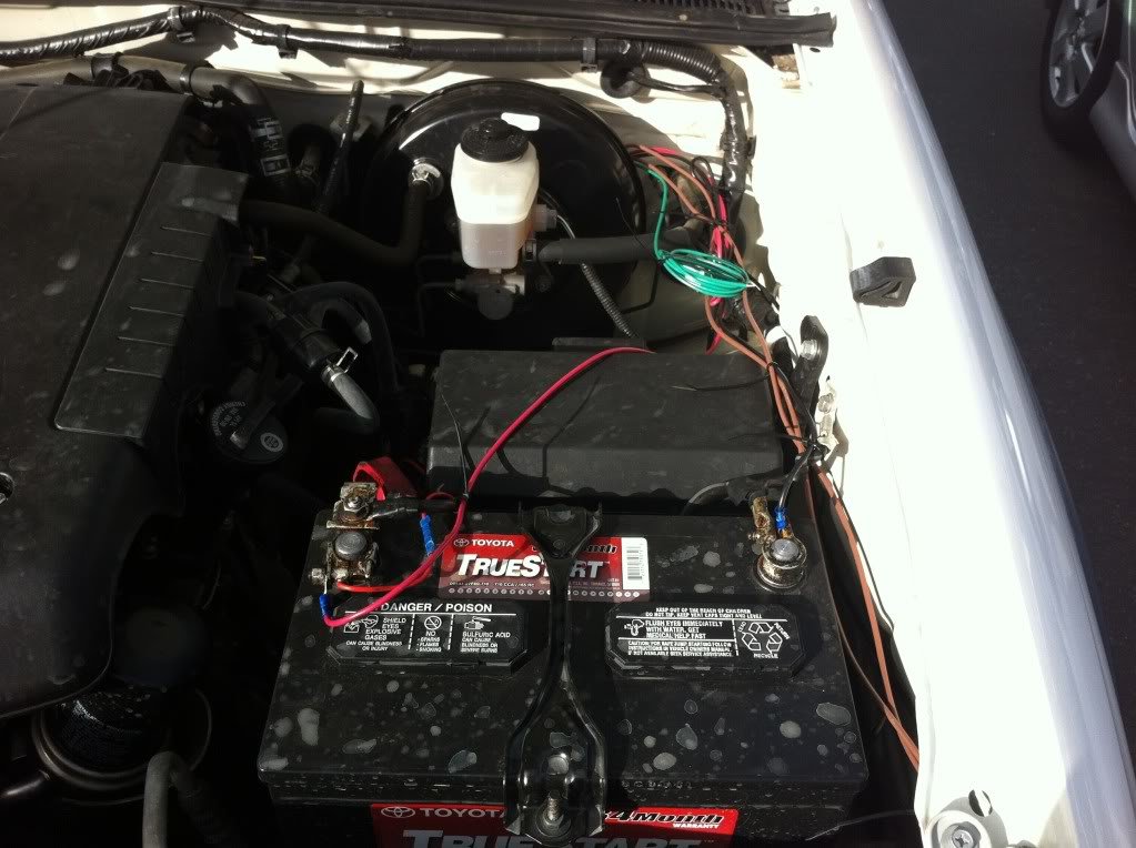

    6. Pop the hood and move towards the firewall. Near the hole that allows the majority of wires through, and move towards 10 o’clock to find a small hole with a rubber plug in it. Remove this plug with your needle nose pliers. Through this hole you will be running:
    A. Positive lead
    B. Negative lead
    C. Speaker positive
    D. Speaker negative
    E. Horn wire
    7. What I found helpful was propping my flashlight so it shined straight into the hole, then I crawled up under the drivers side of the dash and found where I could see the light
    7.5. Hint: It will probably depend on what type of siren amp you are using, but both the positive and negative wires that go to the speaker were the same color (brown for me). I don’t know if it matters much, but I went into the amp’s manual and looked at which one was the positive and which was the negative and marked the positive one towards the end of the wire so I could wire it correctly later… you may want to do the same.
    8. I then started where the siren amp will be mounted (center of dash) and ran the wires down to the driver’s feet. Then I separated the wires that will go through the firewall and attempted (and not very well) to shove the wires one by one up through the hole. I did this till my girlfriend came outside to see what I was doing and asked her to try and she finished in about two minutes. Smaller hands and arms!!!
    9. I then ran the wires to about where they are supposed to go
    Note: I didn’t need extra wire, but you might!!!

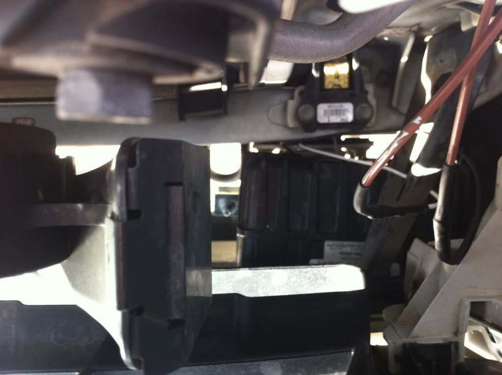

    10. Now, before we wire everything up, lets mount the speaker. I went to Ace hardware... got some 6 or 7 inch bolts that would fit in these two metal brackets (the brackets were near the door hinges and stuff.. and the holes drilled in this bracket perfectly matched the holes already drilled in the speaker. I would measure the dimensions of that beam and then give yourself an extra inch and a half to be on the safe side when it comes to getting your bolts, don’t worry there is plenty of extra room if they are longer than they need to be.
    This picture was taking looking strait down right behind the grill
    11. I bolted the speaker to the middle of one of the metal brackets, leaving the two outermost holes unused. I then put the speaker on top of the driver side bumper support beam, crawled under the truck, and mounted the other bracket on the underside of the beam. Of course using locking washers and nuts. Make sure this is nice and tight so you don’t loose a $150 speaker while driving down the road! Also be sure to tighten it, but not too much as to flex the brackets.
    12. Once your speaker is all set, lets wire it up! I started with connecting the speaker to the amp. Make sure positive goes with positive and negative goes with negative. I first put the shrinking tube down one of the wires, then used wire connectors that clamp down on both wires (like a female-female connection... don’t know their exact name) then slid the shrinking tube over it, and shrank it into place with a lighter to make it water tight.
    13. Then I put some Y connector things on the ends of the positive and negative wires, and hooked those up to the battery bolts. And please don’t shock yourself.
    14. Didn’t wire in the horn yet... didn’t have time to figure out how to wire it into the horn relay… maybe someone could help me out with this?
    15. Then zip tied everything down and got all the wires out of the way.
    16. Before reassembling the dash, I plugged the wire harness into the amp to test it out. Needless to say the entire neighborhood then new about my new toy.
    17. If everything works out, reassemble your dash in reverse order.
    And that’s it!!!!
