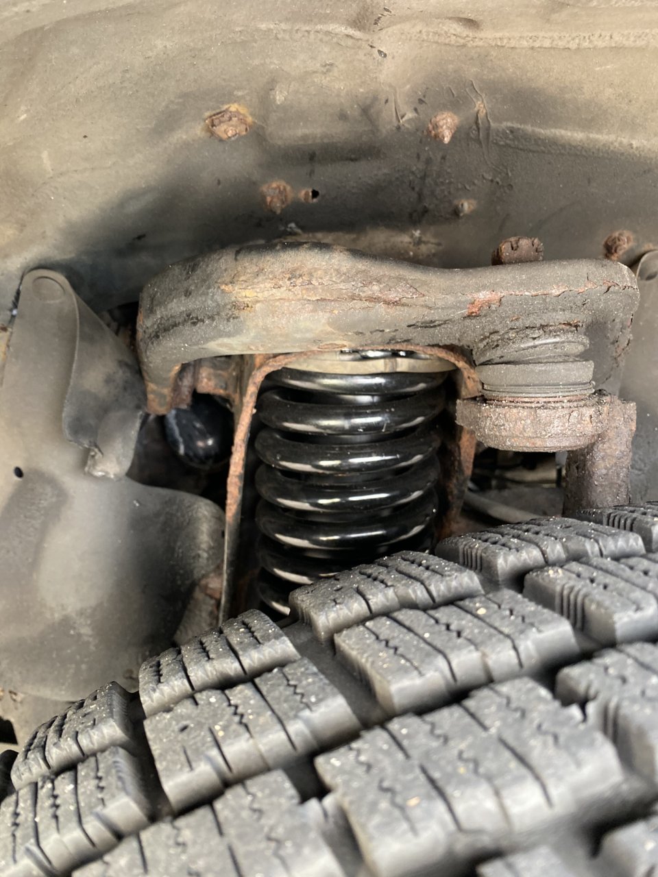

  17. Sep 26, 2020 at 1:37 PM
    #37
    waseemri
    waseemri [OP] Active Member
    Sep 26, 2020
    #341966
    25
    Waseem
    1999 Toyota Tacoma sr5 v6 4wd xtra cab
  18. Sep 26, 2020 at 1:41 PM
    #38
    Kwikvette
    Feb 27, 2019
    #284735
    81,821
    Fresno County
    4 run, 2 don't
    Spring rate I bet is much lower than stock; look how compressed that spring is.
    Non adjustable right?
    How about a picture of the side of the truck, as in, the whole truck.
    tcjacado likes this.
