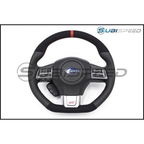

    Ummm, I was kicking around the idea of doing this. Maybe with some alcantara? Do do like the feel of it, even though I'm pretty sure it will wear out quickly.

    Yeah, I read some posts about Alcantara steering wheels. The consensus seems to be that they all wear out with time so I ended staying with leather although I mixed it up with the perforated kind.

    i'm ordering this today. i love it, will match my Pro stitching also and i prefer a thicker wheel as well.
    wonder how the suede holds up compared to the regular leather. do you know how suede does vs. alcantara?

    In my opinion, now that I know how to do it and let’s say the Alcántara just holds in good shape for only two years i would change it for another one and have a Brand new wheel... the good thing about Alcántara is the grip.. if you have sweaty hands, the steering wheel will get shinny really fast (leather)
    I do not like shinny leather steering wheels... so when mine gets a little bit shinny I’ll replace it.. maybe I’ll try Alcántara or suede... AND on top of the old one so the steering wheel gets thicker..

    No, don't think I saw a distinction between Alcantara and suede. Looks like Loncky sells a suede version though.

    Depends on whether the suede is split-leather or rough-out/top-grain (rough on both sides vs. smooth on inside, rough on the outside). Split leather suede is more likely to tear, while rough-out suede is actually more durable than smooth top-grain leather.
    Split leather suede can be very durable if the hide is selected for very uniform thickness and grain.
    I'd bet on quality suede being much more durable than alcantara, which is just a synthetic fabric with a knappy surface. Alcantara surface will almost always wear off and get smooth, and then the fabric backing will begin to break down, and this effect gets much worse on repeated contact with salty or acidic sweat. I think Alcantara makes a great seating surface, but is not suitable for skin contact surfaces.
