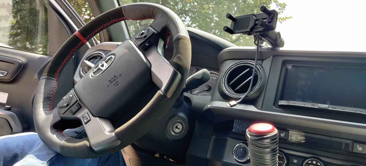

    The tape was garbage and i would try to pull off the one side and it would leave the paper film on it instead of the tape. I work at a firm that has some decent double sided tape in its storage so i borrowed a roll. Super glue is a must for keeping the edges clean around the plastic controls. really glad i decided to use that and it made the edges look really clean and i have confidence they will stay that way.

    I plan on going back and adding stitching to the other loops since i did the every other loop method. Im not finished but it was good enough to show off. Also i ripped off some loops and had to use the holes in the leather. So just a little heads up (ive never sewed anything ) i can be known to gorilla arm things here and there.

    un hook the negative terminal and 5 minutes to take it off. ive had mine off for my fog light stalk install also.
    Stitching it on is a pain on or off the car. my stitching is terrible and i had issues with applying too much force to the thread and popping out the loops but ive re stitched it and its on there to stay.

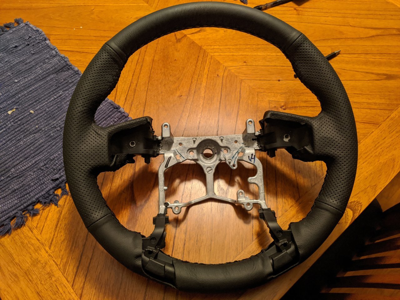

    no good pics but here's one
